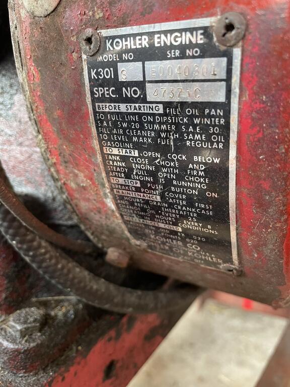

Redav72 231 #1 Posted January 31, 2022 I was inspecting the engine on my Charger 12, planning maintenance once Spring arrives. I was planning to buy new points and a condenser but when I'm looking where they should be based on some YouTube videos they don't appear to be present. Am I missing something? 1 Share this post Link to post Share on other sites
ebinmaine 79,730 #2 Posted January 31, 2022 No points on that one. That's a trigger ignition. 4 Share this post Link to post Share on other sites

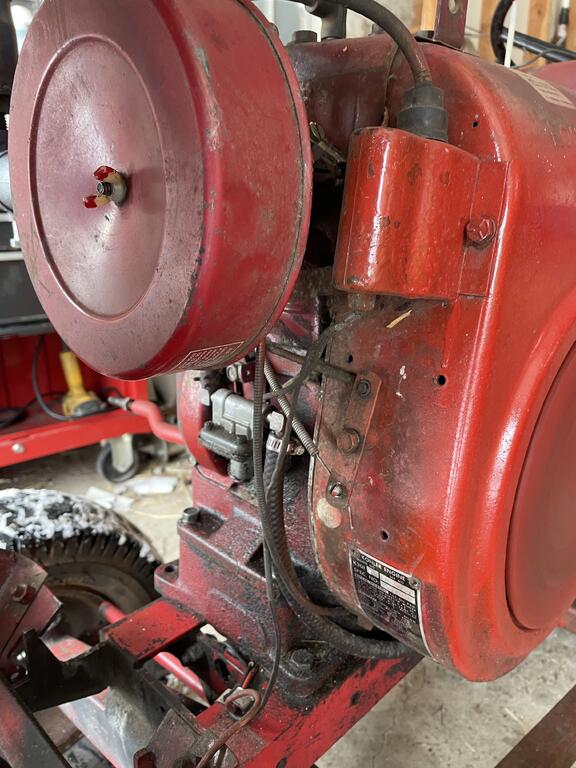

WHX?? 57,466 #4 Posted January 31, 2022 Magneto ignition.... sssoo your spring list might include pulling tins, a flywheel and fins cleaning. Checking magnets and wiring . Overall degreaseing and fastener tightness check. Air filters & fuel lines. 5 1 Share this post Link to post Share on other sites
WHX?? 57,466 #5 Posted January 31, 2022 7 minutes ago, Redav72 said: Are there any maintenance steps that I should take for a trigger ignition? Hence the magnets and wiring checks. Clean charge coils... look for signs of overheating. 1 Share this post Link to post Share on other sites

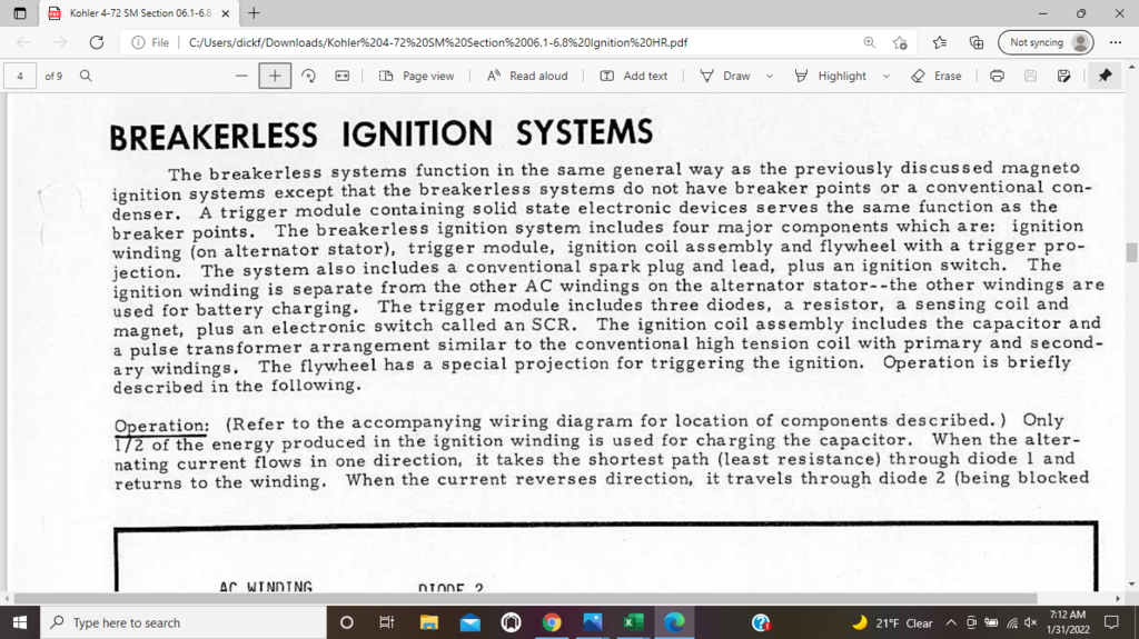

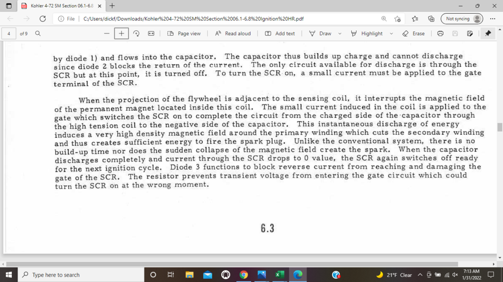

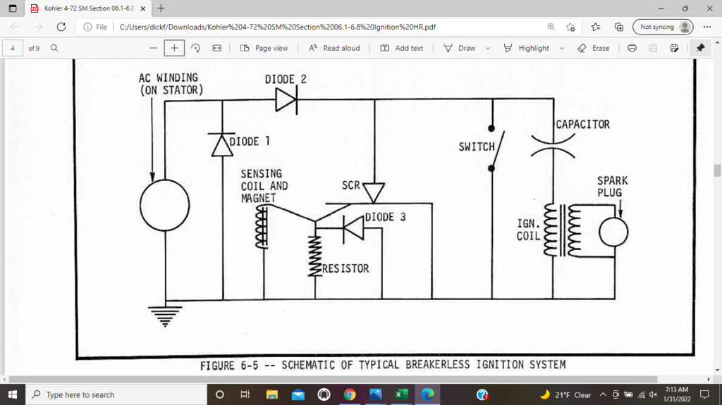

953 nut 67,479 #8 Posted January 31, 2022 As Paul @pfrederi said, the breakerless ignition is wonderful and as long as it is running don't touch it. Here is some information from the Kohler engine service manual. 3 Share this post Link to post Share on other sites

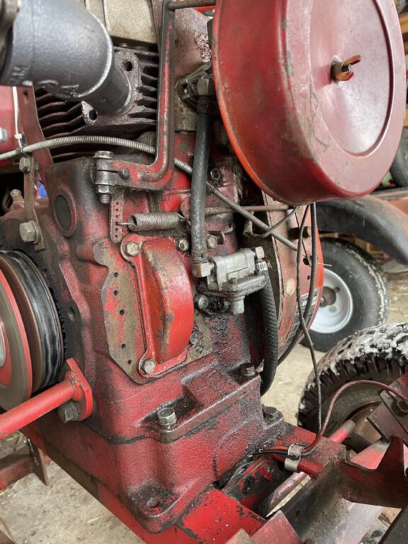

peter lena 9,951 #9 Posted January 31, 2022 @Redav72 not related , yet hiding in plane site , 3 rd photo, vertical fuel line from pump to carb, perfect spot for a fuel check valve , install vertically , so it will hold fuel in place for your carb , faster starts . https://www.amazon.com/EVIL-ENERGY-Return-Petrol-Aluminium/dp/B07ZB42CGT , simple / easy . pete 1 1 Share this post Link to post Share on other sites

Jeff-C175 7,209 #13 Posted January 31, 2022 (edited) 9 minutes ago, kpinnc said: Given how this system works, there has just got to be some type of aftermarket replacement. I only have one of these, but I'd hate to have to convert back to battery ignition if it fails. It's a basic CDI system. "Capacitive Discharge Ignition". I'm gonna ask my friend Mrs. Google about replacements. Yes, there are aftermarket CDI systems. Probably just as much work to convert to one of them as to convert back to battery ignition. And they are exspendsive. Edited January 31, 2022 by Jeff-C175 2 Share this post Link to post Share on other sites

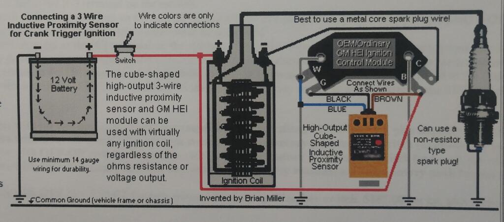

kpinnc 18,756 #22 Posted January 31, 2022 So I went Googling for an aftermarket option. Haven't found it yet. Of course that trail always ends up on Brian Miller's site, and he has come up with an alternative. He sells a "kit" for $251, but another Google search puts the parts at about $80. Only about $30 if you already have a traditional coil to use. Might give it some thought. Maybe some testing whenever I pull the engine to remove the balance gears... Parts for this are cheap. Just not sure how well solid state proximity sensors will handle the heat under the flywheel shroud. Good news is they come in all types and are cheap. Regardless, it appears that there are other options besides converting to conventional battery ignition. 1 2 Share this post Link to post Share on other sites
Jeff-C175 7,209 #23 Posted January 31, 2022 (edited) 21 minutes ago, kpinnc said: some thought Did Brian give any info on where or how to mount the proxos sensor ? Tells how to connect it electrically, but not how to physically mount it. This page has some info on mounting, is this where you were? http://gardentractorpullingtips.com/hei2.htm Edited January 31, 2022 by Jeff-C175 1 Share this post Link to post Share on other sites
