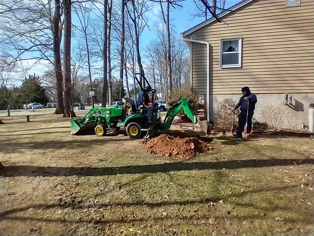

rmaynard 17,585 #1 Posted January 30, 2022 So, what broke? The underground 1" plastic pipe from my well to the house. Here's my story. I ordered heating oil on Friday. The driver called and said he would be here on Monday (tomorrow). The oil filler pipe is on the far side of my house, an area that I rarely see in the winter. But let's back up a minute. We had about 3" of snow a couple of weeks ago. It melted quickly and rolled off the roof and down the spout and across the yard on the side of the house where the oil filler pipe is. I noticed that there was a lot of slush and ice over there when I glanced out the window, but I thought it was as a result of melting snow. Okay, let's now jump ahead to today. I walked to the far side of the house to make sure that nothing was blocking the way to the oil filler, and lo and behold, I have water bubbling up out of the ground. Turns out that I have been pumping water out of my well and onto the yard for about two or three weeks. The pump has apparently been running non-stop. My plumber, who some of you know, as he is a big Wheel Horse collector and shows his stuff at the WHCC show each year, John Frock, is loading up his backhoe and will be here in a couple of days. The ground is frozen so this is not going to be a simple job. Three things that I have learned so far: 1. My well is a good producer; 2. The pump is strong: 3. I'm going to be a bit poorer for the experience. 1 13 Share this post Link to post Share on other sites

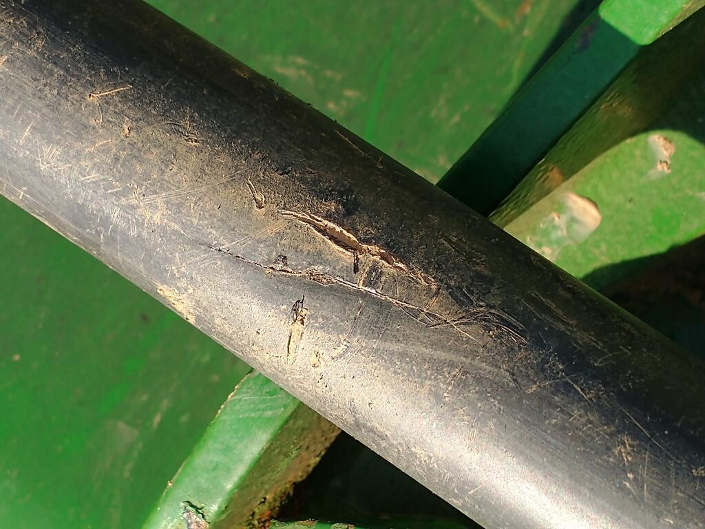

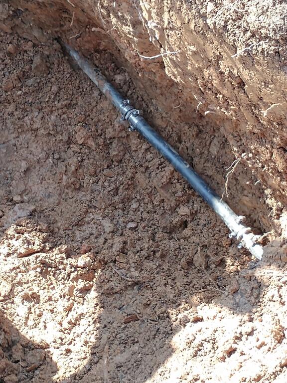

rmaynard 17,585 #8 Posted February 8, 2022 (edited) The rest of the story. Unfortunately, my plumber was over booked (I should have been a plumber) and could not fit me into his schedule in a reasonable time, so I contacted another. He was here at 11:45 a.m. and finished by 12:50 p.m. He dug down at the spot that I had pinpointed... and found this. Cut it out, and spliced in a new piece Job is done, no leaks, water pressure is holding, and now I can take a shower longer than 1 minute. Woohoo Edited February 8, 2022 by rmaynard 9 Share this post Link to post Share on other sites
