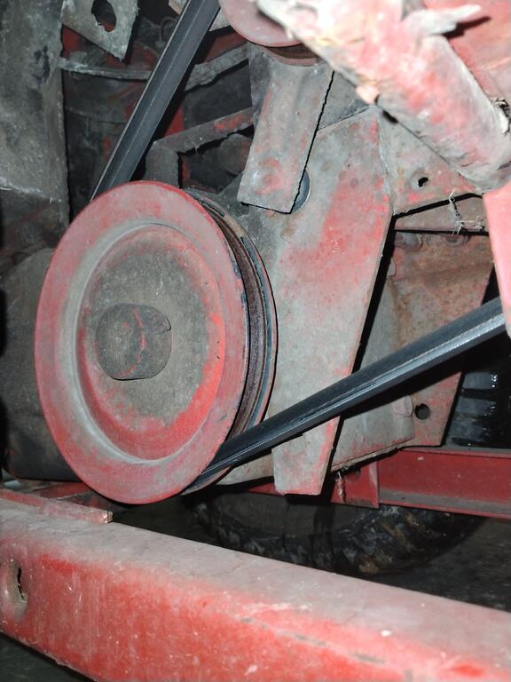

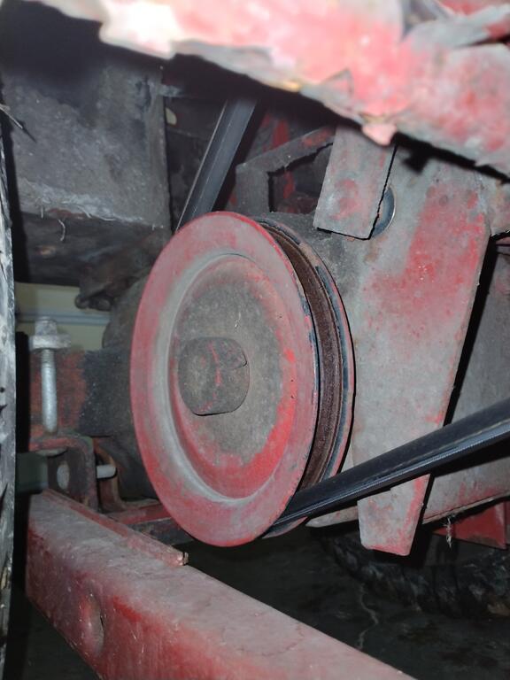

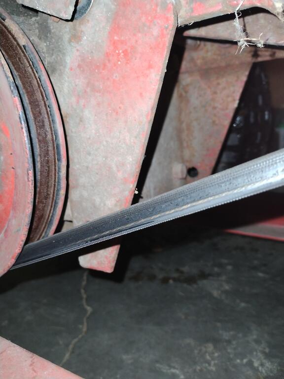

TJ5208 1,841 #8 Posted January 30, 2022 Here's some pictures of the belt it seems like the belt is nice and tight Share this post Link to post Share on other sites
squonk 44,870 #9 Posted January 30, 2022 (edited) Belt looks worn on the sides. Sunk deep into the pulley. Get a new Kevlar one. Toro 114895 Napa 5L830W Tsc 5L830 Edited January 30, 2022 by squonk 1 1 Share this post Link to post Share on other sites
Handy Don 15,217 #10 Posted January 31, 2022 , @TJ Salyers Definitely as @squonk and @peter lena called it. A dead giveaway is those rusty walls inside the pulley--not kept polished by the belt rubbing on it--tells you the the belt is riding on the bottom of the pulley. Belts transfer power to pulleys through wedging against the sides, not the bottom. Plus you'll want to get rid of the rust in that pulley--it'll eat your new belt. You can "shoe shine" very very fine emory paper or scotchbrite abrasive pad pressed into the groove using the worn out belt. 1 1 Share this post Link to post Share on other sites
