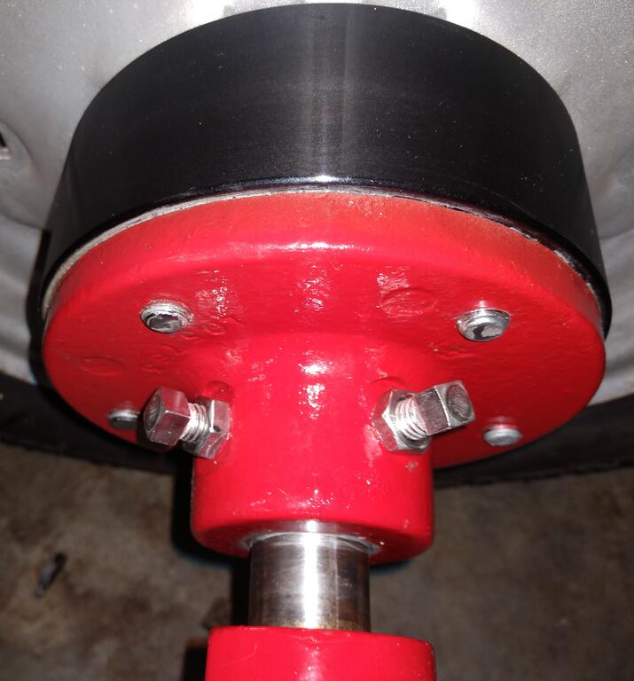

kpinnc 18,916 #51 Posted January 31, 2022 28 minutes ago, Rob J. said: So I’m thinking one could use a set of day 2” wheel spacers if needed? Been done many times. But you will need some different lugs. You won't be able to reach WH lugs in spacers. 1 2 Share this post Link to post Share on other sites
ebinmaine 80,462 #52 Posted January 31, 2022 @Rob J. Using 5 x 4.5 wheel adapters is quite common. I have 2 Horses myself that I've done the conversion on. @kpinnc gives excellent reference pictures above. I'll send a PM with all the parts and pricing you'll need. 2 1 Share this post Link to post Share on other sites

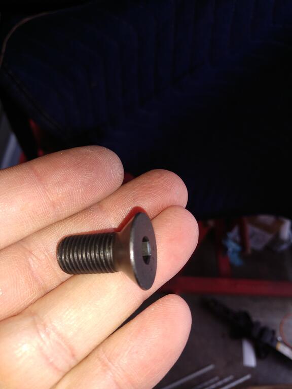

kpinnc 18,916 #53 Posted January 31, 2022 (edited) 2 hours ago, ebinmaine said: @kpinnc gives excellent reference pictures above. I found out the hard way about those lugs. Then found plenty of them at auto parts stores. They sell them in sets of four... There are also bolts like these, that work just fine. My concern with them is removing them later. Edited January 31, 2022 by kpinnc 3 Share this post Link to post Share on other sites
