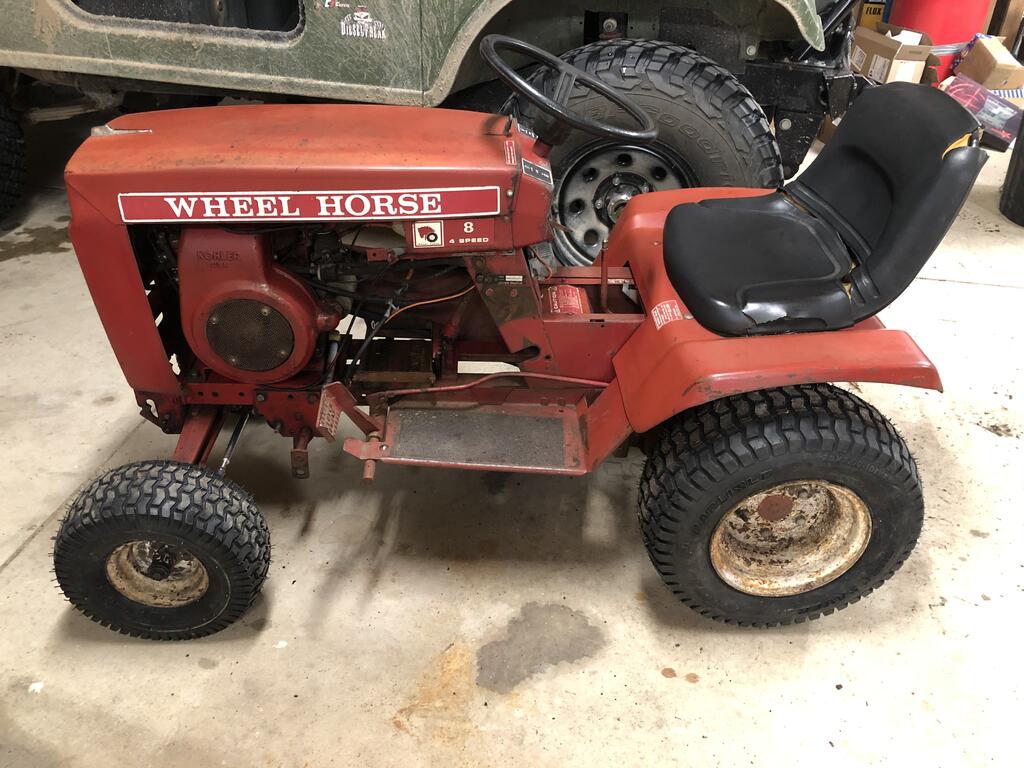

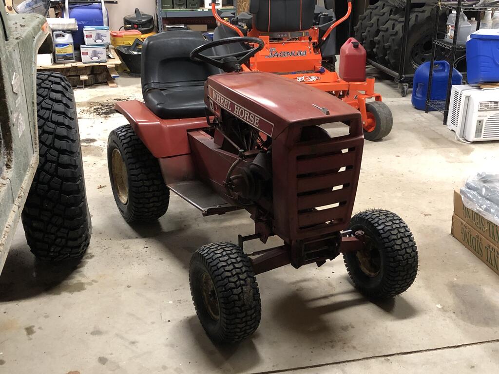

Rob J. 1,945 #1 Posted January 30, 2022 Is there different wheel options for this model? Just started the hobby and haven’t found a lot of info on this particular model. Currently in the process of rescuing this one. Going through it and getting it mechanically sound again was my original goal but I might be heading down the rabbit hole here. Any info or help is much appreciated, thanks. 4 Share this post Link to post Share on other sites
TJ5208 1,841 #2 Posted January 30, 2022 (edited) any 12 inch rims will fit the back and every 8 inch rim would fit the front of it Edited January 30, 2022 by TJ Salyers 1 1 Share this post Link to post Share on other sites
TJ5208 1,841 #3 Posted January 30, 2022 (edited) You would have to get all of the tires at the same time for the front and back to level out Edited January 30, 2022 by TJ Salyers 2 Share this post Link to post Share on other sites

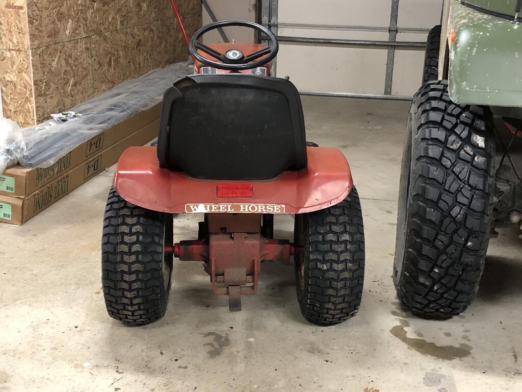

kpinnc 19,036 #4 Posted January 30, 2022 The rear axles on that model are unusually long due to the wheel size and type that came on it. Regular wheels will be set out by about 2 inches either side with standard 12 inch rear wheels. Only know because I picked one up just for the longer axles... 4 Share this post Link to post Share on other sites
8ntruck 9,368 #5 Posted January 30, 2022 (edited) to the forum. Glad to see another Michigander here. I think that there were no optional wheels from the factory. As @TJ Salyers points out, other wheels will fit. It is possible that some were installed by the dealer, or a previous owner. Nice looking tractor. Looks like the rock shaft (accessory lift mechanism) is missing. Wander through the manuals section of the forum. You should be able to find an owner's manual and a parts list and diagram there. Nice looking CJ 7 in the background, too. Edited January 30, 2022 by 8ntruck 2 1 Share this post Link to post Share on other sites

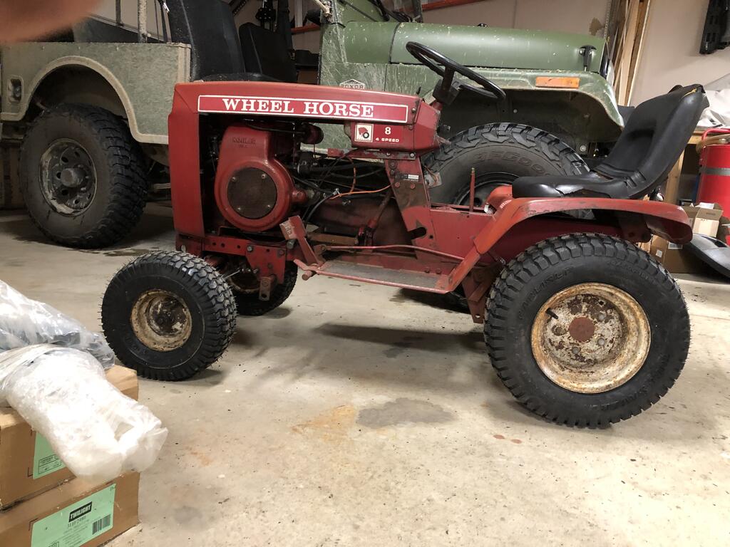

Rob J. 1,945 #6 Posted January 30, 2022 I made a spacer bracket in place of the under carriage hardware so the clutch assembly remained. Just cleaning it up a little. Won’t use those parts but kept just in case. 2 Share this post Link to post Share on other sites

ebinmaine 81,047 #16 Posted January 30, 2022 7 hours ago, Rob J. said: different wheel options for this model? Just started the hobby and haven’t found a lot of info on this particular model The 1973 8 HP 4 speed is basically identical to the 1974 and 1975 B80. I'm not sure of the frame length in '73. '74 and '75 it was a "mid-length" frame. The Kohler 8 HP engine is without doubt one of their best overall. Excellent torque output for the size. On the wheels ... What exactly do want to change? Width? Back spacing? Type? Looking to swap to larger tires? 2 1 Share this post Link to post Share on other sites
rjg854 13,408 #18 Posted January 30, 2022 That is a good tractor to start with, and the 8hp Kohler is a great little engine. 1 1 Share this post Link to post Share on other sites
Racinbob 13,250 #19 Posted January 30, 2022 The 1972 version of that model was a Commando 800. Here's one I restored for my grandson a few tears ago. I swapped the 10" rear wheels for a set of 22.750-12's from a 76 B-80. I left the 6" fronts as is. The height difference was insignificant and had no effect running a 36" RD deck. 2 2 Share this post Link to post Share on other sites

Racinbob 13,250 #22 Posted January 30, 2022 6 minutes ago, Rob J. said: Looking to get it up higher just a bit. Won’t be used for mowing, mostly just a yard tractor. You can see other modifications I did. The 12" rears will raise you up a bit. Leg clearance was improved with the addition of the flip forward seat mount. 3 Share this post Link to post Share on other sites

ebinmaine 81,047 #24 Posted January 30, 2022 11 minutes ago, Rob J. said: Looking to get it up higher just a bit. Won’t be used for mowing, mostly just a yard tractor. On the rears you could swap out for a set of wheels and tires from a later C series. Those would be 23 x 8.5 x 12. The fronts you actually have more options because you have more clearance. No fender in the way. 8" wheels with tires as tall as 18" or more. Parts availability is excellent by mail order. For wheels and tires both front and rear you could call Lincoln at A to Z Tractor in Pennsylvania. His shipping rates would be competitive. 1 1 Share this post Link to post Share on other sites
Rob J. 1,945 #25 Posted January 30, 2022 6 minutes ago, Racinbob said: You can see other modifications I did. The 12" rears will raise you up a bit. Leg clearance was improved with the addition of the flip forward seat mount. The seat was the next thing I was getting to. Not even sure it’s correct. It mounts directly to the rear fenders. Almost seems like it’s missing a mount in between the seat and fenders? 1 Share this post Link to post Share on other sites
