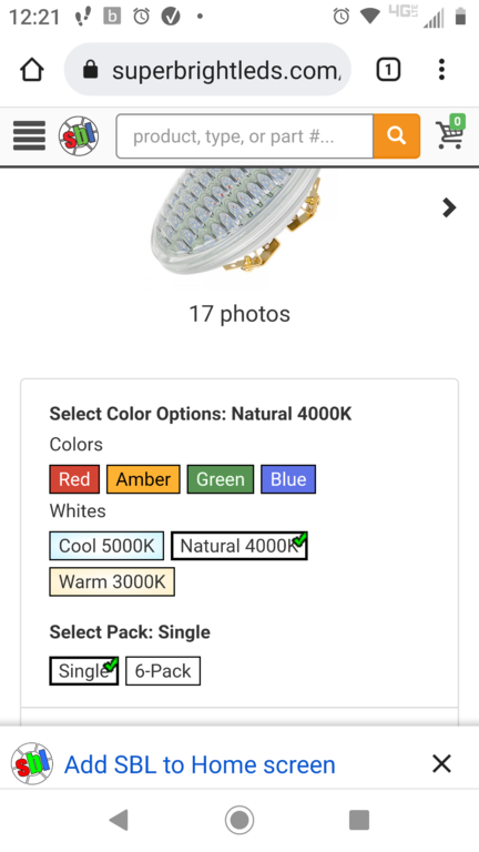

kpinnc 18,976 #5 Posted January 29, 2022 Just search PAR 36 Bulbs on Amazon or at Superbrightleds.com. 1 Share this post Link to post Share on other sites

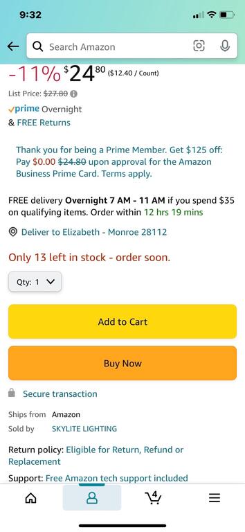

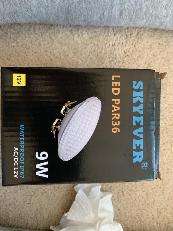

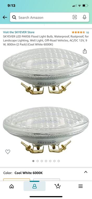

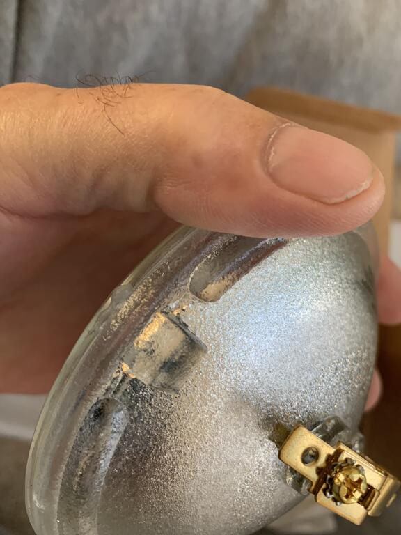

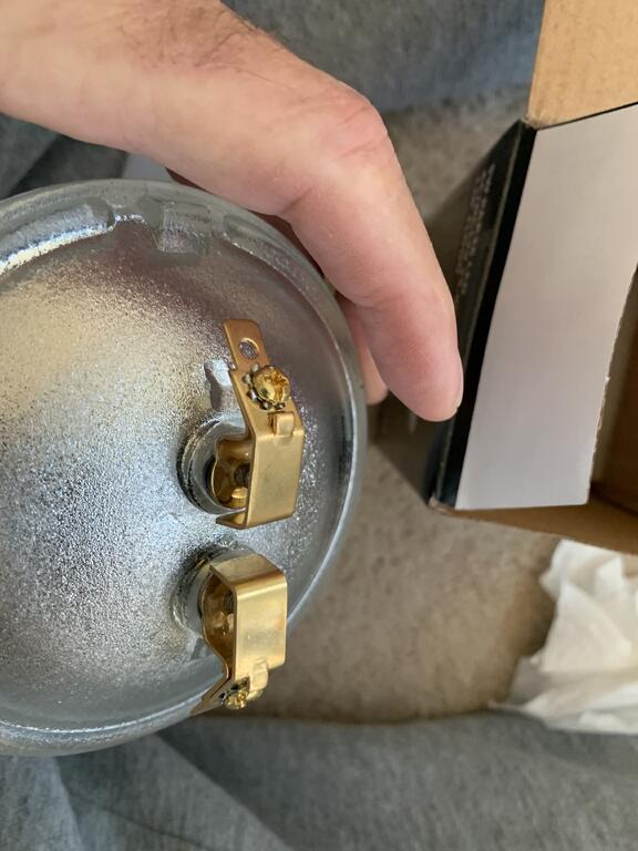

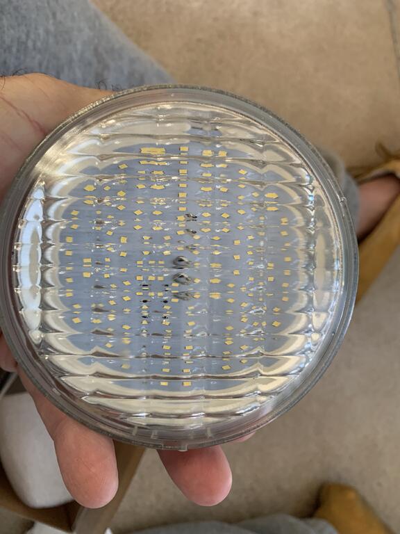

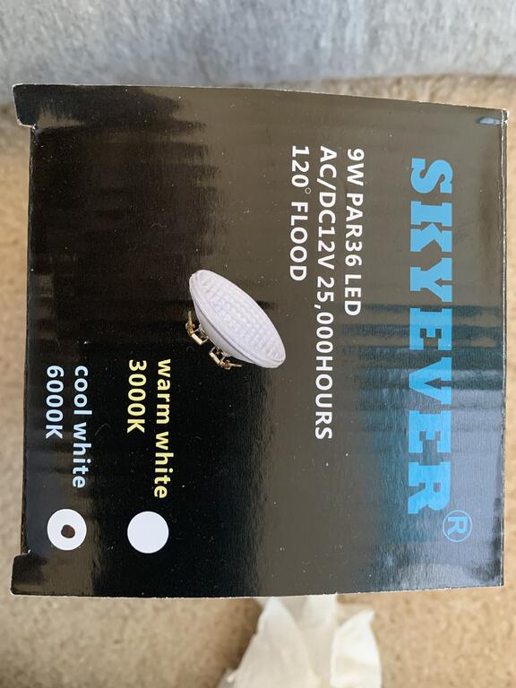

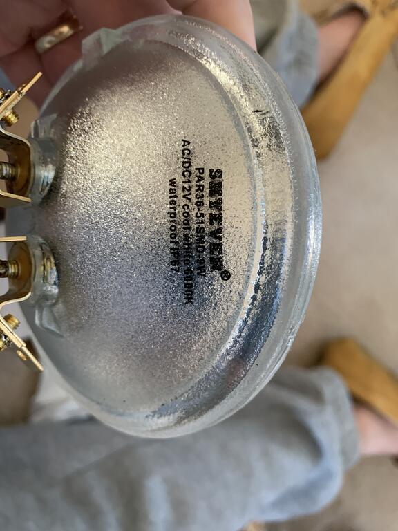

Horse Newbie 7,405 #6 Posted January 29, 2022 (edited) @TJ Salyers Here are some I just ordered for my 1994 520H… Technically I have not installed or tried mine yet. I ordered 6000K which @kpinnc on here said may lean a little towards the blue side of the light spectrum, and @kpinnc said (I think) that he ordered 5000K which would be leaning more toward whiter light. You probably won’t notice too much of a difference. Like @kpinnc said just search PAR 36 LED bulbs on Amazon. I believe I got the same as @kpinnc got, and I trust him wholeheartedly ( check out his tractors and you’ll see why). Three reasons I like the ones I got… 1. They are glass all the way around. 2. They have the little protrusion that keeps them from rotating in the light bezel. 3. When you look at the front they look more original than some LED’s you see. ( On some you can see the Light Emitting Diodes on the inside of the bulb ) I don’t have a link, but mine are Skyever brand. The seller on Amazon was Skylite Lighting. Two bulbs were like $22 or $24 dollars… can’t remember. The last photo is a screenshot of the bulbs on Amazon. Edited January 29, 2022 by Horse Newbie 1 2 Share this post Link to post Share on other sites

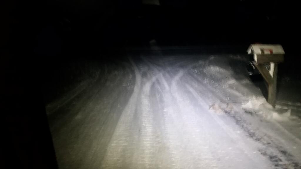

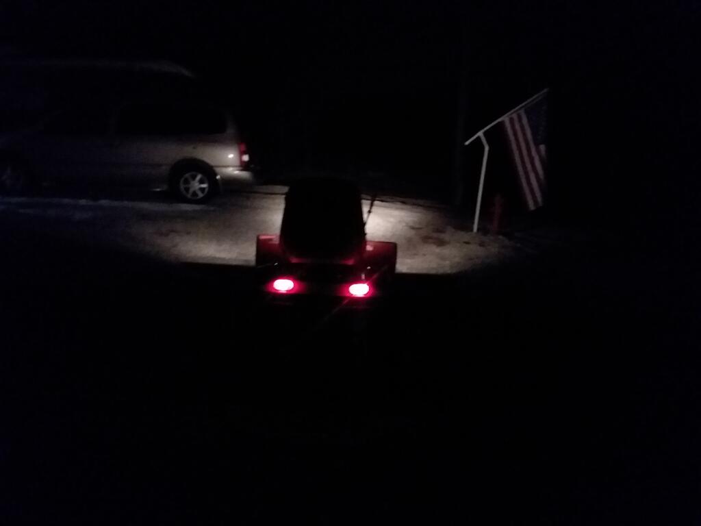

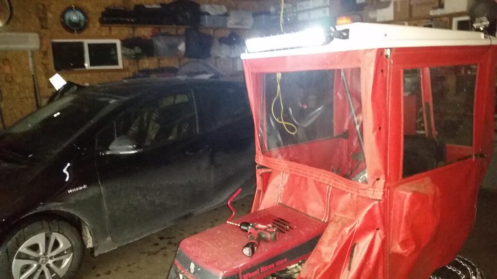

WHX?? 58,214 #9 Posted January 29, 2022 (edited) Regarding the color I went with 3k as it was said here that the 6k might offer too much glare off of snow. My blaster lights are 6 k and glare is not real terrible. Edited January 29, 2022 by WHX?? 4 1 Share this post Link to post Share on other sites
kpinnc 18,976 #10 Posted January 29, 2022 2 hours ago, Horse Newbie said: ordered 6000K which @kpinnc on here said may lean a little towards the blue side of the light spectrum, and @kpinnc said (I think) that he ordered 5000K which would be leaning more toward whiter light. The reason I mentioned superbrightleds is because you can choose the color temp in most cases, and they ship pretty quick. They aren't quite as cheap as Amazon, but you typically know exactly what you're going to get. 4 Share this post Link to post Share on other sites
Horse Newbie 7,405 #11 Posted January 29, 2022 1 hour ago, WHX?? said: Regarding the color I went with 3k as it was said here that the 6k mine offer too much glare off of snow. My blaster lights are 6 k and glare is not real terrible. @WHX??… what ?… do you have to take that rig inside so the sun can come up ? 4 Share this post Link to post Share on other sites
Snoopy11 5,731 #12 Posted January 29, 2022 1 minute ago, Horse Newbie said: @WHX??… what ?… do you have to take that rig inside so the sun can come up ? Darn LEDs are BRIGHT!!! I have a set of Nilight lights on one of my tractors. I can see every booger on pedestrians' faces... Don 1 3 Share this post Link to post Share on other sites
