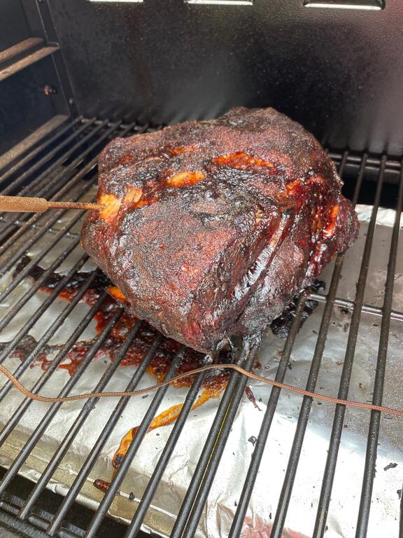

Sodaking27 1,358 #40 Posted January 29, 2022 (edited) 4 hours ago, WHX?? said: Soda do you run the blankets on yours? I have to on my Green Mountain or she won't get out of her own way. Bag of pellets just to get her up to 100. I might have auger gear motor issues too tho I have blanket for one of them. I haven’t used it in years after upgrading the stock controller to a PID type controller. Let me show you one of my butts. 🤭 I let this one go unwrapped at 225 until IT of 203 them wrapped and placed in a cooler for a couple hours. Edited January 29, 2022 by Sodaking27 3 Share this post Link to post Share on other sites

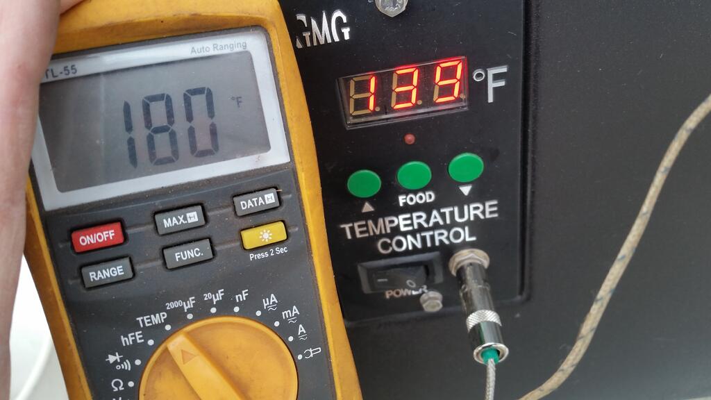

WHX?? 58,217 #43 Posted January 30, 2022 (edited) On 1/28/2022 at 4:25 PM, Achto said: Or thermometer issue. I think she runs hotter that it says. Ok now is it the sensor or the board? this was about as close as it came sometimes as much as 60 deg off. A call to Green Mountain Grills is in order. A new control board is not an option as well on my way Traeger for the cost. No wonder my ribs come out way overdone. It got up to 150 once and throttled back but then dropped back down to 140 and fans have not shut off since. DMM holds at 180-190. Gotta be in the control. Food temp probe goes wacko every now and often too. Got one of Kev's pork tenders in just for trouble shooting. Edited January 30, 2022 by WHX?? 2 Share this post Link to post Share on other sites
Achto 32,794 #44 Posted January 30, 2022 (edited) 2 hours ago, WHX?? said: A call to Green Mountain Grills is in order That's a huge difference. Hope GMG can help you pin point which part is bad. Edited January 30, 2022 by Achto Share this post Link to post Share on other sites

Pullstart 71,296 #46 Posted January 30, 2022 You should be able to test the thermistor Uncle Jim. I believe that 70 degrees is around 13,000 ohms. If it’s off, it is the board. FYI… as far as water thermistors go, I’ve never seen a bad one. Share this post Link to post Share on other sites
WHX?? 58,217 #47 Posted January 31, 2022 28 minutes ago, Achto said: That's a huge difference. Hope GMG can help you pin point which part is bad. We'll find out. Maybe they can provide me with a temp/ohm chart, I have never had a thermistor go bad either. Odd thing is it all started when I had to replace the auger motor but even before that it drove like a lumber wagon. Even odder thing is my nephew has got a older D Boone at the cabin and it rocks in all weather. He ain't exactly known for taken care of his equipment either. Goin the other way on the temp scale you score on a freezer Dan? Share this post Link to post Share on other sites
