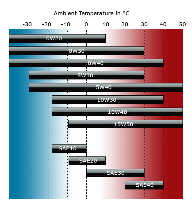

Pullstart 71,296 #15 Posted January 27, 2022 20 minutes ago, Hardy said: Pfreferi vous voulez dire de la 0w40? Pfreferi you mean 0w40? 0w40 n'est pas exactement le même que SAE40 0w40 is not exactly the same as SAE40 1 2 Share this post Link to post Share on other sites
