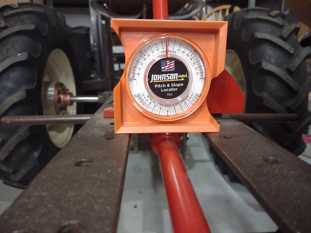

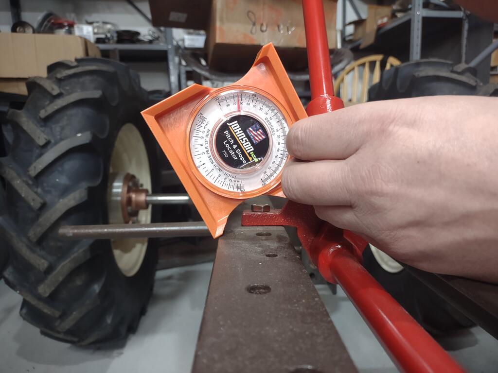

ebinmaine 77,548 #57 Posted January 30, 2022 (edited) Here's what I was thinking: Looks like it's going about 60⁰ or so, 1/6 of a turn. So I should end up with less than 2 steering wheel turns, lock-to-lock. Edit to Fix silliness!! Edited January 30, 2022 by ebinmaine Share this post Link to post Share on other sites
ebinmaine 77,548 #58 Posted January 30, 2022 5 minutes ago, sjoemie himself said: Another thing you could maybe use is a steering rack out of a small car. Most racks have the option of tightening up the play that may develop over time. I like the rack n pinion gear idea but I've already got the forward end of the steering system done. Share this post Link to post Share on other sites
sjoemie himself 3,106 #59 Posted January 30, 2022 4 minutes ago, ebinmaine said: I like the rack n pinion gear idea but I've already got the forward end of the steering system done Check! On the angels you've got me stumped.. 60° is 1/6th of a turn in my book? 360/60 right? 1 Share this post Link to post Share on other sites
ebinmaine 77,548 #60 Posted January 30, 2022 1 hour ago, sjoemie himself said: Check! On the angels you've got me stumped.. 60° is 1/6th of a turn in my book? 360/60 right? And THAT'S why I post these things. I fixed that too! 2 Share this post Link to post Share on other sites
Snoopy11 5,731 #61 Posted January 30, 2022 (edited) 1 hour ago, sjoemie himself said: 60° is 1/6th of a turn in my book? 360/60 right? I am getting dizzy... Don Edited January 30, 2022 by Snoopy11 Share this post Link to post Share on other sites

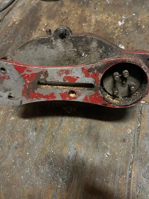

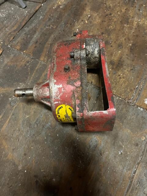

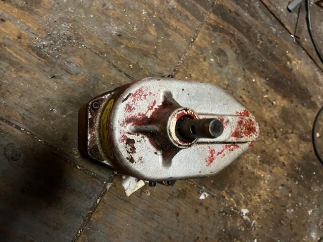

wallfish 19,392 #65 Posted February 13, 2022 42 minutes ago, ebinmaine said: The gears or box I use would need to be substantially more heavy duty. Which the trade off may be the size. There was talk of an auger gearbox if I recall correctly. Here's an old chainsaw attachment auger box and it's 12:1. Have had this thing for a while and was planning to use it for a future project steering set up too just as you are looking to do (but that's just another one in the Q which probably won't ever happen either). I bought it for the purpose it's designed for but it's a different version that will spin backwards on the XL12 chainsaws so it doesn't work for the collection of XL12 stuff. Of coarse direction makes no difference for a steering application so let me know if you're interested. The drive shaft is 1/2" and that chainsaw pin to gear drive piece looks to be removable from the input shaft and the output shaft is 3/4". The offset shafts and larger size will create some engineering design challenges to fit compared to an inline box but that figuring it out stuff is half the fun of building. 2 Share this post Link to post Share on other sites

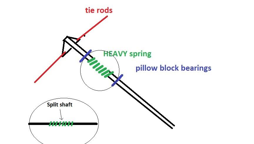

wallfish 19,392 #66 Posted February 13, 2022 Just knda think'n out loud again for something to maybe set off a light bulb somewhere. But what about absorbing the wheel shock forces since the box you have might work for everything else? Like a heavy spring inline with the steering shaft. Pillow block bearings will hold the 2 shafts inline. The lighter steering forces to turn the wheels would still be achieved and the shock forces should be very temporary short duration so it may not effect the steering control so much but. Basically the twisting of the spring will absorb the harder impact shock. There would probably be some trial error for the right size spring, attaching it to the shafts and testing. Attaching it would need to be very solid or it could end up like riding in a shopping cart. Doesn't work, the shaft can be welded back together 1 Share this post Link to post Share on other sites
Oldskool 6,672 #67 Posted February 13, 2022 3 hours ago, wallfish said: Which the trade off may be the size. There was talk of an auger gearbox if I recall correctly. Here's an old chainsaw attachment auger box and it's 12:1. Have had this thing for a while and was planning to use it for a future project steering set up too just as you are looking to do (but that's just another one in the Q which probably won't ever happen either). I bought it for the purpose it's designed for but it's a different version that will spin backwards on the XL12 chainsaws so it doesn't work for the collection of XL12 stuff. Of coarse direction makes no difference for a steering application so let me know if you're interested. The drive shaft is 1/2" and that chainsaw pin to gear drive piece looks to be removable from the input shaft and the output shaft is 3/4". The offset shafts and larger size will create some engineering design challenges to fit compared to an inline box but that figuring it out stuff is half the fun of building. That's an interesting piece. I have never seen one of those before. I was wondering if the gear reduction from an old Briggs horizontal shaft or similar type engine might work. 1 Share this post Link to post Share on other sites

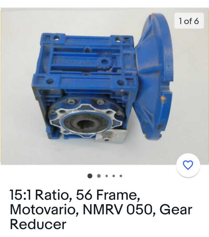

8ntruck 8,629 #74 Posted February 14, 2022 @ebinmaine Just some idle thoughts here. Looks like you need ×/- 60 degrees on your normal fan gear type of steering system. With proper drag link and driving lever design, you could set that 90 degree box up with the same +/- 60 degree of motion. At 15:1, one turn of the steering wheel will give 24 degrees rotation of the output shaft. With equal length links at the steering box and on the front spindle and assuming a +/- 60 degrees of rotation, this would be 5 turns lock to lock. Make the link on the spindle 1/2 the length of the link on the box, you will get 2 1/2 turns lock to lock. 1 1 Share this post Link to post Share on other sites
ebinmaine 77,548 #75 Posted February 14, 2022 11 minutes ago, 8ntruck said: Just some idle thoughts here. Excellent. Thank you. Share this post Link to post Share on other sites
