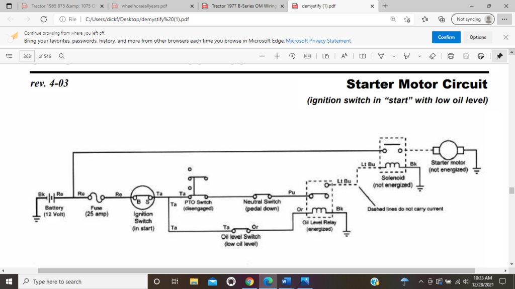

953 nut 62,189 #3 Posted January 25, 2022 (edited) We strongly discourage elimination of any safety switch. It sounds more like a bad battery or an electrical connection that is corroded or needs tightening. Depending on the year of your 310 there may be an Oil Centre switch which prevents the starter from turning if the oil is too low, check the oil. Here is a wiring diagram of the start circuit and the components in it. Edited January 25, 2022 by 953 nut 2 1 Share this post Link to post Share on other sites
Ifixoldjunk 778 #4 Posted January 25, 2022 (edited) @953 nut That was pretty much the first thought I had checking connections and the battery. Neither seem to be the issue. My idea was to temporarily bypass safeties one by one in order to single out whatever one needs replacing. Not necessarily looking to remove them all together. Edited January 25, 2022 by Ifixoldjunk Share this post Link to post Share on other sites
Achto 29,863 #5 Posted January 25, 2022 (edited) The switches have to be closed (on) in order for things to work. I would put together a jumper wire with male ends to splice the wires together for testing. Edited January 25, 2022 by Achto 3 Share this post Link to post Share on other sites
8ntruck 8,156 #6 Posted January 25, 2022 I believe that both the clutch and brake switches are in the starter solenoid circuit. Good place to start looking. In the case of the pto safety switch, take a look at the pto lever bushings. Excess play there can prevent the safety switch from being tripped. One of the trouble shooting tools I made was a short piece of wire with male flat connectors crimped on each end. I unplug the wires from the switch and connect them with the jumper I made. Good luck. 2 Share this post Link to post Share on other sites
Ifixoldjunk 778 #7 Posted January 25, 2022 So I determined it’s the clutch safety. I’ll have to order a replacement, and in the meantime I might as well figure out why my parking brake doesn’t work. Thanks for your help everybody Share this post Link to post Share on other sites
