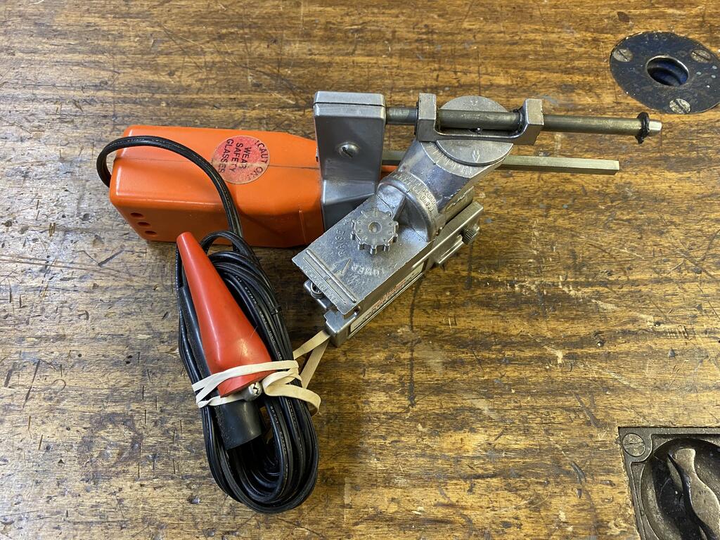

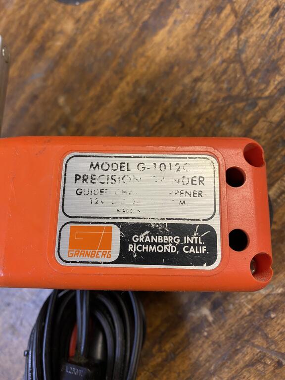

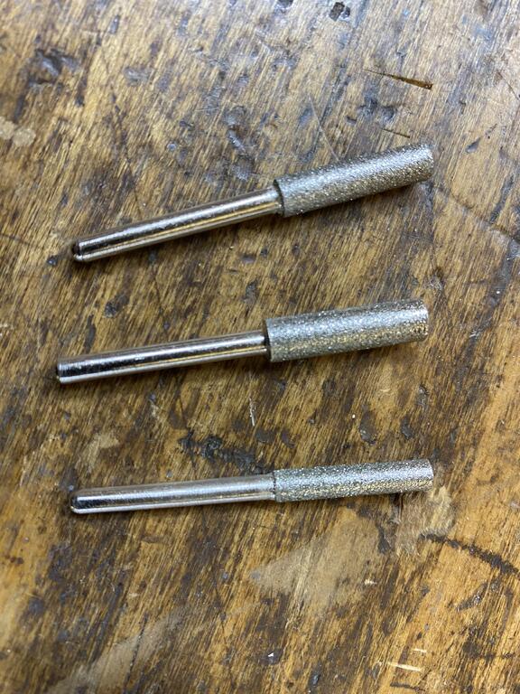

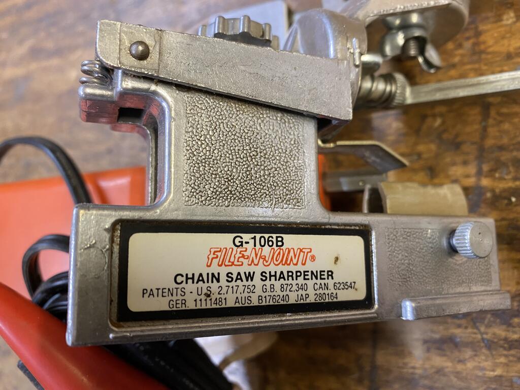

formariz 12,381 #19 Posted January 24, 2022 I too own an electric chain saw sharpener. It is however reserved for when damage to chain occurs. Having great experience with edge tools , the secret is to maintain them and not let cutters go to the point that they are dull. It requires only minutes of touch up and if nothing else is available a file works great. I however like to use the diamond burrs shown below. They maintain their shape unlike the regular burrs which wear and become deformed after a few teeth. They cut fast and leave a good solid edge not a ragged one. I either use them by hand with a Dremel or in a fully guided and controlled Oregon jig that runs off a 12 volt battery. 2 Share this post Link to post Share on other sites

ebinmaine 80,765 #22 Posted January 24, 2022 6 minutes ago, formariz said: fully guided and controlled Oregon jig I like the way those cut quite a lot but I tried them by hand and was not happy no matter what angle... What sort of jig rig do you use? Share this post Link to post Share on other sites

formariz 12,381 #24 Posted January 24, 2022 1 hour ago, ebinmaine said: I like the way those cut quite a lot but I tried them by hand and was not happy no matter what angle... What sort of jig rig do you use? Keep in mind that all you are doing with them is really honing the cutting edges. If they are already dull you should resort to a more aggressive cutting method to start with. The idea is to keep touching them up occasionally. Sorry it’s a Granberg not Oregon. 2 Share this post Link to post Share on other sites
