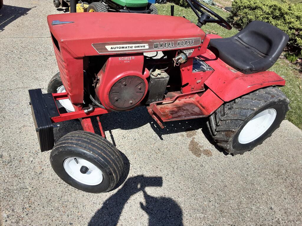

Roger R 473 #32 Posted January 19, 2022 23-10.50-12, Front weight is essential for steering control, the roller chain works great, but can damage pavement. It is hard enough to scratch concrete. 6 Share this post Link to post Share on other sites

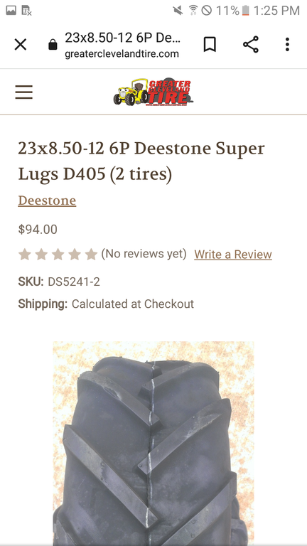

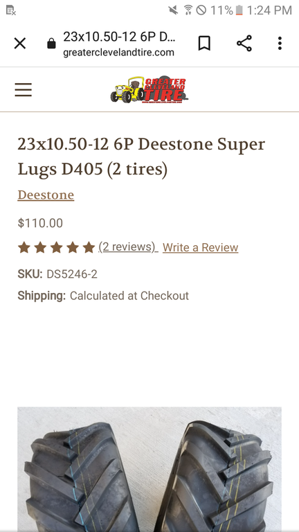

TJ5208 1,841 #34 Posted January 19, 2022 Here were i would buy mine i wanna go thin because more traction then if I go wide I can stick more weight in them opinions. Share this post Link to post Share on other sites

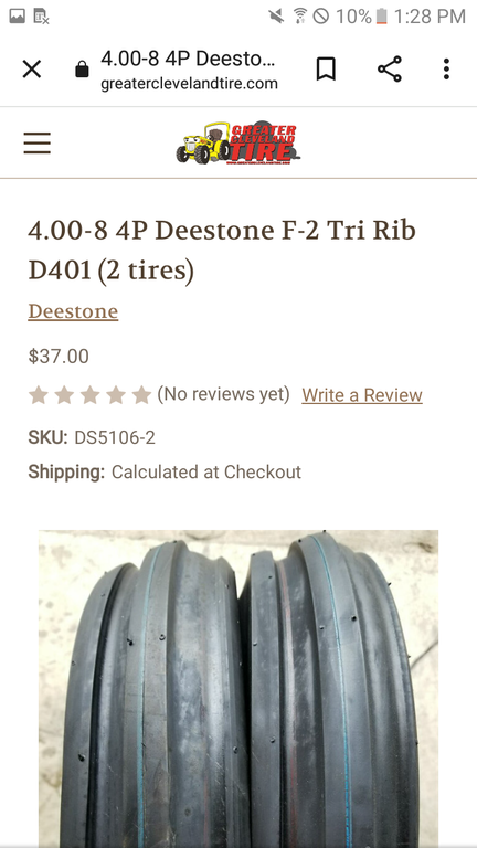

TJ5208 1,841 #35 Posted January 19, 2022 And then the tri ribs 1 Share this post Link to post Share on other sites
Snoopy11 5,731 #36 Posted January 19, 2022 (edited) 2 minutes ago, TJ Salyers said: tri ribs I will give my opinion on those. NOT ENOUGH BITE. I tried some from Tractor supply... and ended-up taking them back... Front end slides around a bit too much for my taste. Just my opinion, others can disagree. I think, for the purposes you want to use this tractor for, and in our terrain in Indiana, you will not like tri ribs at all... Don Edited January 19, 2022 by Snoopy11 typo 1 Share this post Link to post Share on other sites

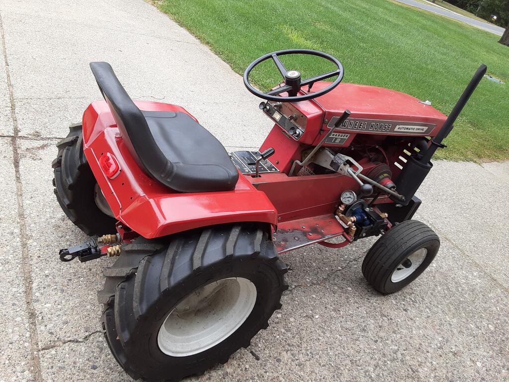

TJ5208 1,841 #39 Posted January 19, 2022 Im hoping the guy will get back to me on the Raider 12 this is what I was planning on doing Share this post Link to post Share on other sites

Achto 32,637 #44 Posted January 19, 2022 34 minutes ago, TJ Salyers said: can you jump in and give us you opinion about your ags. Best gripping tires are going to be the 23degree tread on the Firestone's. Carlisle True Power's running second. The DeeStones are the best bang for the buck but they tend to run small. A 10.50 wide DeeStone is more on the lines of a 9.50. 2 1 Share this post Link to post Share on other sites

Maxwell-8 4,371 #47 Posted January 19, 2022 (edited) Deestone run very small. But those in 10.5 would fit perfect on a stock 7" wide rim I would say go for the Charlsie thru power! @Achto beat me to it haha Edited January 19, 2022 by Maxwell-8 2 Share this post Link to post Share on other sites
Snoopy11 5,731 #48 Posted January 19, 2022 3 minutes ago, Maxwell-8 said: 0.5 would fit perfect on a stock 7" wide rim The problem I have found is that... with every size you go up... you pay considerably more... I was going to go up in size on my recent project... but when I saw that I would have to pay $75+ more... I decided to stay with stock size... Don Share this post Link to post Share on other sites
