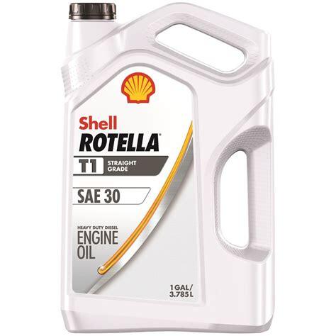

SylvanLakeWH 32,823 #13 Posted January 17, 2022 (edited) When I first got my C 105 I used 10/30 for first oil change and it smoked way more at start up. Went to 30 wt Shell Rotella based on recommendations from others on this site and it made a big difference… Edited January 17, 2022 by SylvanLakeWH 7 Share this post Link to post Share on other sites
