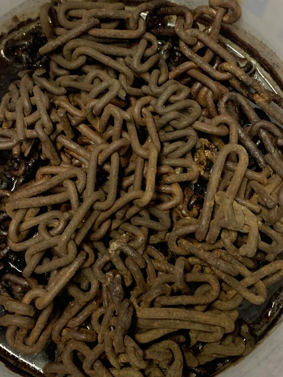

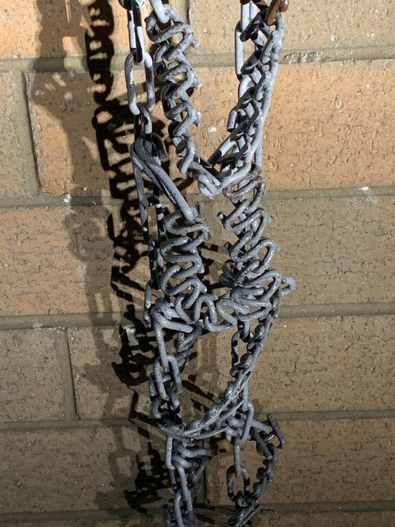

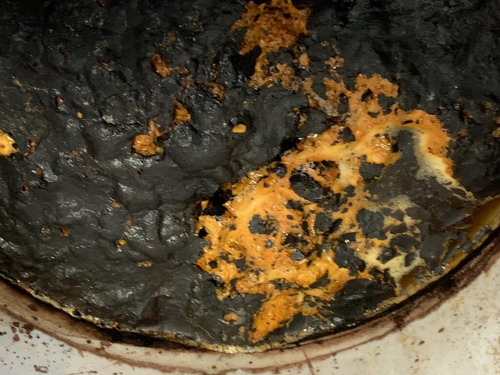

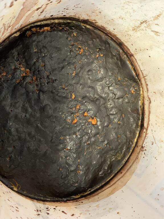

wh5208speed 677 #1 Posted January 16, 2022 (edited) While picking up a Wheel Horse last week, the seller asked if I wanted a set of tire chains. They looked very rusty, like that had sat in water for a long period. My son has a 418-A that he restored this summer and a new snowblower and I knew he was looking for a set, so I says “yes”. After doing some online research, I found someone who put their chains in vinegar for a week and it looked like it turned out pretty decent. So, I let these chains sit in the vinegar for about 5 days, as we have a snowstorm coming tomorrow and wanted to get them ready to put on my son’s tractor. It was interesting watching all of the bumbling as the vinegar reacted with the rust. After a few days the vinegar formed a very thick top crust. After power washing the vinegar & rust residue off, they turned out really good. I think if we could have waited a few more days it would have been perfect. Might do the is with all my chains at the end of the season and oil them up with some fluid film before storage. Edited January 16, 2022 by wh5208speed 7 2 1 Share this post Link to post Share on other sites
Jeff-C175 7,211 #2 Posted January 16, 2022 (edited) 35 minutes ago, wh5208speed said: a very thick top crust Looks nasty! Now the fun begins... getting them all untwisted ! Edited January 16, 2022 by Jeff-C175 1 Share this post Link to post Share on other sites

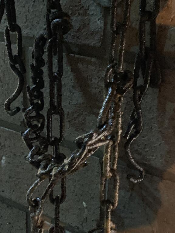

peter lena 10,090 #6 Posted January 16, 2022 @wh5208speed no mystery there , regular salvation for ANYTHING I PICK UP . AEROSOL LUBRICATION SOAK DOWN , last set of used chains I picked up were hanging ,dripping oil on my lawn spikers , to feed that steel ! thing I really like about lubrication , is that the metal retains it , with a slick black finish . BTW , my 3 mower decks are upside down now , in their winter oil soak down , no rust or rot . just my own experience , pete 2 Share this post Link to post Share on other sites

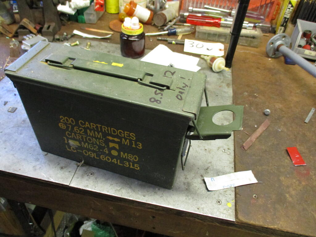

pfrederi 21,222 #7 Posted January 16, 2022 7.62mm surplus army ammo cans make great chain storage. Lower eh chins in at end of season a blast of WD-40 and close it up airtight no rust... 5 Share this post Link to post Share on other sites
