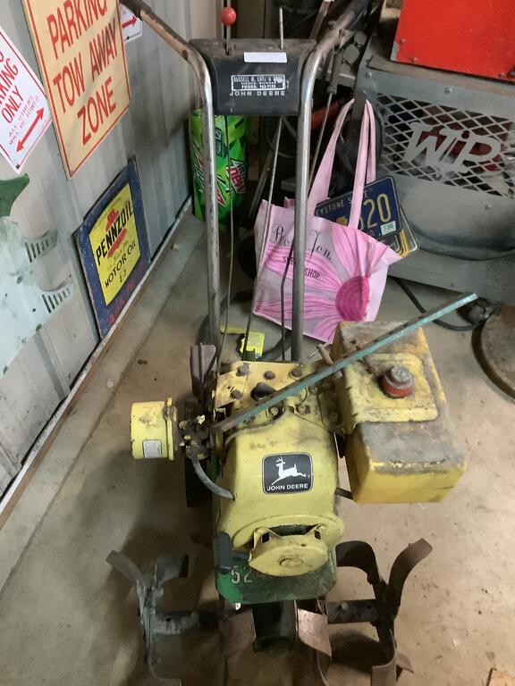

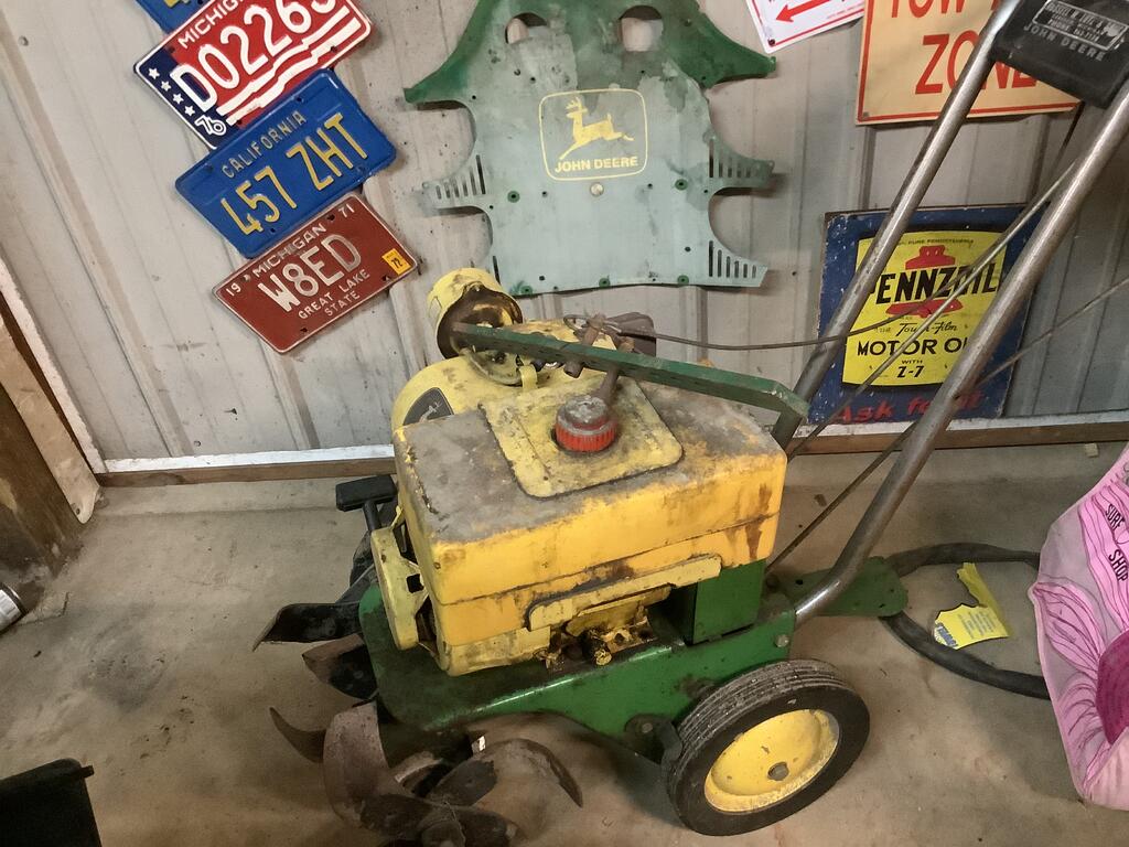

Pullstart 71,296 #1 Posted January 11, 2022 Mrs. P picked me up this 524 tiller at an estate sale the other day. The Tecky has compression. Hopefully it’ll be a quick project when the time comes! It seems pretty stout for such terrible colors 6 Share this post Link to post Share on other sites

Pullstart 71,296 #10 Posted January 11, 2022 Last night while doing some other work and letting some paint dry, I pulled it over a few times. Good clean fresh oil in it, good compression and it has spark. The choke is so gummed up, the shaft barely moves. I’ll do a good Barryman’s dip for the first to-do and flush the fuel system… new hose too. Share this post Link to post Share on other sites

Pullstart 71,296 #16 Posted January 18, 2022 I tinkered with this one tonight. I need to flush the fuel tank once more, add a new fuel line and tune the carb. It runs on carb cleaner now and the shroud is now free of mouse nest! Share this post Link to post Share on other sites
Pullstart 71,296 #18 Posted January 26, 2022 Here’s the Deere, watch it run. Run Deere, run. I even tossed the air filter on, took it out back and chewed on some snowy crushed asphalt. It runs well! 1 Share this post Link to post Share on other sites
