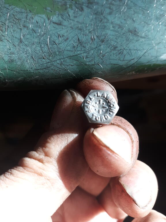

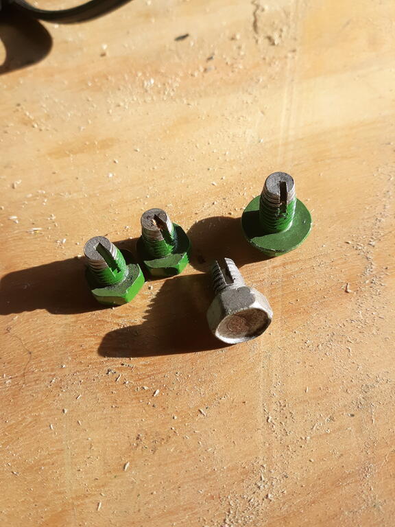

RetroMower 350 #1 Posted January 10, 2022 (edited) Not a big deal but in my quest to restore.... a tractor .... I ran across a bunch of these 5/16 stubby bolts with a slot machined in the side and for the life of me I cant think of a good reason for it. they arent homemade so they arent what I'd call a poor mans thread chaser. I made something like this when I was a teenager and didn't have a lot of tools so I made a ditch or two in a long bolt with a dremel or angle grinder to clear the crud and rust out of a blind hole. The 2nd photo is one of the most ornate bolts I've ever seen and is telling me someone in the past put this on my JD which is obviously out of place. Edited January 10, 2022 by RetroMower 2 Share this post Link to post Share on other sites
WHX?? 54,943 #2 Posted January 10, 2022 Self tapping ... mostly used in manufacturing, assembly & production sort of thing. Eliminates the tapping station but generally only in light fabrication & assembly. 8 Share this post Link to post Share on other sites
stevasaurus 23,615 #3 Posted January 10, 2022 Not positive, but I think I have seen those in places where you are attaching sheet metal to something, (like an engine). They enable you to start the bolt and pull the sheet metal into place. 2 Share this post Link to post Share on other sites
pacer 3,179 #4 Posted January 10, 2022 They're fairly common, I've ran across them off and on thru the years, and never really stopped and thought "why this type?" But I think that @stevasaurus is pretty close to nailing it. In fact --- Hmmm, doesnt some of the side panels on the horses have them? Seems like the side covers on my D's had/have them Share this post Link to post Share on other sites
gwest_ca-(File Mod) 11,998 #5 Posted January 11, 2022 https://www.valuefastener.com/thread-cutting-screws/type-thread-cutting-screws-c-100_1075_1174.html Most graded bolt heads have the maker's ID on them. That was so the source could be traced back to them. https://www.electronicfasteners.com/wp-content/uploads/2014/09/northamericanmfgidentificationmarkings.pdf 2 Share this post Link to post Share on other sites
Achto 30,988 #6 Posted January 11, 2022 (edited) We use those bolts by the thousands at work for fastening sheet metal together. Fabrication dept. will punch the bolt hole in the part leaving a think edge inside the hole. These bolts are then threaded into the hole without having to tap the hole first. Speeds up assembly. Edited January 11, 2022 by Achto 5 1 1 Share this post Link to post Share on other sites
pacer 3,179 #7 Posted January 11, 2022 6 minutes ago, Achto said: punch the bolt hole in the part leaving a think edge inside the hole. These bolts are then threaded into the hole without having tap the hole first. @Achto Those few words describe them perfectly -- and there are indeed in/on some of the panels on the one D that I ran outside and checked..... 2 Share this post Link to post Share on other sites
WHX?? 54,943 #8 Posted January 11, 2022 Thanks Garry .... I was looking for that on McMaster but couldn't find it. One nice thing about their site is they go into great detail about fasteners and what they are and should be used for. They even get into the metallurgy side of things. Exactly Dan.....unless it is high test grade, which there are such ones, you would twist the head off before you threaded say in a frame. They work good for just chasing threads of paint too. Saves you from having to get out the tap & die set, dropping it and then playing 52 pick up like the Hosen @Pullstart often does. 1 1 Share this post Link to post Share on other sites
RetroMower 350 #9 Posted January 11, 2022 18 minutes ago, Achto said: We use those bolts by the thousands at work for fastening sheet metal together. Fabrication dept. will punch the bolt hole in the part leaving a think edge inside the hole. These bolts are then threaded into the hole without having tap the hole first. Speeds up assembly. I love definitive answers and it makes total sense now that it has been explained so clearly. I guess I was thinking in the complete wrong direction because so far there has been no need on this machine for such a fastener. I'm thinking in a previous repair these found their way from someone's stash to this 110 and same goes for the fancy Toro bolt. 1 Share this post Link to post Share on other sites

Howie 900 #11 Posted January 11, 2022 Having worked in the fastener industry for over 45 years, those bolts do indeed cut their own threads. As was said most likely in thinner material. 1 Share this post Link to post Share on other sites

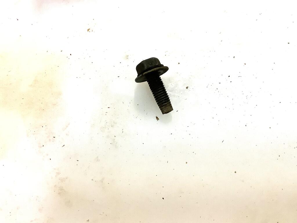

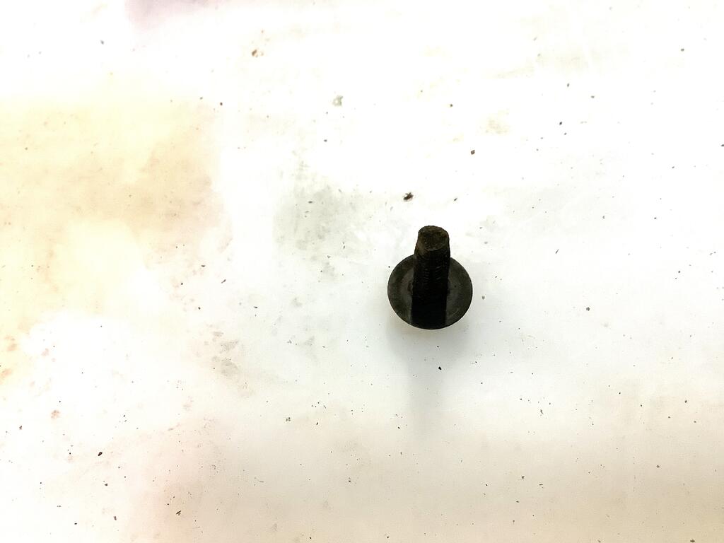

Pullstart 68,878 #13 Posted January 11, 2022 Found this bolt on the floor shortly after @WHX?? called me in to this thread. It comes from a truck frame. It’s kind of round-triangle shaped and self taps into the frame for e-brake candle holders, etc. 1 Share this post Link to post Share on other sites

8ntruck 8,601 #15 Posted January 11, 2022 @Pullstart that is a self tapping, prevailing torque fastener. The triangular section acts like a lock washer. I think these were invented in the last 60's or early 70's. Share this post Link to post Share on other sites

Howie 900 #20 Posted January 12, 2022 The one pullstart showed is what we called a taptite bolt. Just taps its own threads to eliminate a step in the assembly operation. Our plant in Belvidere specialized in those and we did manufacture some at our plant. I'm sure others used other names for it also. Share this post Link to post Share on other sites
