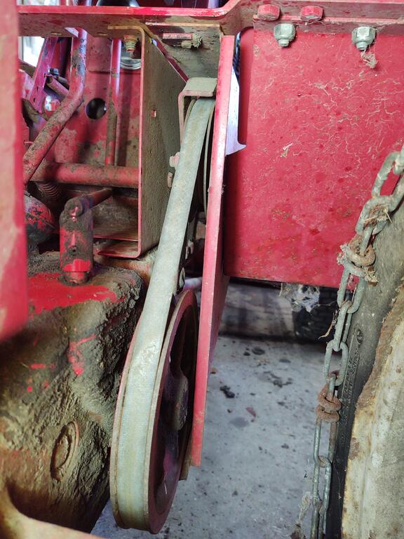

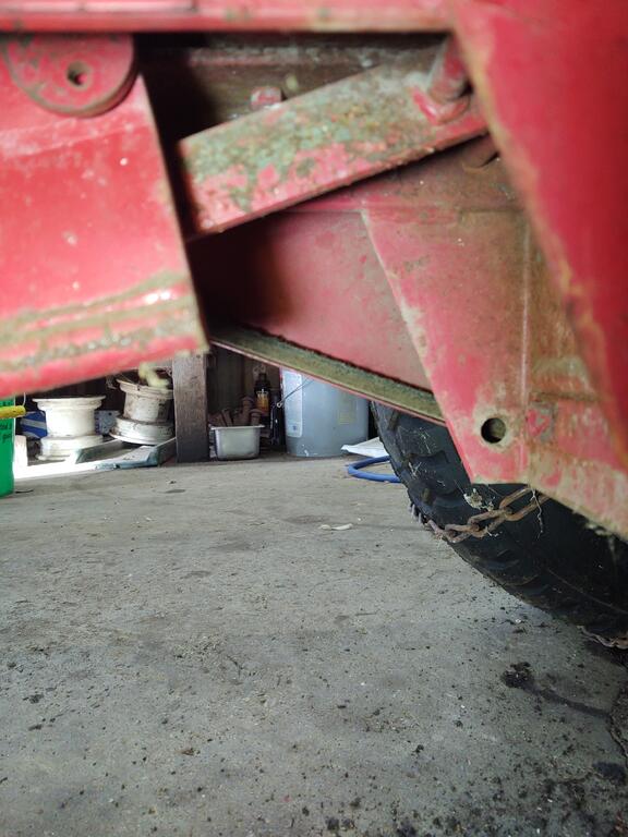

Joe 77 B100 84 #14 Posted January 9, 2022 I found this image online. My tractor has a guard so I cannot see the configuration as well but those two rear pulleys are the ones I assume people are talking about. The smaller one is the idler pulley and the lower one??? Here is a pic of my tractor from the rear. For one, the pulleys look much bigger than those in the image above which might be causing the issue I am hearing you will see below. In the image below, you can see from the left side under the tractor that the belt actually sits on the belt guard which is what is causing the noise I hear when I release the clutch. I told you it wasn't a bad noise, just something moving or working. So, the noise is the belt rubbing. I assume I am going to have to adjust tension somewhere. Can someone 1) tell me how to do that and 2) post a schematic of what those distances should look like? I think I saw some clearances in the owners manual so I will go back and check that again. 1 Share this post Link to post Share on other sites

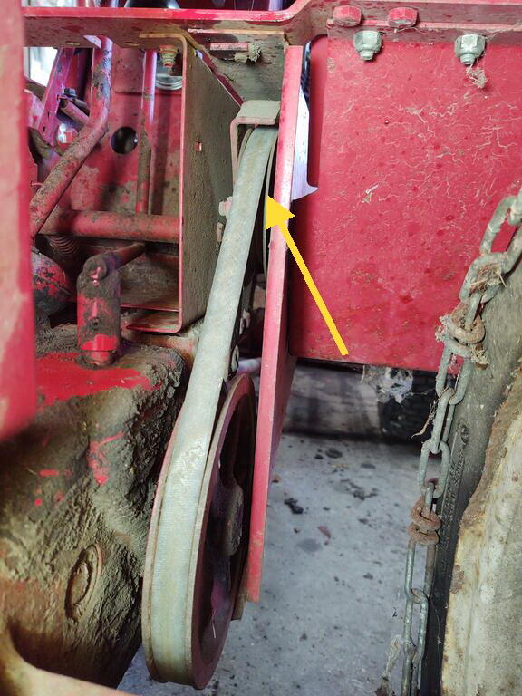

rmaynard 17,496 #15 Posted January 9, 2022 Your belt, from what I can see, looks good. It doesn't have the appearance of a belt with a lot of wear. The picture below with the arrow is showing the pulley that sometimes will make a lot of noise. 2 Share this post Link to post Share on other sites
peter lena 9,994 #16 Posted January 9, 2022 agree with @rmaynard on that upper pulley , another thing is to check out the function and / lubrication of related linkage to this area, typically neglected , and bound up with rust , creates a lot of issues. would not be surprised in the idler pulley , noisy bearing failure. should be easy to match up . pete 1 Share this post Link to post Share on other sites
Joe 77 B100 84 #17 Posted January 9, 2022 The more I look at it, the pulley must be too big. There would be no way for the belt to NOT slightly rub on the belt guard except to have a smaller pulley. Right? I WILL go check all of the lubrication points. Share this post Link to post Share on other sites

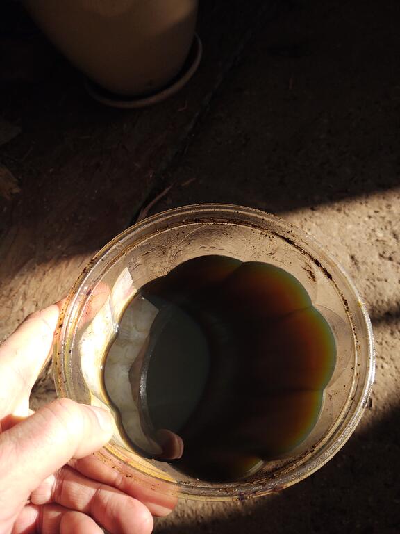

Joe 77 B100 84 #18 Posted January 9, 2022 Someone asked to see the oil. There was almost none in there but what was there was fairly clean. You can see through it when I put it in the light. 1 Share this post Link to post Share on other sites
SylvanLakeWH 32,022 #19 Posted January 9, 2022 (edited) How much came out? That could be the noise issue right there… not enough oil… Also did you put the front end of the tractor up high to drain trans oil? There’s a hump inside that blocks oil from plug if you don’t raise the front end… Edited January 9, 2022 by SylvanLakeWH 3 1 Share this post Link to post Share on other sites

Maxwell-8 4,371 #22 Posted January 9, 2022 (edited) 2 hours ago, ecojoe69 said: The smaller one is the idler pulley and the lower one??? Input of the tranny It needs 2qts of 80w90 The white idler pulley on my C141 is to big too, but isn't making any noise. You should feel if the bearing has any side to side play, or is noisy when not contacted with the belt. My 314 had that pulley bad and made a lot of noise. My raider is now showing the same symptoms. The grease in that bearing will eventually dissapear. And if you feel like it is the plate rubbing. You can't adjust the belt tension. that is done with the clutch and if the clutch engages correct. you better not mesh with it. Could be someone picked up the horse with a forklift or so, bending that plate. All you have to do is bent the plate back out of the way for the belt. Edited January 9, 2022 by Maxwell-8 2 Share this post Link to post Share on other sites
