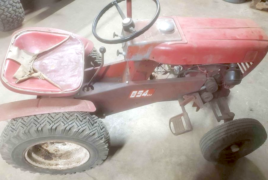

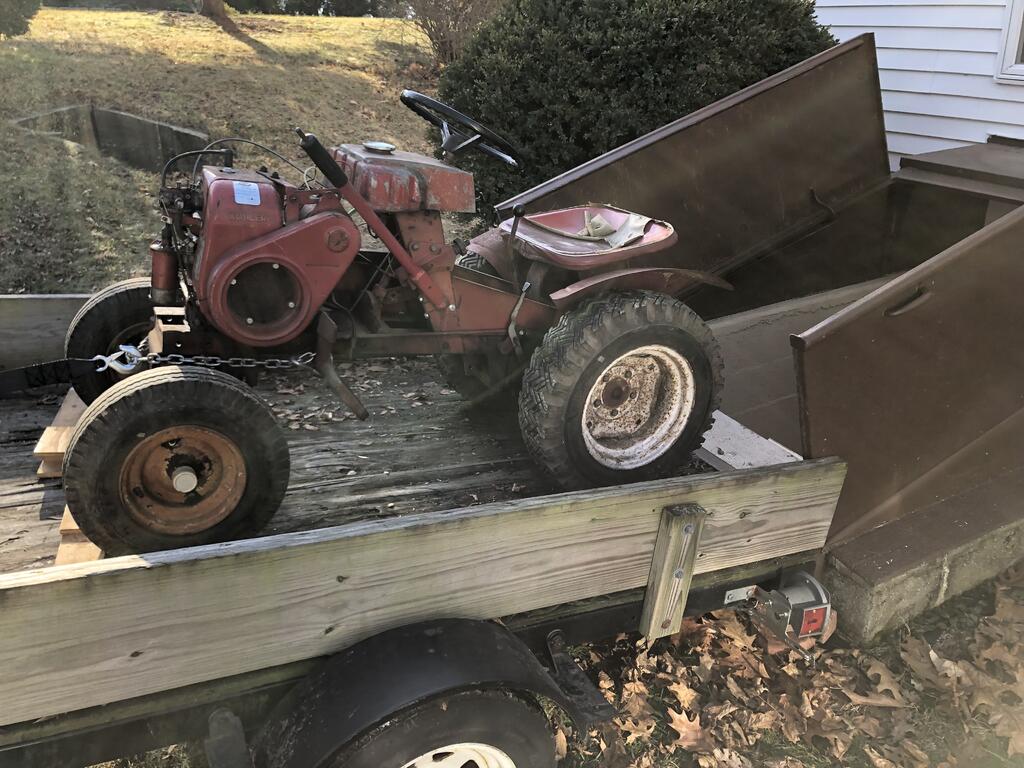

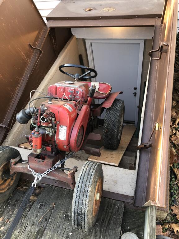

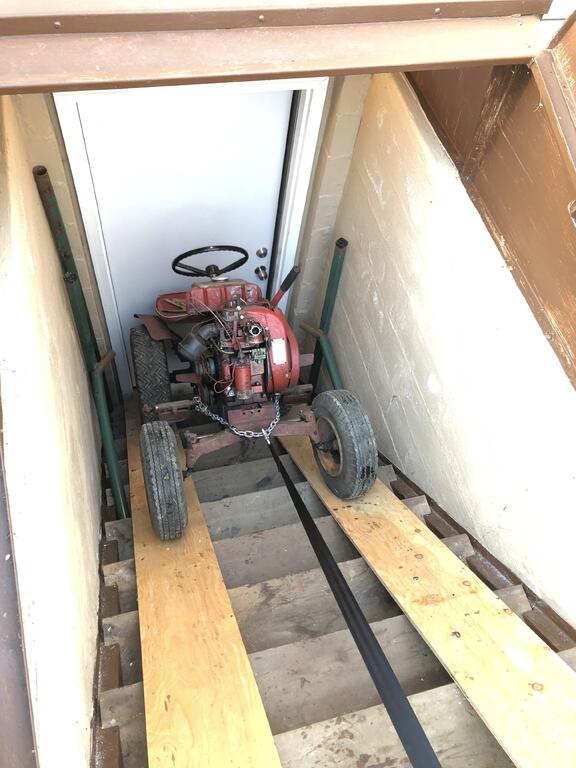

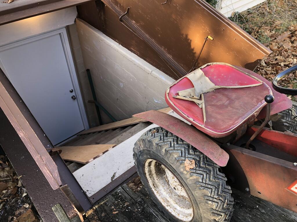

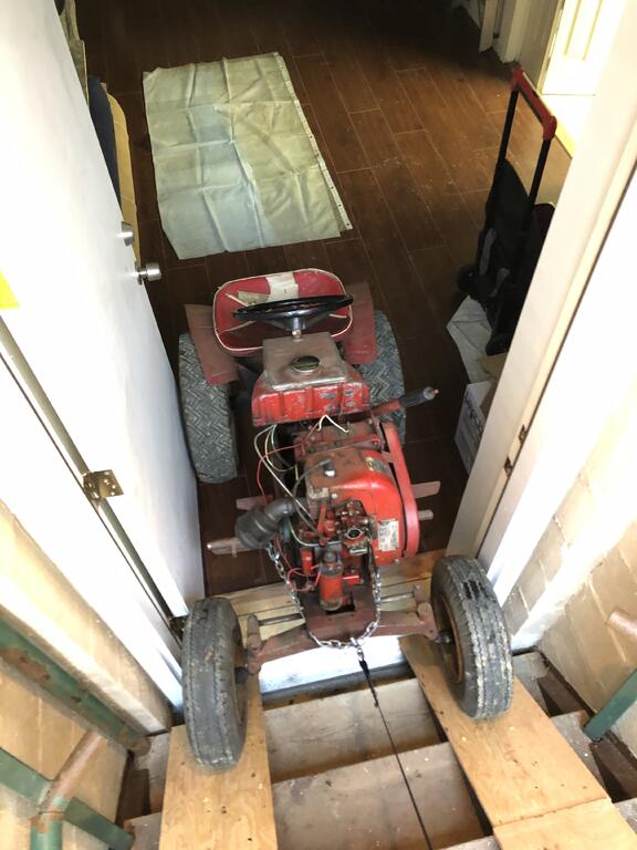

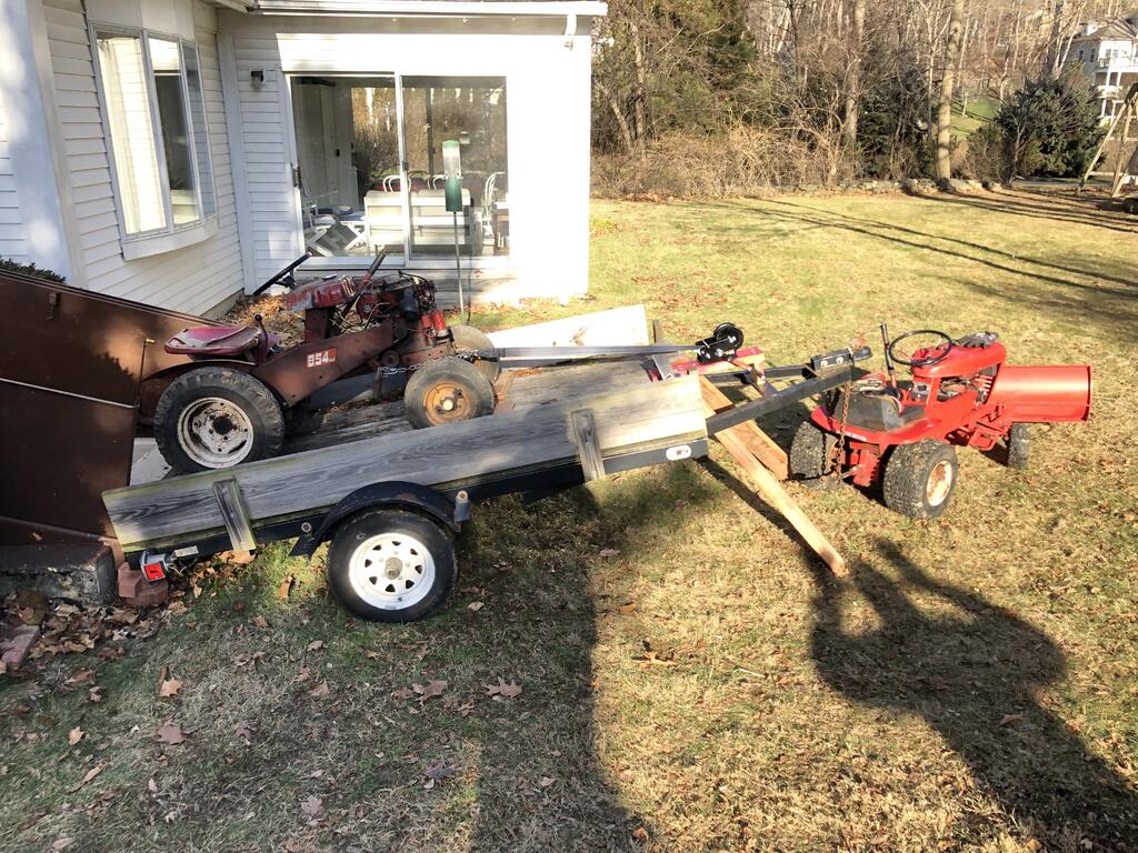

Handy Don 17,380 #1 Posted January 5, 2022 (edited) After an intro to round hoods via the Lawn Ranger, I've been kinda sorta on the lookout for one of the taller models. Three weeks ago, on a quiet Friday night, a tired non-running 854 snuck out of Pennsylvania across the Delaware River into New Jersey, continued on over the Hudson River into New York, and ended its trip in my garage (displacing my car)! Since my spouse's response to my plan to convert a storage area in the garage into a heated work area to work on tractors was met with "Don't you already have a nice shop in the basement?", I needed a new plan. First, I realized that the 854 is only 31" wide (vs. 42" for the 520). Then last week I asked for and got a lot of good advice on trailer-mounting a winch so I went ahead and built a quick and dirty trial version. Lastly, I added ramps to my exterior basement stairs. Today, it came together. My son and I chained the trailer to the Lawn Ranger (as a counterweight!), hoisted the 854 up onto the trailer, backed the trailer up to the stairwell, and then winched the 854 down the ramp and through the 32.5" wide basement door. We were both surprised at how smoothly it went. I won't get to work on this machine for a couple of months as I've got several other projects in the works, but when I do I'll post progress to this topic. So, on to the pictures! Here's the 854. PO says it was running as a plow tractor in 2020 until its lift cable broke trying to lift a stuck plow, sidelining it. Seems the backup tractor became primary and this one got parked at the back of the shed. I'm fairly sure it had an HY unit (cleaner paint area on the hoodstand) and probably ag tires that got swapped off for its original tires before it was put up for sale (these tires are practically new and the lug bolts have recent marks on them while the fronts are on their last legs). Its ignition switch, voltage regulator, and some other bits are probably on other tractors as well so I'll be doing some shopping once I get a full survey done. And here's the "deep dive". (I took off the hood for the transit to avoid risking it being damaged--the air cleaner is MIA at the moment.) Edited January 5, 2022 by Handy Don 10 12 Share this post Link to post Share on other sites
sjoemie himself 3,178 #2 Posted January 5, 2022 That's quite the descent with that steep angle! But hey, you made it work Are you going to do a full restoration on it? Share this post Link to post Share on other sites
ebinmaine 80,460 #3 Posted January 5, 2022 Excellent execution of the tractor to basement workshop plan Don. I'll be looking forward to seeing the progress. 2 1 Share this post Link to post Share on other sites

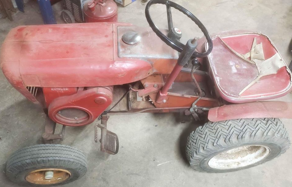

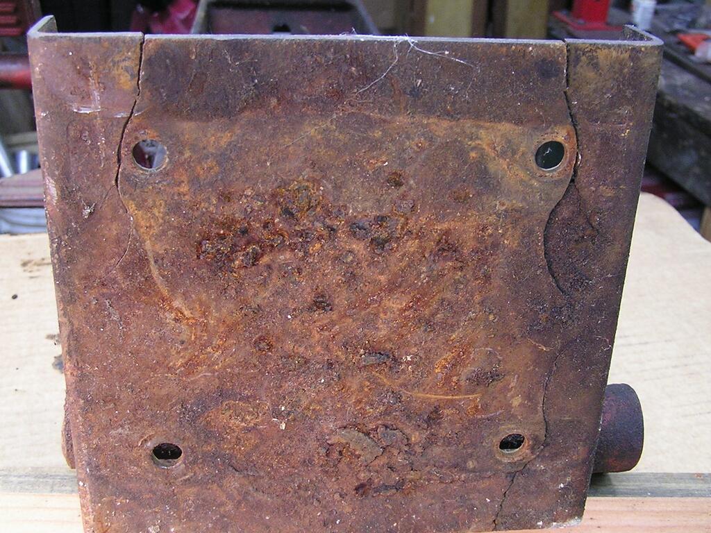

ri702bill 12,912 #4 Posted January 5, 2022 (edited) Don Now I see the interest in the 8 speed conversion.... tractor looks almost complete air cleaner housing as mentioned and the left cover over the brake are missing. Looks to be a solid start - check the frame "F" plate for cracks where it mounts the Unidrive.......... this one was from an 854 IF you do the 8 speed conversion you can probably DRIVE it up the ramps in 1st gear, Lo range !!!! IF you can get enough traction. Bill Edited January 5, 2022 by ri702bill 5 Share this post Link to post Share on other sites

953 nut 68,795 #8 Posted January 5, 2022 9 hours ago, Handy Don said: My son and I chained the trailer to the Lawn Ranger (as a counterweight!), hoisted the 854 up onto the trailer, backed the trailer up to the stairwell, and then winched the 854 down the ramp and through the 32.5" wide basement door. We were both surprised at how smoothly it went Gravity was your friend going into the basement, may need to eat your Wheaties when it is time to bring it back out into the world. 3 1 Share this post Link to post Share on other sites

Handy Don 17,380 #18 Posted January 5, 2022 Thanks for all the responses, all y'all! 7 hours ago, sjoemie himself said: Are you going to do a full restoration on it? Good question. This is far from an "untouched barn find". I'll do whatever it takes to get it mechanically sound for sure. I'm intending it as a utility worker (It'll replace the Lawn Ranger--will post a classified for it soon). I'm becoming more comfortable with the "this is an old tractor" look after doing a lot of cosmetic work on the 310 and 518/520. This 854, though, has already had some paint added over poor preparation somewhere along the way so likely it'll get a partial prep/paint job--wheels and tins for sure and I'll have to see what's what with the engine, transaxle, frame, etc. Also, depending on the condition of the transaxle, cost, and what mods are needed, I might entertain an 8-speed upgrade. 5 hours ago, ri702bill said: check the frame "F" plate for cracks where it mounts the Unidrive.......... this one was from an 854 Good point. Since I know it was worked I intend to give it a thorough mechanical and electrical exam (PO did say that it never had a mower or front plow--it came to him as a plow tractor and that was its twice a year duty for many years). It has a slot hitch which seems like it'd be good for pulling but I'm not sure about lifting. A front attachamatic adaptor may be in its future as well. 3 hours ago, Pullstart said: Glad to see the winch ideas help up! Fun project Don! Yes, they did. I am very glad I did a prototype as a test. The "over the spare" bridge style will be a win but I definitely identified some design changes that will be needed when I do it in metal instead of wood. For one, I will need a removable roller at the rear lip of the trailer to guide the strap and for another I'll need more clearance for the handle swing (too easy now to skin knuckles!) 3 hours ago, 953 nut said: may need to eat your Wheaties when it is time to bring it back out into the world . I'll stock up. 3 hours ago, squonk said: Save yourself a couple of 6-12 rear wheels and tires. Then you can mount them on your bigger horses and fit them into your basement Yep, compared to turfs, they do narrow the width a lot--widest point is the front wheels! The 520, though, has the swept front axle and heavy spindles so its width at the front wheels is 41"--no finessing that fellow. Initially I was ready to just put a wider door in the basement but to get more than another 2" would have meant rebuilding the house's foundation 😬! I binned that idea quickly. 1 hour ago, SylvanLakeWH said: Go in reverse… it’ll walk right up… Probably would, but I'm "inclined" to go with frontward and keeping it on the winch to keep the front down . Certainly not a question of power, only traction and balance. 2 hours ago, Ed Kennell said: Kevin coulda drove that down w/o ramps or com-a-longs. I seriously considered just "bumping" it (a la "The Italian Job"). I think going down it would have worked but coming back up would be a real PITA and put unnecessary strain on the winch and the tractor. 1 1 1 Share this post Link to post Share on other sites
ebinmaine 80,460 #19 Posted January 5, 2022 1 hour ago, Handy Don said: might entertain an 8-speed upgrade. Research that one carefully. It WILL bolt up with slight modifications. Several of us have done it. I tried it with a 1267 that I attempted to make into a plow tractor. I found two things. 1. Getting the brake to line up and be functional as a parking brake is possible but it needs to be adjusted OFTEN. 2. I found that I just could not get a proper grab on several different belts of several different sizes. When I'm plowing snow I go back and forth a LOT. I wore out three belts in about a season. I eventually gave up and dismantled the tractor..... Above issues noted, if you're going to use it as a tiller or want to put it in reverse and back a trailer around the corner I HIGHLY recommend low range. 1 Share this post Link to post Share on other sites
