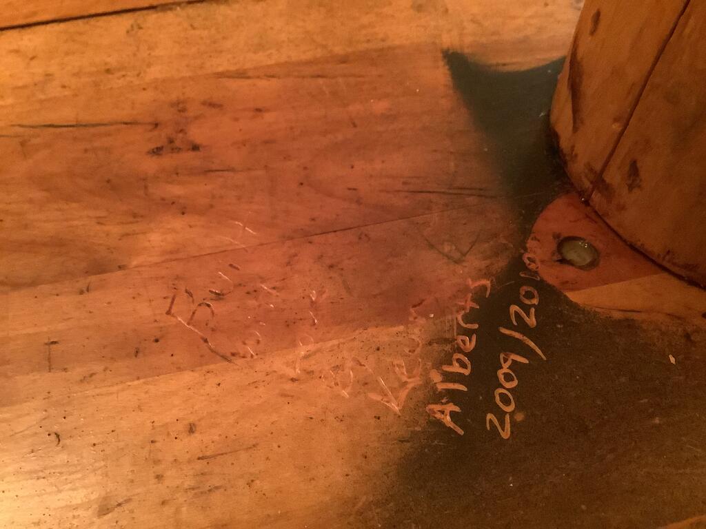

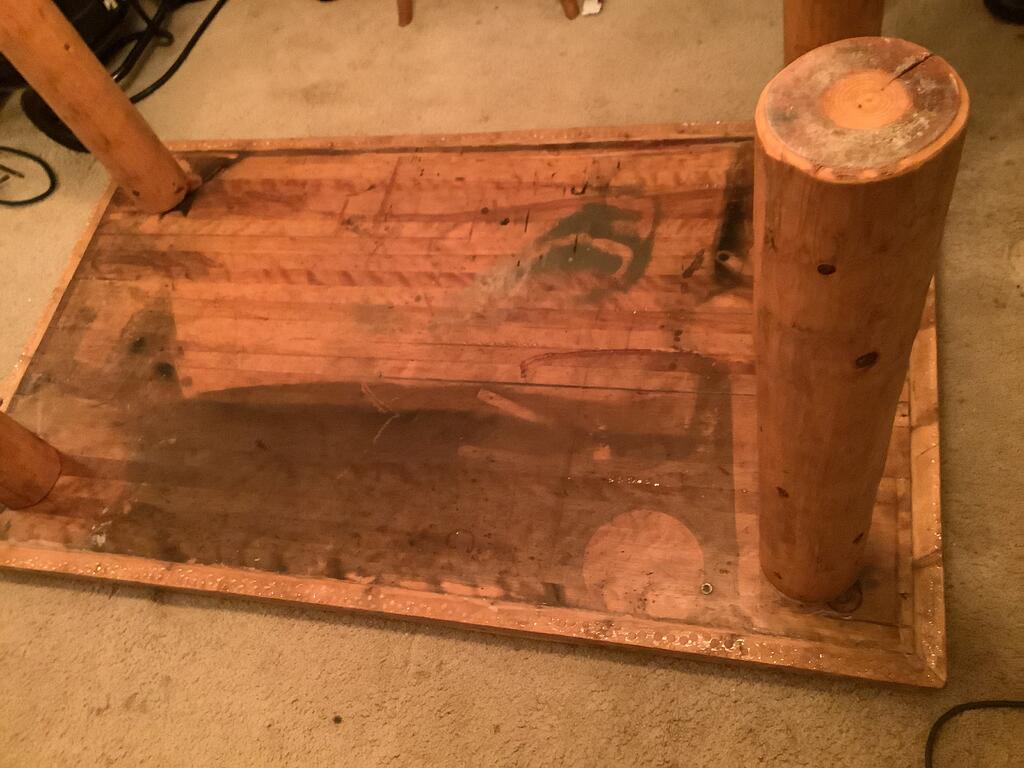

Pullstart 71,296 #52 Posted January 26, 2022 Tonight after some aggressive cards competition with the family, we flipped the table over. I’ll be using my belt sander to clean the drippies off. I signed it way back when. “Built with Love by Kevin Alberts 2009/2010” 3 Share this post Link to post Share on other sites
formariz 12,381 #53 Posted January 26, 2022 (edited) Great final touch done in an honorable manner. I was taught early to be proud of my work, but if "necessary" always place your mark in the back or hidden showing humility and not detracting from the actual beauty of a piece by placing a boisterous signature in front. A project to be proud of and a great example to your children. May you all live long peaceful lives sitting together at it. Edited January 26, 2022 by formariz 3 Share this post Link to post Share on other sites
