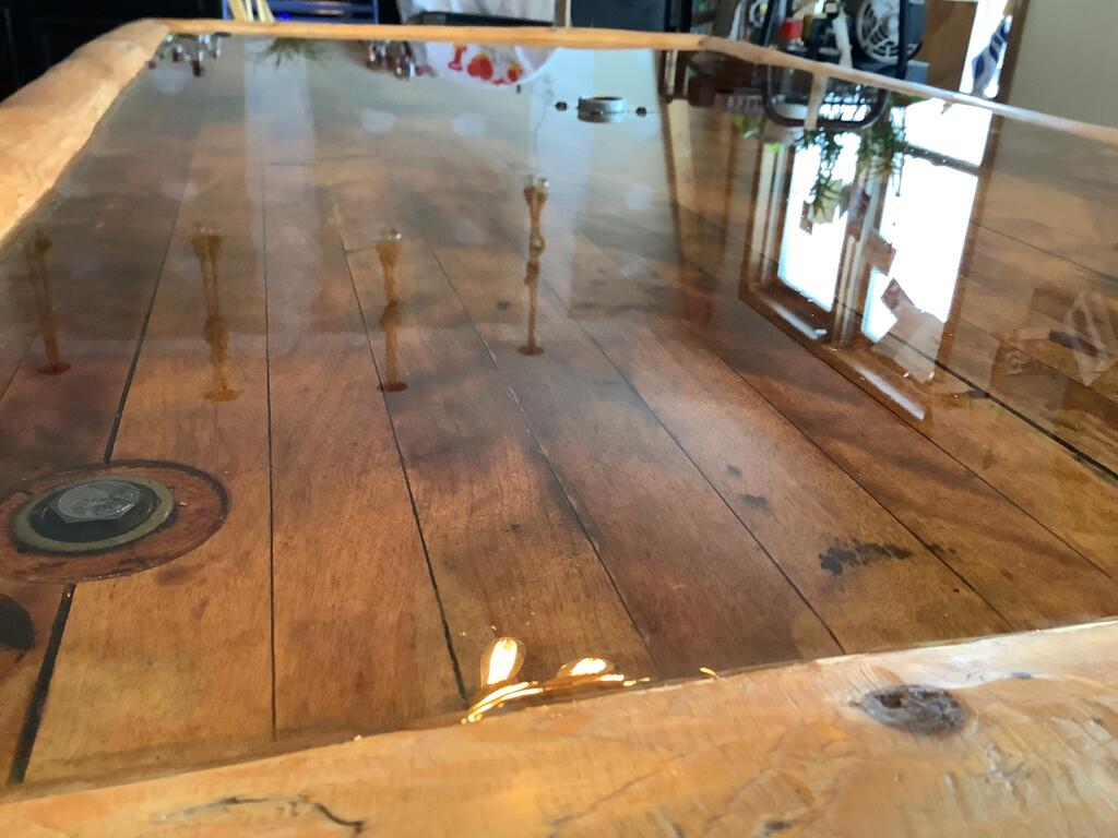

Pullstart 70,504 #30 Posted January 12, 2022 Second pour done…. Time to pop bubbles every 30 minutes or so. I’ve got nearly a gallon left, but may end hp going to the store for more. I wonder if they’ll have the same brand as they carried 12 years ago… 1 2 2 Share this post Link to post Share on other sites
BHunter 1,702 #31 Posted January 12, 2022 43 minutes ago, Pullstart said: Second pour done…. Time to pop bubbles every 30 minutes or so. I’ve got nearly a gallon left, but may end hp going to the store for more. I wonder if they’ll have the same brand as they carried 12 years ago… Looks awesome! 1 Share this post Link to post Share on other sites
WHX?? 57,316 #32 Posted January 12, 2022 2 hours ago, Pullstart said: Hey, you guys feel free to do me one better I do my best yodeling with a motor running with no muffs... Looking good Kev ... I thought maybe one had to wait a little longer between applications? Don't think brand is going to matter. 1 Share this post Link to post Share on other sites
Pullstart 70,504 #33 Posted January 13, 2022 12 minutes ago, WHX?? said: I do my best yodeling with a motor running with no muffs... Looking good Kev ... I thought maybe one had to wait a little longer between applications? Don't think brand is going to matter. From what I read, after 4 hours and before 24 hours… or after 72 and a scuff. We’ll top it off over the bumpy items and if a scuff is needed to block it smooth, then we’ll proceed as needed 1 Share this post Link to post Share on other sites

Pullstart 70,504 #39 Posted January 14, 2022 Looks like one more pour is in order. The button and a couple casings are still leaving a ripple. We’re close to running over the low edge though! 5 Share this post Link to post Share on other sites

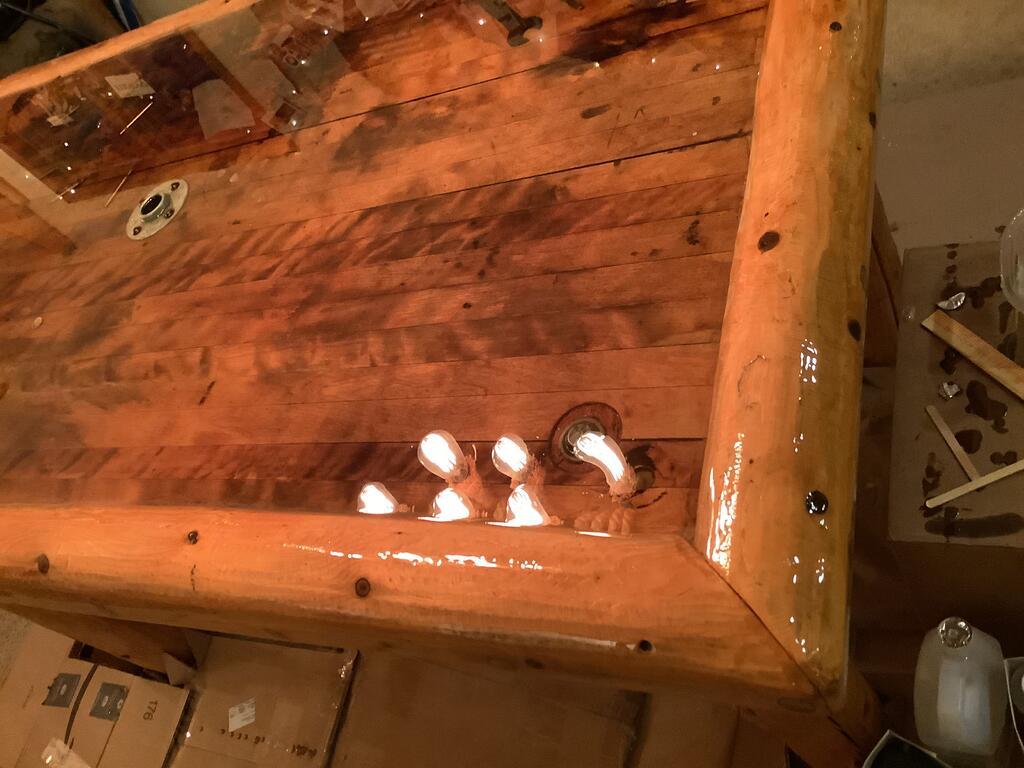

Pullstart 70,504 #40 Posted January 15, 2022 We brushed the edges tonight, with *hopefully* the last pour! Hey Uncle Jim! I laid down cardboard! 1 1 2 Share this post Link to post Share on other sites

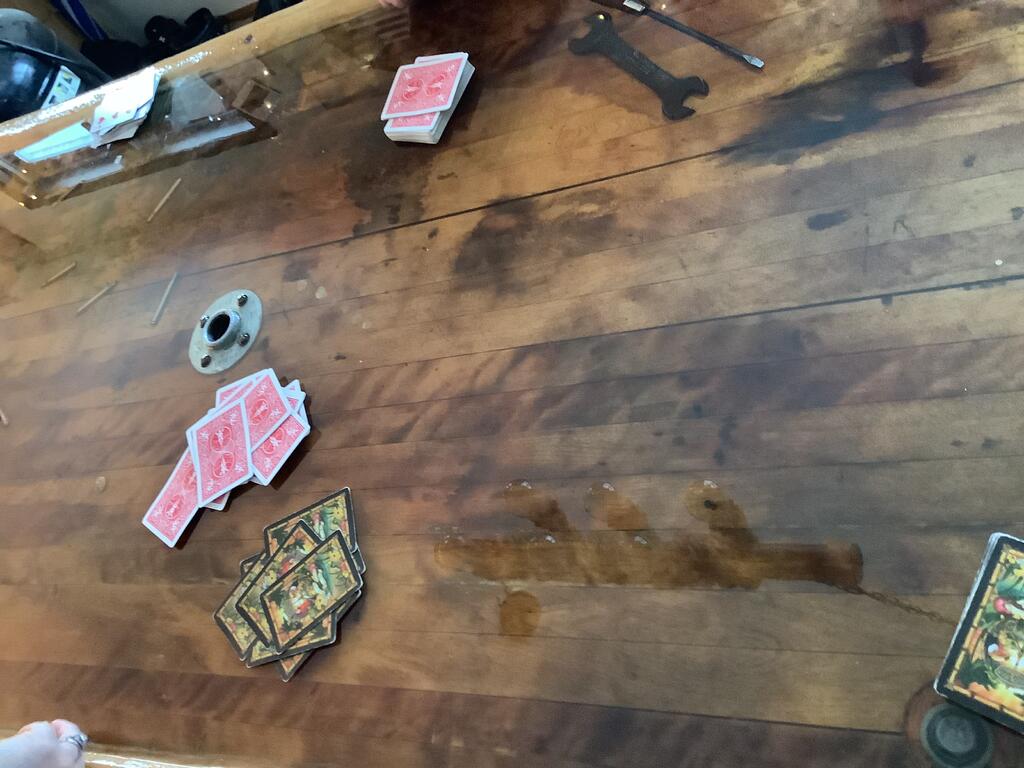

Pullstart 70,504 #43 Posted January 16, 2022 We’re taking a break from pours and work for some family card games. The table plays much better! 1 Share this post Link to post Share on other sites
Jeff-C175 7,209 #44 Posted January 16, 2022 12 minutes ago, Pullstart said: taking a break from pours Looks like ya scuffed the gloss off it? It was glossy as all bejeezus before! Share this post Link to post Share on other sites
Pullstart 70,504 #45 Posted January 16, 2022 14 minutes ago, Jeff-C175 said: Looks like ya scuffed the gloss off it? It was glossy as all bejeezus before! Lights are off, bad camera angle it’s still very clear and shiny. We’ll give it a 2500 grit scuff on Tuesday and pour one more coat on the entire thing again. 2 1 Share this post Link to post Share on other sites
Jeff-C175 7,209 #46 Posted January 16, 2022 3 minutes ago, Pullstart said: Lights are off, Ohhhh... now I see that this: is a reflection of the hanging light fixture! At first I thought you spilt yer beer! 2 Share this post Link to post Share on other sites
WHX?? 57,316 #47 Posted January 17, 2022 3 hours ago, Jeff-C175 said: you spilt yer beer! Not out of line ther Jeff ...he's been known to be a three beer guy..... drinks one, spills one and leaves one.... 2 1 Share this post Link to post Share on other sites
Pullstart 70,504 #48 Posted January 17, 2022 5 minutes ago, WHX?? said: Not out of line ther Jeff ...he's been known to be a three beer guy..... drinks one, spills one and leaves one.... You must have the wrong @Pullstart! Share this post Link to post Share on other sites
formariz 12,379 #49 Posted January 17, 2022 3 hours ago, Pullstart said: We’re taking a break from pours and work for some family card games. The table plays much better! Not criticizing the family games on it now. Nice to see you already enjoying table. However, be careful not to contaminate finish prior to final coat. That can create a real problem when you apply next coat. Make sure you wipe coating with some denatured alcohol . Let that dry throughly and then scuff it prior to next coat. 1 Share this post Link to post Share on other sites
formariz 12,379 #50 Posted January 17, 2022 18 minutes ago, formariz said: Not criticizing the family games on it now. Nice to see you already enjoying table. However, be careful not to contaminate finish prior to final coat. That can create a real problem when you apply next coat. Make sure you wipe coating with some denatured alcohol . Let that dry throughly and then scuff it prior to next coat. Be particularly careful with anything greasy on it. That contamination will show up as “ fish eye” on final coat . You will not be able to get rid of it without stripping it. Share this post Link to post Share on other sites
