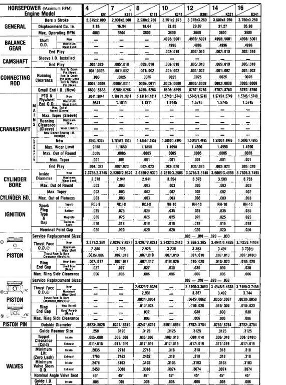

Retired Wrencher 6,990 #1 Posted January 4, 2022 Looking for the gap Tappet clearance. on K181. Thanks in advance. Share this post Link to post Share on other sites
pfrederi 21,175 #2 Posted January 4, 2022 3 minutes ago, Retierd Wrencher said: Looking for the gap Tappet clearance. on K181. Thanks in advance. .006/.008 .017/.019 from the manual 4 Share this post Link to post Share on other sites

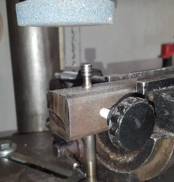

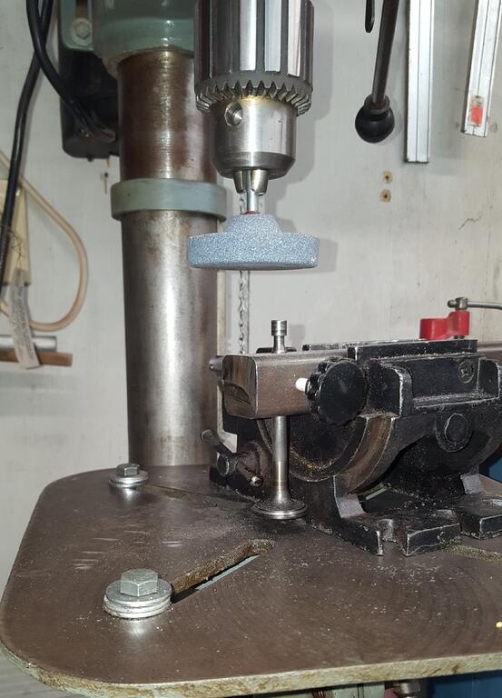

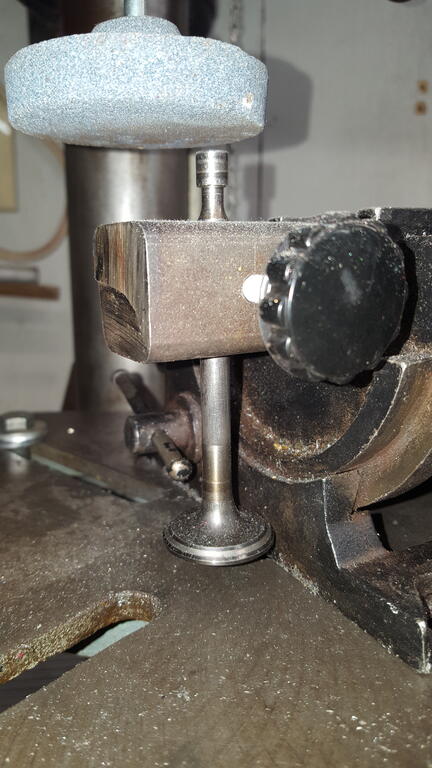

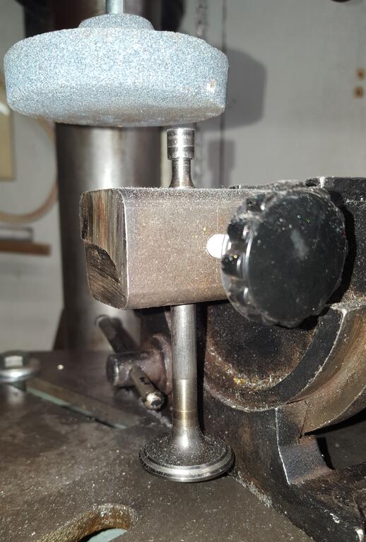

Gregor 4,848 #14 Posted January 4, 2022 15 minutes ago, lynnmor said: Trying to do them by hand is only guessing and the end will not be square to the stem. There are specialized grinders for the purpose. Grinding valve stems is a slow tedious job. Not one of my favorites, when rebuilding an engine, I always worried about having the end of the stem square to the valve. While this set up I'm sure is not 100% accurate, it has to be better than holding your valve stem to the side of your bench grinder, and hoping for the best. Once I am in spec, I change out the grinding wheel for a sanding disc, to polish the end a bit more.There is a small brass plug between the valve stem and the thumb screw. Prevents damage to the stem. I can set my dial indicator up to see just how much I have taken off. It isn't a job you want to do twice. Besides, who has an extra valve laying around? Oh yeah, I do. 5 Share this post Link to post Share on other sites

Handy Don 17,489 #19 Posted January 5, 2022 3 hours ago, Gregor said: While this set up I'm sure is not 100% accurate I really like the setup, but am especially intrigued by the vise. Very handy to have the angle setting option. Share this post Link to post Share on other sites
