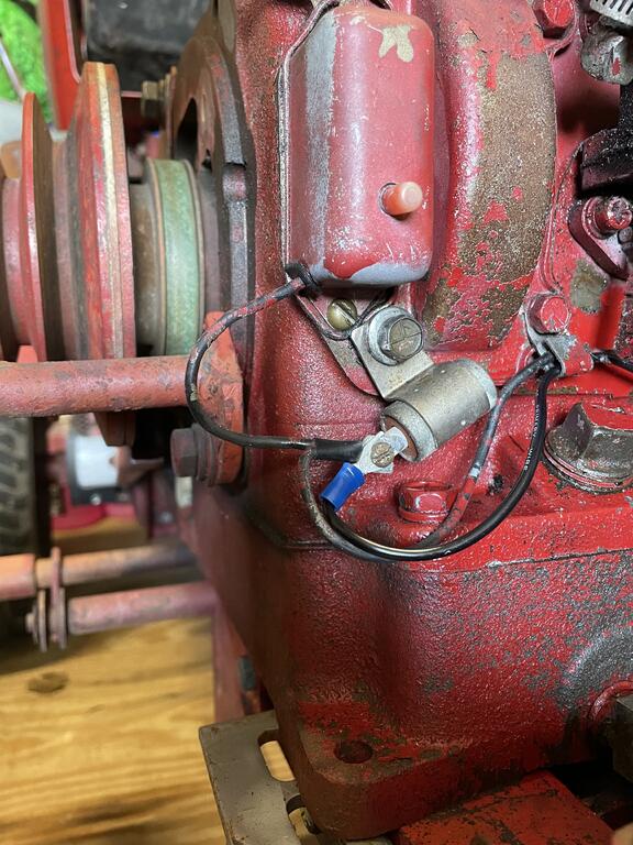

BHunter 1,702 #80 Posted September 13, 2022 16 hours ago, BHunter said: Thanks Richard. I’m going to go through the whole system. The battery hasn’t been load tested. Hi Richard. I bought a 5 prong relay and wired it up correctly. The engine starts but doesn’t turn off when I turn the key back. I ran the 87a wire to the condenser where the magneto wire is. Is that ok? That is where the PO had a kill switch wires to and it killed the engine. thanks, Bob Share this post Link to post Share on other sites
953 nut 68,155 #81 Posted September 13, 2022 6 hours ago, BHunter said: I ran the 87a wire to the condenser where the magneto wire is. Is that ok? That is where the PO had a kill switch wires to and it killed the engine. If the #30 terminal on the relay is connected to a good engine/frame ground it should work. With the relay removed from the socket do you have continuity between the 87a and 30 terminals, you should because the internal switch is normally closed. Share this post Link to post Share on other sites
BHunter 1,702 #82 Posted September 14, 2022 42 minutes ago, 953 nut said: If the #30 terminal on the relay is connected to a good engine/frame ground it should work. With the relay removed from the socket do you have continuity between the 87a and 30 terminals, you should because the internal switch is normally closed. I will check the ground connection. I twisted the #30 wire with the 86 wire and ran it to the negative post on battery. I didn’t check continuity yet. Share this post Link to post Share on other sites
