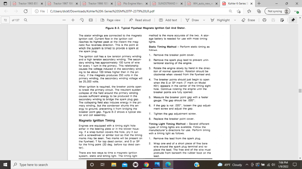

953 nut 69,544 #27 Posted January 10, 2022 (edited) 2 hours ago, BHunter said: it runs. Can’t rev it up or it dies. Check the timing, if your points aren't set properly it won't run right. See page 8.2 of the Kohler Service Manual. Edited January 10, 2022 by 953 nut Share this post Link to post Share on other sites

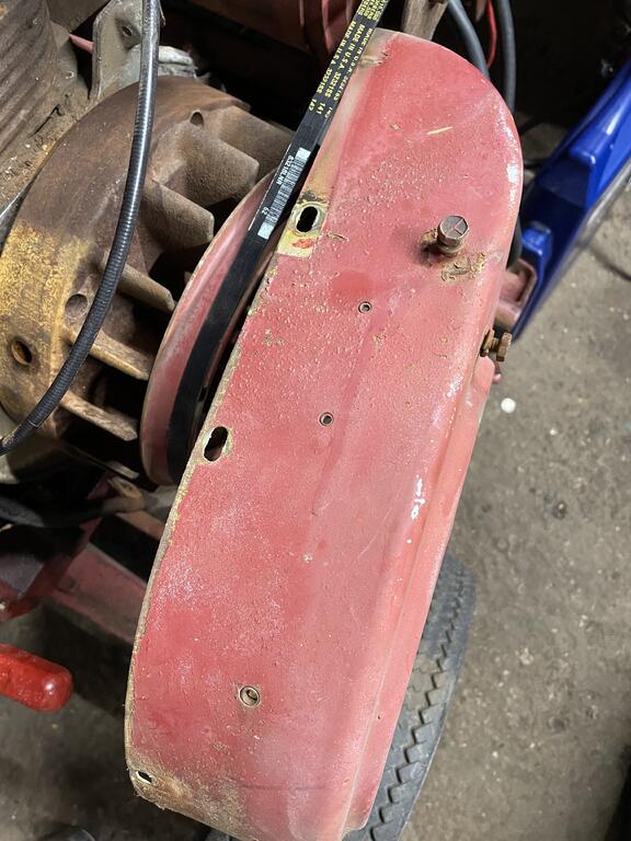

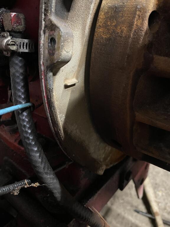

BHunter 1,702 #32 Posted January 10, 2022 There isn’t a sight hole in this shroud or in my 8hp with a Starter/Generator. There is a timing mark on the bearing plate but nothing on the flywheel. Share this post Link to post Share on other sites
oliver2-44 11,758 #33 Posted January 10, 2022 Correct me on this if I'm wrong, but with the flywheel key at top dead center the line on the bearing plate should be aligned with your TDC mark on the flywheel. 1 Share this post Link to post Share on other sites
953 nut 69,544 #34 Posted January 10, 2022 9 hours ago, oliver2-44 said: with the flywheel key at top dead center the line on the bearing plate should be aligned with your TDC mark on the flywheel Keyway on the output shaft too. 1 Share this post Link to post Share on other sites

pfrederi 21,172 #36 Posted January 10, 2022 Don't ask why but the sight hole is on the rear of the shroud for S/G..There should be a corresponding mark on the rear of the bearing plate. 1 Share this post Link to post Share on other sites

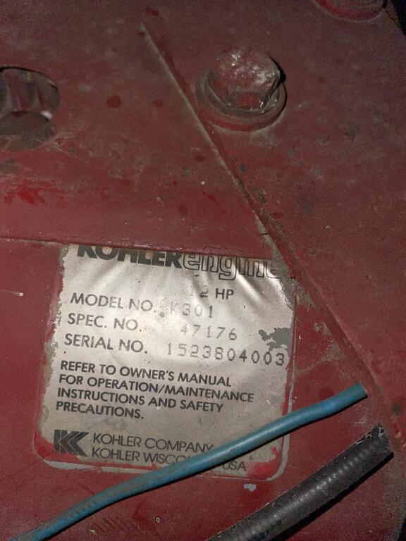

WHX?? 58,214 #37 Posted January 10, 2022 (edited) 15 hours ago, BHunter said: I still might put an external coil on and ditch the magneto. I like being able to easily access the ignition system if there is a problem. That gets my vote Bob. From your vid sounds like she may be starving for fuel. Have you cleaned the carb yet? 15 minutes ago, pfrederi said: the sight hole is on the rear of the shroud for S/G.. But given what was done to this motor all bets are off. Flywheel might have been changed or who knows. Set the points at .20 and tweak from there. Looking at your other pics looks like you still have the orginal battery to switch wires so if you got one of Lowell's 70 amp switches should be plug & play. Care full of the spinning flywheel with the shroud off Bob. No loose clothing ....don't want to see anything bad happen. Edited January 10, 2022 by WHX?? 2 Share this post Link to post Share on other sites

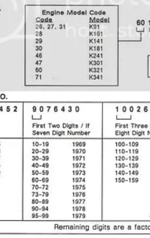

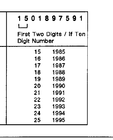

WHX?? 58,214 #38 Posted January 10, 2022 (edited) FYI Bob the engine dates to '85 and a quick look at the master product list shows no mention of that spec # being used. In 85 anyway. '85 I also thought would have a ring gear on the flywheel. Maybe that spec did not have electric start??? The mystery deepens. Did find this tho on a PDF search ....... no mention of that spec in a 301 that WH used but those all year lists have been know to be off. Edited January 10, 2022 by WHX?? Share this post Link to post Share on other sites

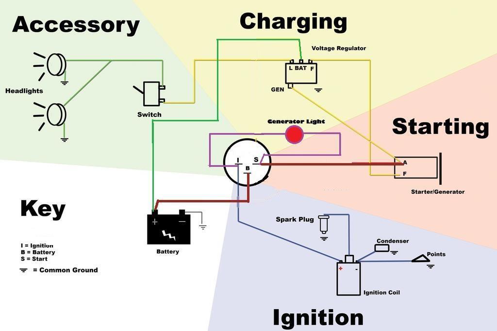

WHX?? 58,214 #39 Posted January 10, 2022 (edited) 'Nuts wiring diagram that I would use. I'll let him preach about good grounds! Edited January 10, 2022 by WHX?? 1 Share this post Link to post Share on other sites

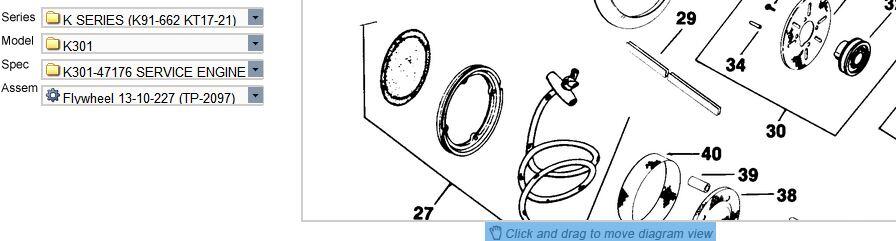

pfrederi 21,172 #43 Posted January 10, 2022 (edited) Spec 47176 Was a Service Engine. No ring gear and no charging stator. Just a mag coil and points... No starter just a rope no longer available Edited January 10, 2022 by pfrederi 1 1 Share this post Link to post Share on other sites
BHunter 1,702 #44 Posted January 10, 2022 1 hour ago, WHX?? said: FYI Bob the engine dates to '85 and a quick look at the master product list shows no mention of that spec # being used. In 85 anyway. '85 I also thought would have a ring gear on the flywheel. Maybe that spec did not have electric start??? The mystery deepens. Did find this tho on a PDF search ....... no mention of that spec in a 301 that WH used but those all year lists have been know to be off. The search I found shows it to be a 1969. Share this post Link to post Share on other sites
WHX?? 58,214 #45 Posted January 10, 2022 30 minutes ago, pfrederi said: Spec 47176 Was a Service Engine. That explains alot! Where did you find that info??? ! Share this post Link to post Share on other sites
BHunter 1,702 #46 Posted January 10, 2022 1 hour ago, WHX?? said: 'Nuts wiring diagram that I would use. I'll let him preach about good grounds! I agree. I’m going to use Nuts’ diagram and start from scratch. 2 Share this post Link to post Share on other sites
pfrederi 21,172 #47 Posted January 10, 2022 53 minutes ago, WHX?? said: That explains alot! Where did you find that info??? ! Kohler"s web site for parts.... 1 1 Share this post Link to post Share on other sites
