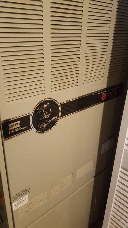

WHX?? 56,183 #2 Posted January 1, 2022 (edited) Prolly just an ignitor on the furnace. Reboot it and see if it glows. Also check the pressure switch. Pic or model of the furnace would help me fix it. Edited January 1, 2022 by WHX?? 1 Share this post Link to post Share on other sites

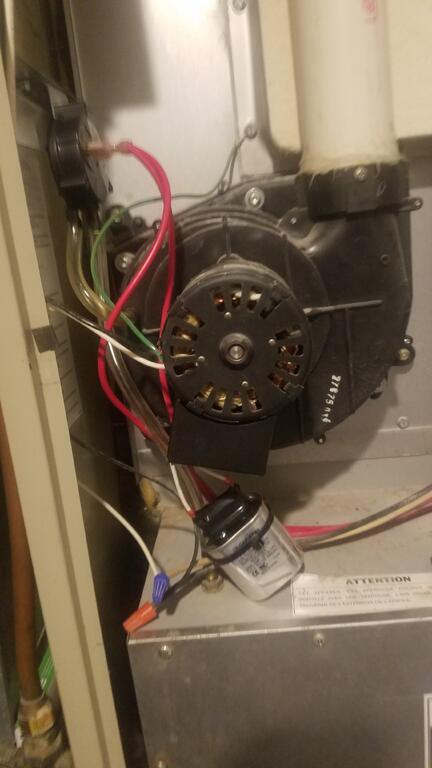

Yossarian 210 #3 Posted January 1, 2022 The exhaust fan kicks on, then a few clicks, fan keeps going for a bit the it starts over with the same thing a few times then quits. Also noticed that the LED blinks three times during the first attempt. Pressure switch stuck open. Share this post Link to post Share on other sites

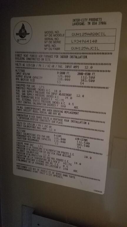

WHX?? 56,183 #4 Posted January 1, 2022 Thats an old girl .... 93 vintage so says the serial number. Must have alot of house as that's a125KBTU unit which is alot for a house these days. Might be time to consider a replacement as that was only an entry level unit and not known to work fine last a long time. Check the pvc intake exhaust for blockage if they check ok whack on the pressure switch to try and get it to close, or jumper it after the draft blower starts. Check the pressure switch hose for condensate & check the drain for blockage. Watch for the HSI glow through the sight glass or better yet just pull the burner box door off. eliminates a blocked intake pipe issue. Share this post Link to post Share on other sites
Yossarian 210 #5 Posted January 2, 2022 It's warm enough with the wood stove that I had to turn up the thermostat to keep testing the furnace. I do appreciate your time. This is one of the things I love about this forum. Haven't found any blockages yet. Checked the intake and exhaust. There are two lines off the pressure switch. The short one to the fan had a very small amount of condensate and kind of sloppy fit. Took care of those issues. Per advice on another site I blew lightly into the line and could hear the diaphragm click. I'll mess with it more tomorrow. It's really nice to have that option. Share this post Link to post Share on other sites

Yossarian 210 #13 Posted January 3, 2022 @WHX??, turns out I wasn't going to find the issue on my own. But I sure do appreciate the help and knowledge. A bad capacitor was making the inducer run weak and the PS was also bad. Got a new igniter as well. They cleaned the burners and checked out the heat exchanger. All that needed done anyway. All that to say, I like redundancy again. Not a single cold night and I avoided a weekend emergency call that wouldn't have fixed it anyway since they had to go get a PS to fit. Share this post Link to post Share on other sites
WHX?? 56,183 #14 Posted January 3, 2022 18 minutes ago, Yossarian said: cleaned the burners and checked out the heat exchanger Always a good Idea there. Was the tech able to replace just the cap or the whole inducer? Share this post Link to post Share on other sites
Yossarian 210 #15 Posted January 3, 2022 Replaced the capacitor I guess. 1 Share this post Link to post Share on other sites
WHX?? 56,183 #16 Posted January 6, 2022 Been there done that... which is good.... cap is cheap ventor is $$$ Share this post Link to post Share on other sites
