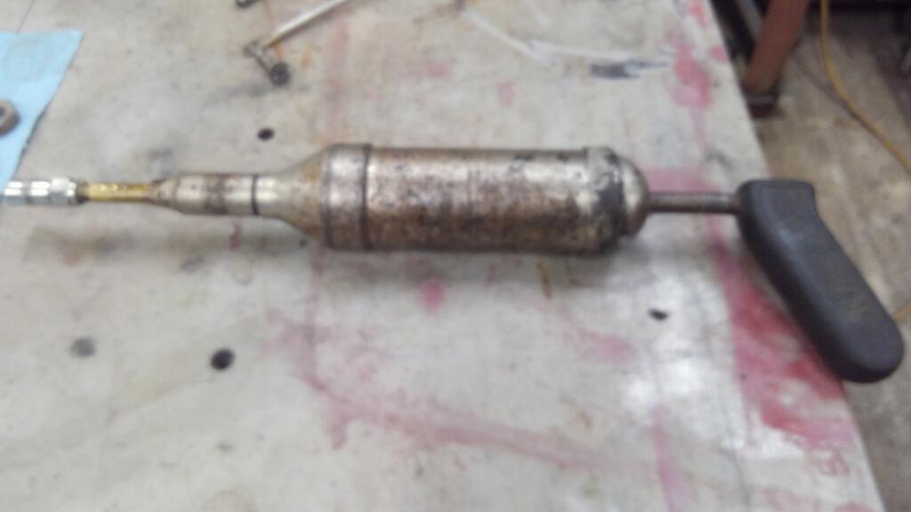

JPWH 6,544 #5 Posted January 3, 2022 This is the grease gun I will be using for the 00 grease. Estate sale find for $3.00. Never seen one before but after cleaning and changing the tip it works great. 1 1 Share this post Link to post Share on other sites
