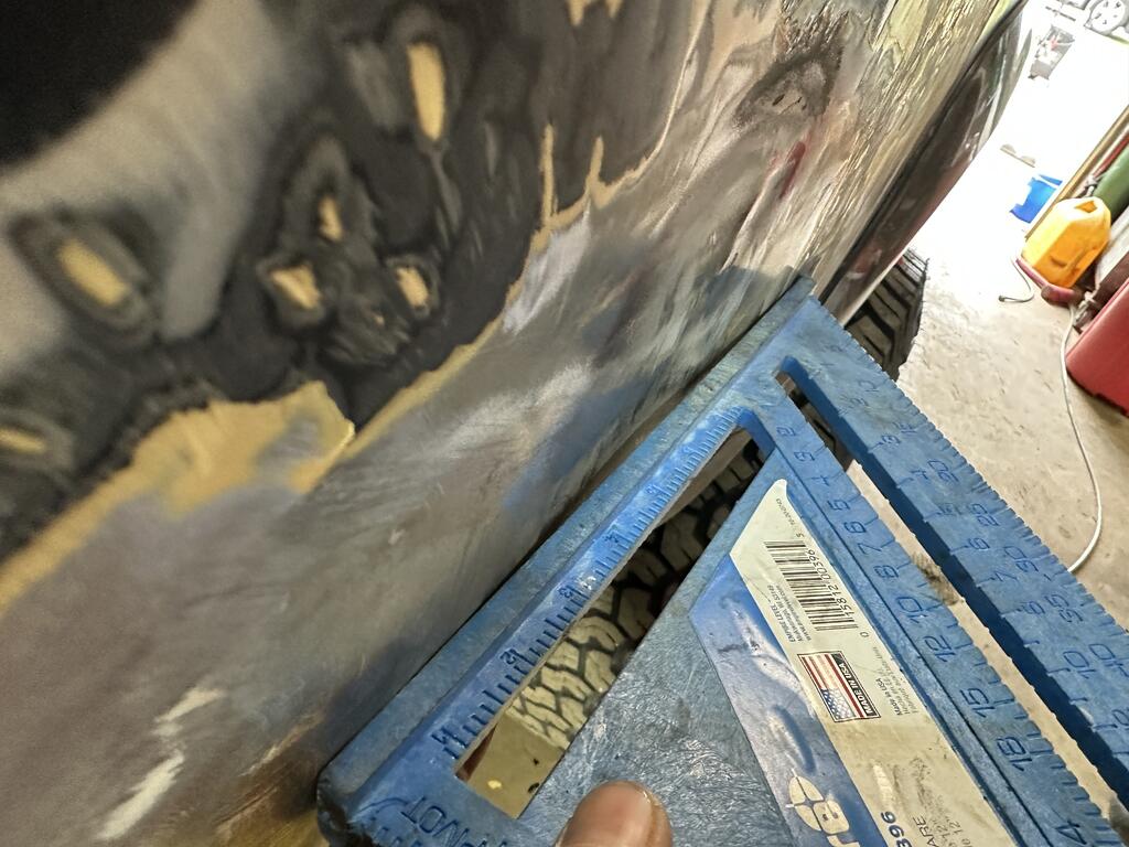

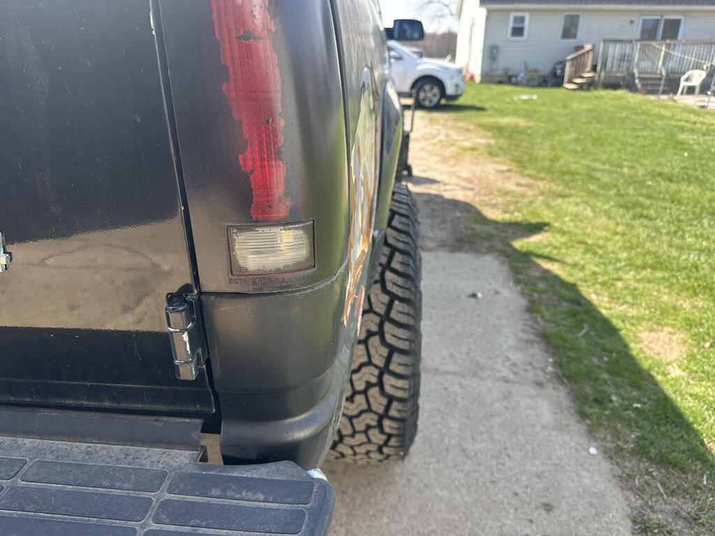

Pullstart 69,790 #53 Posted April 24, 2025 This weekend is Prom and Jada is driving her date We did a quick spray bomb last night. It’s better than it was. It’s nowhere near perfect! 4 3 Share this post Link to post Share on other sites

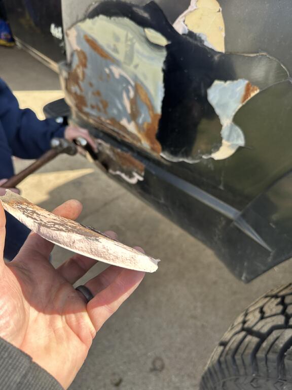

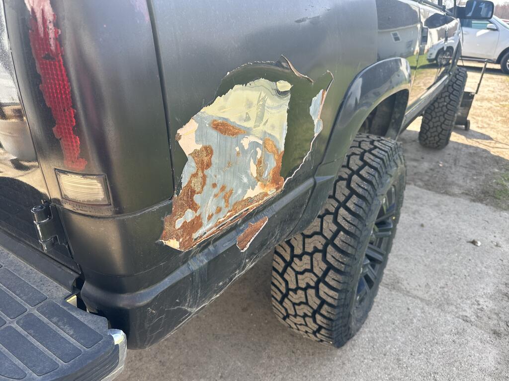

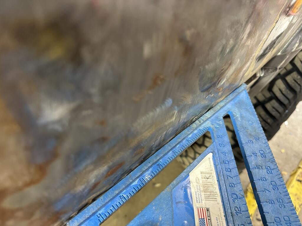

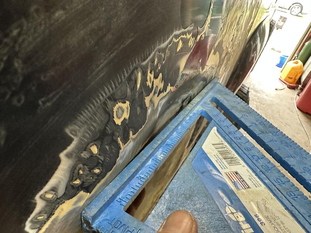

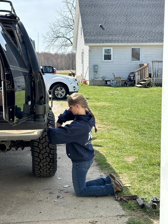

Pullstart 69,790 #54 Posted April 24, 2025 Here is some of what we went through to pull that quarter panel out. The bondo in one area was 3/4” thick! It mostly popped off that initial bare spot by itself. I sent Jada to work with a hammer and a puddy knife to pop the rest of the big stuff off. Then, we cleaned up some with a roloc disc, then wet sanded 220 grit. This is not the final product, just clean enough for the weekend date night. 5 3 Share this post Link to post Share on other sites

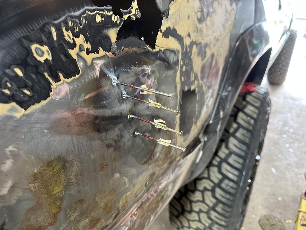

8ntruck 8,786 #55 Posted April 24, 2025 What did you pull on the nails with? Share this post Link to post Share on other sites
Pullstart 69,790 #56 Posted April 24, 2025 25 minutes ago, 8ntruck said: What did you pull on the nails with? slide hammer on vice grips 2 1 Share this post Link to post Share on other sites

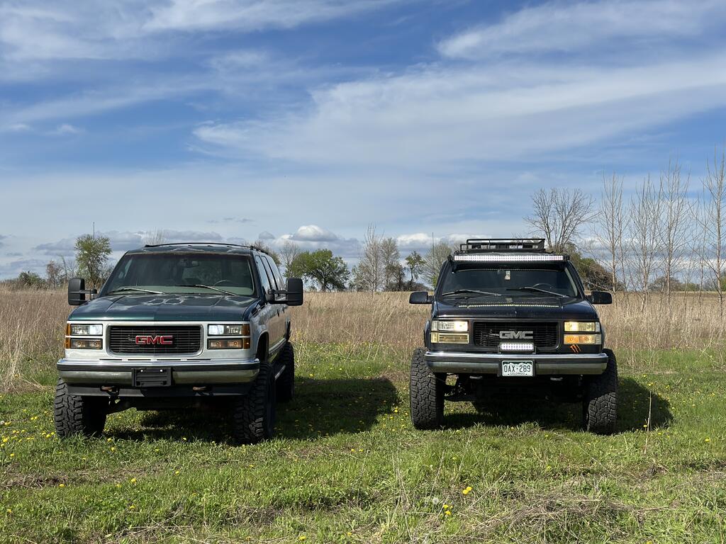

Pullstart 69,790 #61 Posted May 1, 2025 Apparently, this whole working on your own vehicles thing is really getting somewhere with the kids. I’ll start another thread for Rylee’s project, but Jada has been involved in this truck, her pickup, and now last night she bought another Suburban, for winter use! She changed her oil and helped me do her front brakes, before getting ready for prom last weekend. 2 2 Share this post Link to post Share on other sites

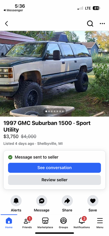

Pullstart 69,790 #62 Posted May 1, 2025 Then she made an offer to this seller a bit under asking price and he didn’t blink an eye about it. She now has a clean summer truck and a little bit rusty winter truck! 1 1 Share this post Link to post Share on other sites

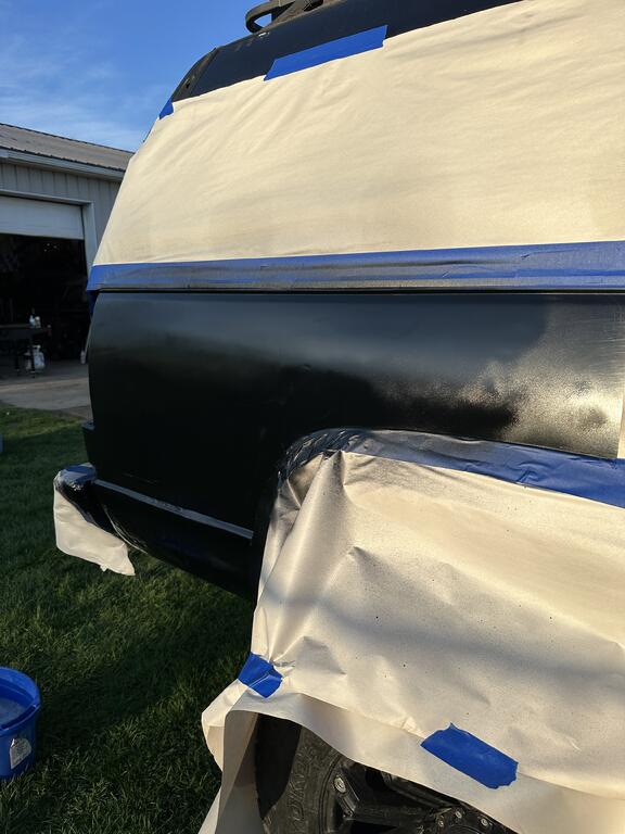

Pullstart 69,790 #64 Posted May 1, 2025 We also got the gloss black spray bombed onto the quarter on one of the nice afternoons last week, then set a little electric heater fan up underneath in the shop for the night. 1 Share this post Link to post Share on other sites
