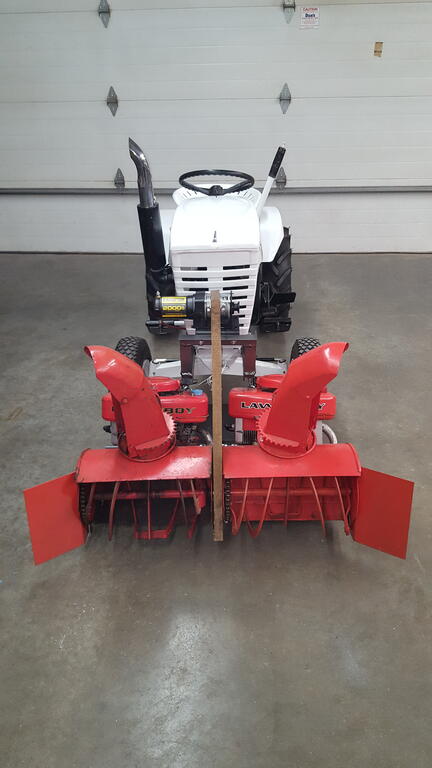

Gregor 4,848 #1 Posted December 29, 2021 Things you won't see everyday on a tractor. Casper is complete, once again. He even grew a tail? Probably has more wire on it than any 656 in the world, with maybe the exception of @Tractorhead's "Bavarian Wheel Horse". I think he's got some extra gadgets on his. 2 10 Share this post Link to post Share on other sites

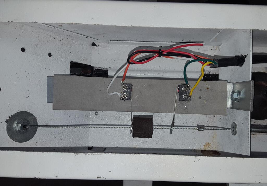

Gregor 4,848 #4 Posted December 29, 2021 9 minutes ago, Maxwell-8 said: Why did he wanted a tail? Flies ! Actually, that's not true. It doesn't even swish. It's part of how the limit switches work. The switch actuator is on a 1/16" cable. The cable is drawn tight, by a spring in the tail. The cable is drawn tight, by a spring in the tail. The cable moves about 2 1/2" as the snowblower goes up and down 1 7 Share this post Link to post Share on other sites

Gregor 4,848 #6 Posted December 29, 2021 47 minutes ago, AMC RULES said: Needs another stack! That actually gave me an idea. This little Tecky is a single cylinder of course, but...........I have one of these, And I have one of these.... Now if I just had 2 of these..............I could have.......... 1 of theses..... 9 Share this post Link to post Share on other sites
