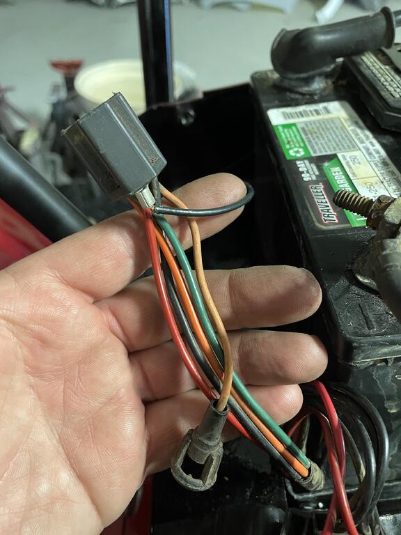

BHunter 1,702 #76 Posted January 26, 2022 Does anyone know where this black wire from the ignition switch harness goes? It’s around 2 feet long. The label I had on it fell off. It’s a 1978 c141 thanks 1 Share this post Link to post Share on other sites

rjg854 13,408 #78 Posted January 26, 2022 56 minutes ago, BHunter said: Does anyone know where this black wire from the ignition switch harness goes? It’s around 2 feet long. The label I had on it fell off. It’s a 1978 c141 thanks If that plug hooks to the ignition switch directly, what is the initial on the terminal that wire aligns with? That should tell you where the wire goes. 3 Share this post Link to post Share on other sites
BHunter 1,702 #79 Posted January 26, 2022 17 minutes ago, rjg854 said: If that plug hooks to the ignition switch directly, what is the initial on the terminal that wire aligns with? That should tell you where the wire goes. Thanks. I will check that. 1 Share this post Link to post Share on other sites

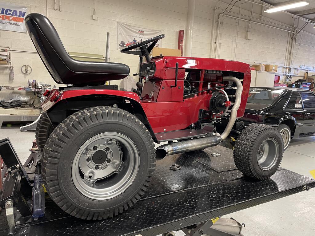

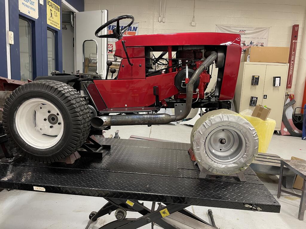

BHunter 1,702 #80 Posted February 3, 2022 Made some good progress this week. Installed the dash and hood, got it running, painted front wheels and started making a side pipe exhaust from an old motorcycle exhaust system 3 7 1 Share this post Link to post Share on other sites
953 nut 70,058 #81 Posted February 3, 2022 On 1/26/2022 at 5:39 PM, BHunter said: Does anyone know where this black wire from the ignition switch harness goes? It’s around 2 feet long. The label I had on it fell off. It’s a 1978 c141 thanks Probably goes to the PTO switch. Is there a small female spade connector on the other end? 2 Share this post Link to post Share on other sites
8ntruck 9,368 #82 Posted February 3, 2022 Coming along nicely. I like the side pipe. 1 1 1 Share this post Link to post Share on other sites
Lee1977 7,807 #83 Posted February 3, 2022 1 hour ago, 953 nut said: Probably goes to the PTO switch. Is there a small female spade connector on the other end? There is a wiring diagram in the manuals section. as 953 nut said, It goes to PTO switch connects with the black going to the seat switch Then the b;ack wire come back connect with the other side of the same safety switch. The diagram is just listed a 1978-1981 C wiring diagram there 5 different ones there. 1 Share this post Link to post Share on other sites
BHunter 1,702 #84 Posted February 3, 2022 19 minutes ago, Lee1977 said: There is a wiring diagram in the manuals section. as 953 nut said, It goes to PTO switch connects with the black going to the seat switch Then the b;ack wire come back connect with the other side of the same safety switch. The diagram is just listed a 1978-1981 C wiring diagram there 5 different ones there. Thanks. I’ll look for the diagram. 1 Share this post Link to post Share on other sites

Pullstart 71,482 #88 Posted February 3, 2022 That side pipe… wow. ❤️. Awesome stuff Mr. Hunter! Tell your class they should all be proud of their achievements! 2 Share this post Link to post Share on other sites
BHunter 1,702 #89 Posted February 3, 2022 1 hour ago, Pullstart said: That side pipe… wow. ❤️. Awesome stuff Mr. Hunter! Tell your class they should all be proud of their achievements! Thank you. I will tell them you said so. The exhaust turned out pretty cool. We kept cutting up the old pipe and figuring out what bends would get us to our goal. It’s not pretty but it has character. That’s what I like about it. 3 Share this post Link to post Share on other sites
ebinmaine 81,047 #90 Posted February 3, 2022 1 hour ago, BHunter said: We kept cutting up the old pipe and figuring out what bends would get us to our goal. It’s not pretty but it has character. That’s what I like about it. Excellent learning method. Try it. Nope. Try it. Nope. Try it.... Hey there ya go!!! The character is exponentially better too because it was earned. 1 1 Share this post Link to post Share on other sites
SylvanLakeWH 32,776 #91 Posted February 3, 2022 1 hour ago, BHunter said: Thank you. I will tell them you said so. The exhaust turned out pretty cool. We kept cutting up the old pipe and figuring out what bends would get us to our goal. It’s not pretty but it has character. That’s what I like about it. Very cool look! And it will “heat treat” the rear tire when it’s cold out… keep that rubber sticky plowing snow!!! 3 Share this post Link to post Share on other sites
BHunter 1,702 #92 Posted February 4, 2022 6 hours ago, ebinmaine said: Excellent learning method. Try it. Nope. Try it. Nope. Try it.... Hey there ya go!!! The character is exponentially better too because it was earned. I agree. It’s more rewarding when you earn it. It went just like you said. Nope..Nope … Yes, that’s it. 2 1 Share this post Link to post Share on other sites

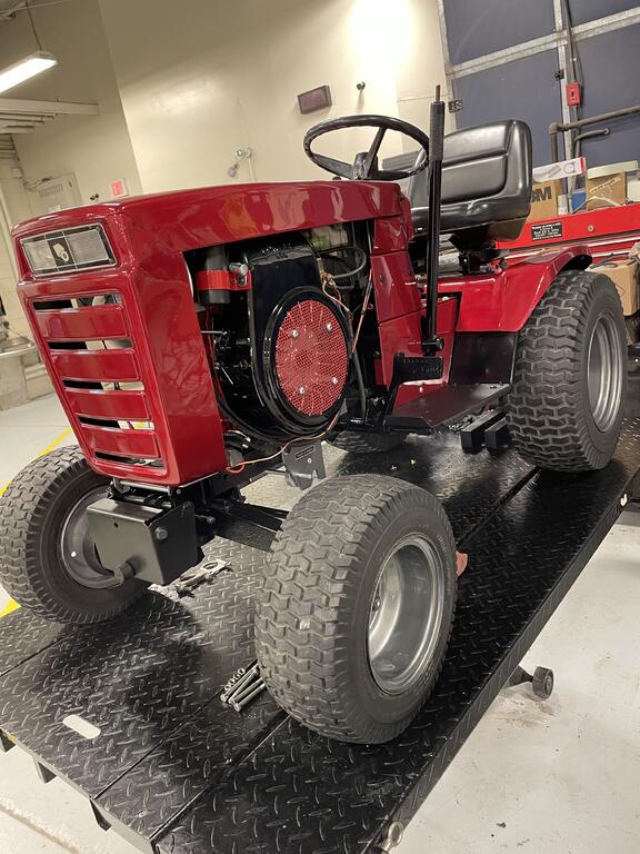

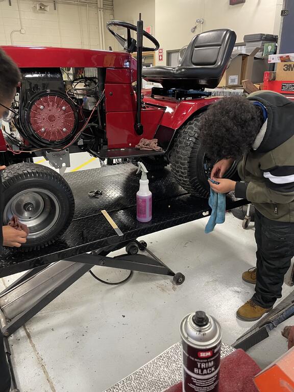

BHunter 1,702 #93 Posted February 11, 2022 It’s almost finished. The boys are cleaning it up. 1 7 4 Share this post Link to post Share on other sites

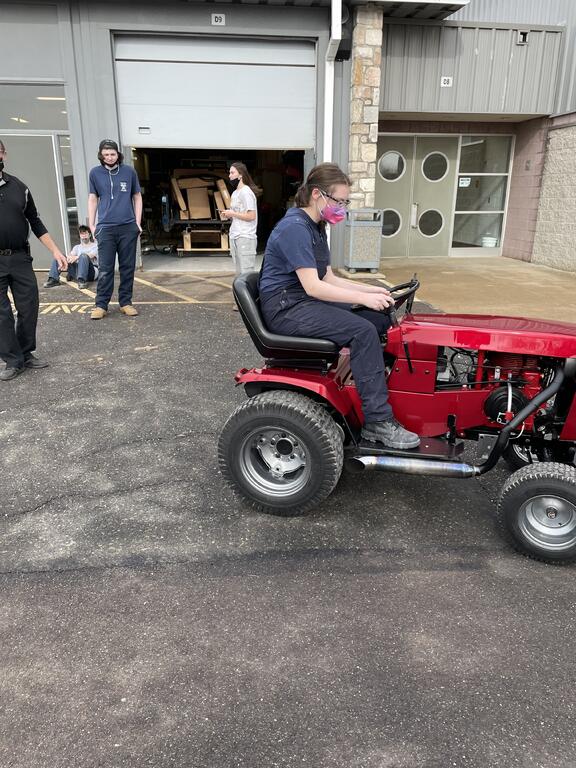

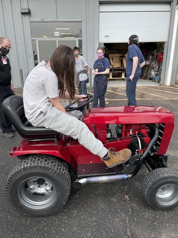

BHunter 1,702 #100 Posted February 18, 2022 The test drive went great. No problems. The kids really enjoyed the ride. They were smiling under their masks. They took lots of pictures of their accomplishment. Lasting memories. 9 Share this post Link to post Share on other sites
