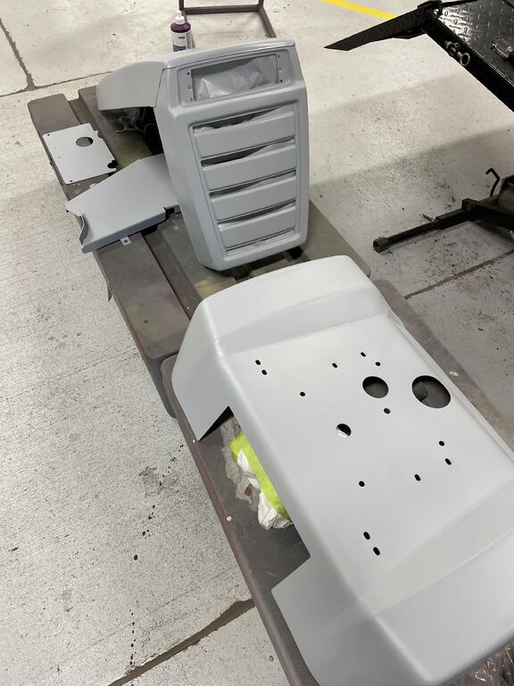

BHunter 1,702 #26 Posted December 22, 2021 We have reached the part that the students dislike the most, block sanding the primer surfacer. We are going to let them sit until after the holiday break , then sand and paint them. 5 4 Share this post Link to post Share on other sites

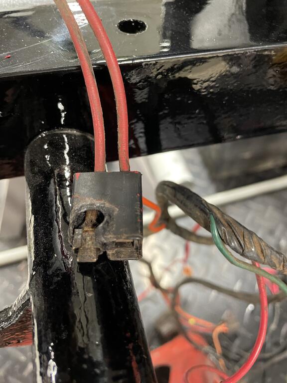

BHunter 1,702 #31 Posted December 22, 2021 I noticed this today as we were putting the engine back on the frame. Anyone know what would cause the plug to melt? These wires come from the coil behind the flywheel. I’m not sure what they plugged into until we do more assembling. 1 Share this post Link to post Share on other sites
Handy Don 17,634 #33 Posted December 22, 2021 (edited) Those wires are, I think, from the stator (you have point ignition, right, with a coil?) and deliver a lot of current. Some rust or corrosion in that connector causes resistance to the electric flow and that makes heat--LOTS of heat. Replace the connector, coat electrical bits with dielectric grease when re-installing or, ideally, replace with a waterproof 2-conductor connector of suitable capacity (40 amps or more) Edited December 22, 2021 by Handy Don 3 1 Share this post Link to post Share on other sites
BHunter 1,702 #34 Posted December 22, 2021 6 minutes ago, Handy Don said: Those wires are, I think, from the stator (you have point ignition, right, with a coil?) and deliver a lot of current. Some rust or corrosion in that connector causes resistance to the electric flow and that makes heat--LOTS of heat. Replace the connector, coat electrical bits with dielectric grease when re-installing or, ideally, replace with a waterproof 2-conductor connector. I do have a point ignition system with external coil. I meant to say stater behind the flywheel. I guess it plugged into the rectifier. I will try to find a connector. There are 3 prongs on the rectifier. 1 Share this post Link to post Share on other sites
953 nut 70,058 #35 Posted December 23, 2021 1 hour ago, BHunter said: Anyone know what would cause the plug to melt? A few years back @Save Old Iron did a post on the subject of corrosion on electrical components, I saved his explanation. Think about it - if you forced a sudden surge of lets say 35 amps thru a 30 amp fuse - the fuse internal element slowly "melts" - usually within a few seconds - you see a melted wire in the fuse body and the fuse body and leads remain looking like they originally did ( give or take a little). If you dead shorted the battery thru the fuse to the chassis, you may blacken the inside of the fuse but the fusible element melts long before you have a chance to cook the entire fuse body like in your picture. Same idea for the white plastic engine harness connector - the brown discoloration is from cooked plastic - where is the heat coming from ?? The "Molex" style connectors used in this tractor series are in a harsh, corrosive environment. Vibration causes the connections to loosen - corrosion starts within the metal terminals and a voltage drop develops across the corrosion. If you have a 10 amp current flowing across a 1 ohm resistance (contact corrosion) the electronics formula to calculate power = current squared times resistance so 10 amps x 10amps x 1 ohm resistance = 100 watts !! 100 watts of connector heating is the same as laying a 100 watt soldering iron on the connector. 2 1 Share this post Link to post Share on other sites
BHunter 1,702 #36 Posted December 23, 2021 1 hour ago, 953 nut said: A few years back @Save Old Iron did a post on the subject of corrosion on electrical components, I saved his explanation. Think about it - if you forced a sudden surge of lets say 35 amps thru a 30 amp fuse - the fuse internal element slowly "melts" - usually within a few seconds - you see a melted wire in the fuse body and the fuse body and leads remain looking like they originally did ( give or take a little). If you dead shorted the battery thru the fuse to the chassis, you may blacken the inside of the fuse but the fusible element melts long before you have a chance to cook the entire fuse body like in your picture. Same idea for the white plastic engine harness connector - the brown discoloration is from cooked plastic - where is the heat coming from ?? The "Molex" style connectors used in this tractor series are in a harsh, corrosive environment. Vibration causes the connections to loosen - corrosion starts within the metal terminals and a voltage drop develops across the corrosion. If you have a 10 amp current flowing across a 1 ohm resistance (contact corrosion) the electronics formula to calculate power = current squared times resistance so 10 amps x 10amps x 1 ohm resistance = 100 watts !! 100 watts of connector heating is the same as laying a 100 watt soldering iron on the connector. Thanks for posting this info . It really makes sense. I didn’t consider checking my connections because the tractor ran fine and the battery stayed charged. The terminals were badly corroded. I’m glad I took it all apart this winter to restore it. Now it will be in good shape for doing it’s chores in the spring. Does anyone make a complete wire harness for a C series? 2 Share this post Link to post Share on other sites
953 nut 70,058 #37 Posted December 23, 2021 12 hours ago, BHunter said: Does anyone make a complete wire harness for a C series? You can make your own harness. The folks at Del City https://www.delcity.net/store/Packard-56-Series-Electrical-Connectors/p_9108 have all the proper connectors and terminals that were used on the factory floor at . You can also get them at NAPA or other good auto parts stores. A few spools of colored wire and a good pair of crimpers and you will be in business. I would suggest doing one wire at a time so there is no confusion. 2 Share this post Link to post Share on other sites

peter lena 10,103 #40 Posted December 24, 2021 @BHunter your wiring issue is a common failure point , replaced a lot of wiring , easy just to re do with much better connective points , use wire / cable wrap , to prevent wire chafe , reroute tight spots , cap off and tape end areas , install , nylon hanger loops as you go . question , did you re grease the needle bearing in that pto cone ? requires a hi temp grease , just a careful wipe out and a small amount of grease is needed , excess will fling onto clutch face , avoid that . also detail in that pto lever for fit and lubrication , add washers on the end / starting point , next to battery , typically 3/8" or more of washers to firm it up along with chassis grease lube , makes it very solid and smooth , pete 2 Share this post Link to post Share on other sites
BHunter 1,702 #41 Posted December 24, 2021 1 hour ago, peter lena said: @BHunter your wiring issue is a common failure point , replaced a lot of wiring , easy just to re do with much better connective points , use wire / cable wrap , to prevent wire chafe , reroute tight spots , cap off and tape end areas , install , nylon hanger loops as you go . question , did you re grease the needle bearing in that pto cone ? requires a hi temp grease , just a careful wipe out and a small amount of grease is needed , excess will fling onto clutch face , avoid that . also detail in that pto lever for fit and lubrication , add washers on the end / starting point , next to battery , typically 3/8" or more of washers to firm it up along with chassis grease lube , makes it very solid and smooth , pete Hi Pete . I plan to redo the wiring and try to make it nice like you suggested. I didn’t grease the bearing but I will now. I never knew about that. I’m also going to add washers to the lever. Thanks for the tips. Much appreciated. Bob 2 Share this post Link to post Share on other sites

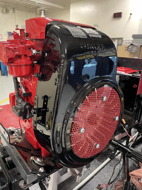

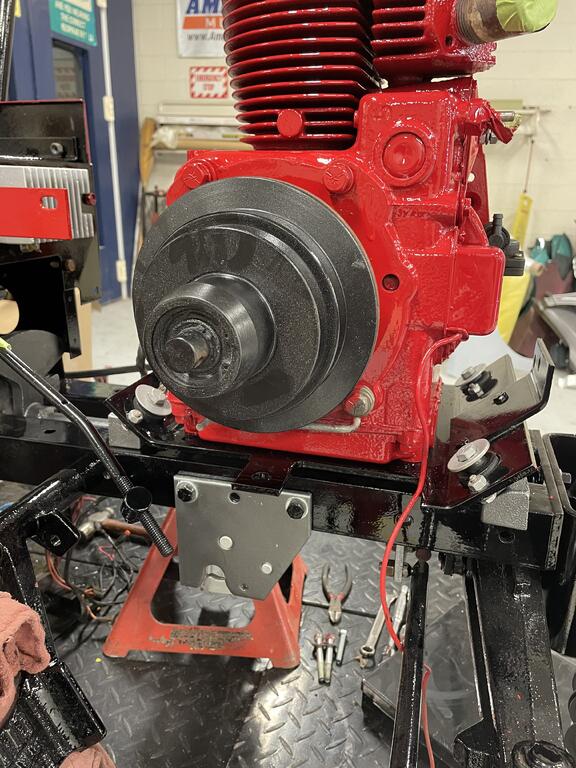

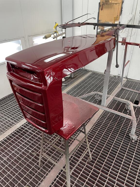

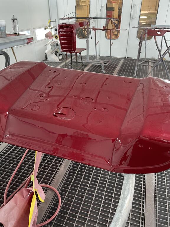

BHunter 1,702 #42 Posted January 11, 2022 We made some progress today. Installed the k321 shroud and painted some of the panels. 1 15 1 Share this post Link to post Share on other sites
SylvanLakeWH 32,776 #43 Posted January 11, 2022 Looks beautiful!!! 1 1 Share this post Link to post Share on other sites
Gregor 4,848 #44 Posted January 12, 2022 WOW ! A real paint booth ! What color is that? BEAUTIFUL 2 Share this post Link to post Share on other sites
BHunter 1,702 #45 Posted January 12, 2022 52 minutes ago, Gregor said: WOW ! A real paint booth ! What color is that? BEAUTIFUL Candy apple red Thanks 1 Share this post Link to post Share on other sites
AMC RULES 37,260 #46 Posted January 12, 2022 Just needing some hand painted pinstripes and engine turned gold leafing now. 1 Share this post Link to post Share on other sites
BHunter 1,702 #47 Posted January 12, 2022 2 minutes ago, AMC RULES said: Just needing some hand painted pinstripes and engine turned gold leafing now. I agree. I wish I had those skills. My hands aren’t steady enough for that. 2 Share this post Link to post Share on other sites
