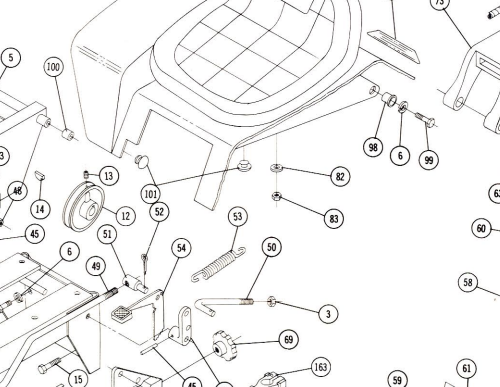

Wheelhorse#1 1,976 #1 Posted December 17, 2021 (edited) Anyone have any idea what these rubber bumpers are called ? They sit under the rear fender pan for vibration and cushion ,I recon. I need to replace them.Thx pic Edited December 17, 2021 by Wheelhorse#1 1 Share this post Link to post Share on other sites
Achto 32,476 #2 Posted December 17, 2021 Wheel horse part #5667 One source for them. https://wheelhorsepartsandmore.com/product/5667-toro-wheel-horse-grommet/ 5 1 Share this post Link to post Share on other sites

kpinnc 18,916 #9 Posted December 17, 2021 1 hour ago, ebinmaine said: Don't think mine has any. Probably were worn right off before I got it. I'll have to check that out.... I think my 867 uses 2 of those on the fender. Sure makes it close smoother too! Share this post Link to post Share on other sites
Achto 32,476 #10 Posted December 17, 2021 11 minutes ago, kpinnc said: I think my 867 uses 2 of those on the fender It should have 4 of them on the rear fender. 2 where it sets on the center counsel and 2 on each side where it slides over the counsel. Number 101 on the diagram 2 1 Share this post Link to post Share on other sites
