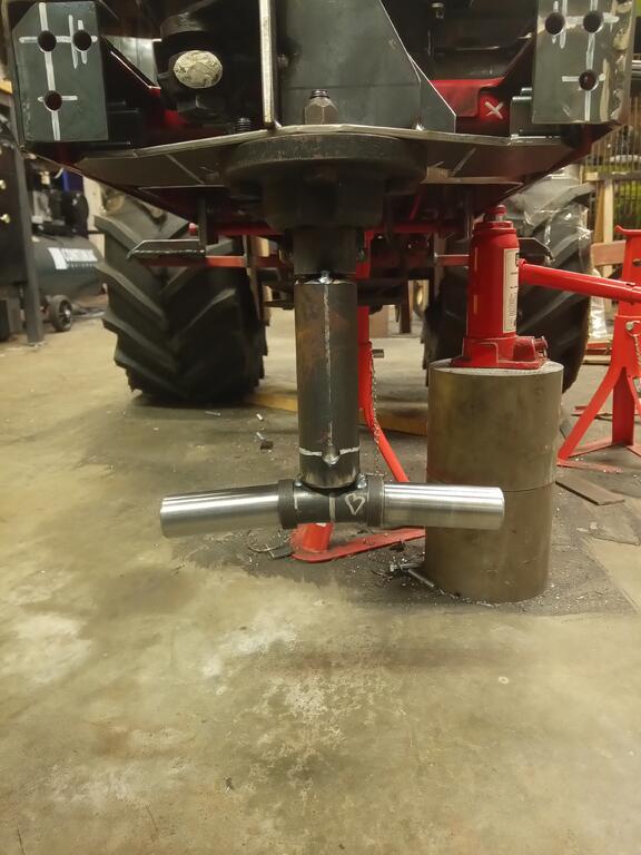

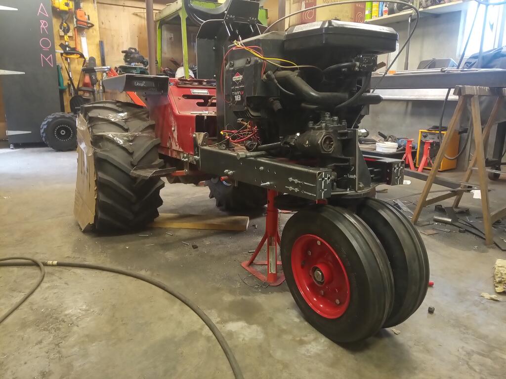

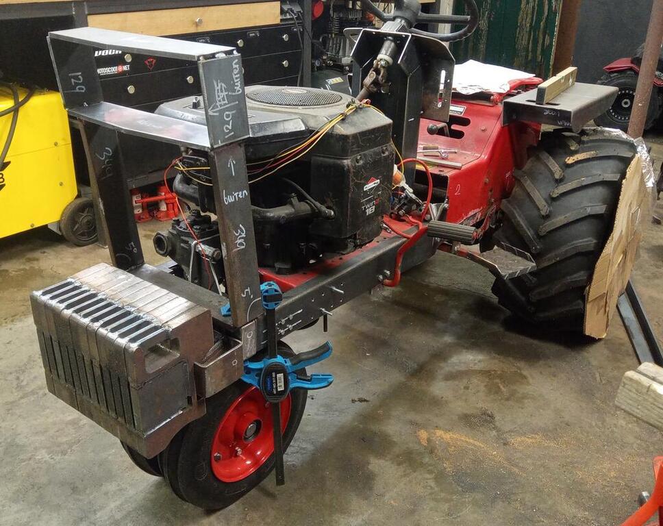

@953 nut Sweet build, I really like it. It seems we think alike. I also built my front spindle with a trailer hub and axle. Pictures will follow.
Only difference is that I mounted the steering box in the front of the tractor. Mainly to have room for a gastank but also because of not wanting to have a linkage on the outside of the tractor.

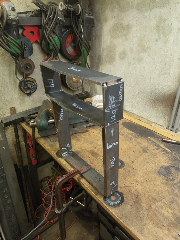

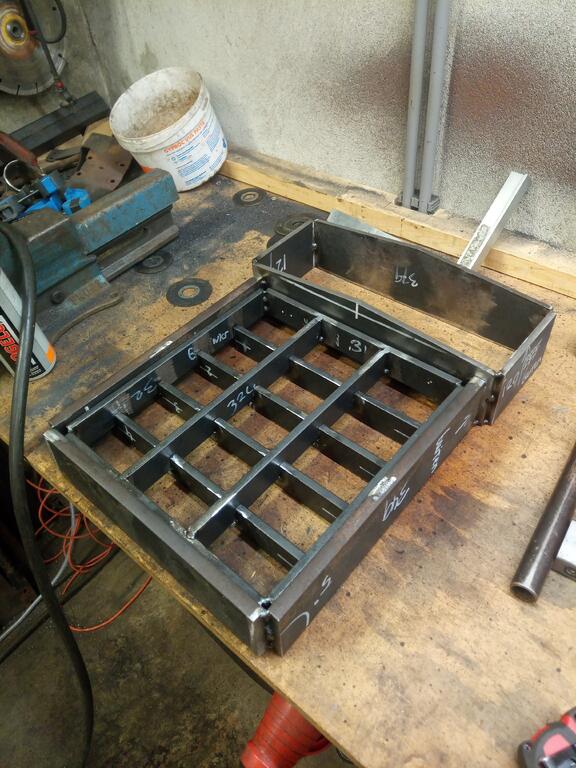

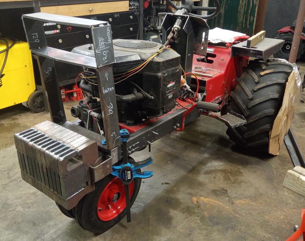

Gotta say one thing fer sure sjoemie you are one heck of a fabricator! Those weights are awesome and the rest of your pieces look like they grew there! :handgestures-thumbupright:
  • Thanks 1
sjoemie himself
@WHX?? Thank you very much!
I always try to do things right and make them as good as I can. There is already lots of garbage being produced in the world today. No need for me to add to that pile.. although the term 'garbage' is debatable I guess 😁

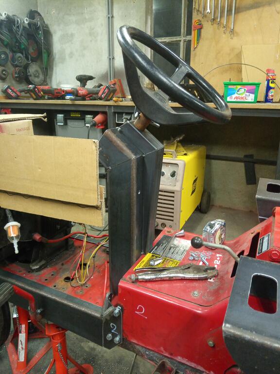

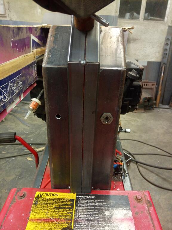

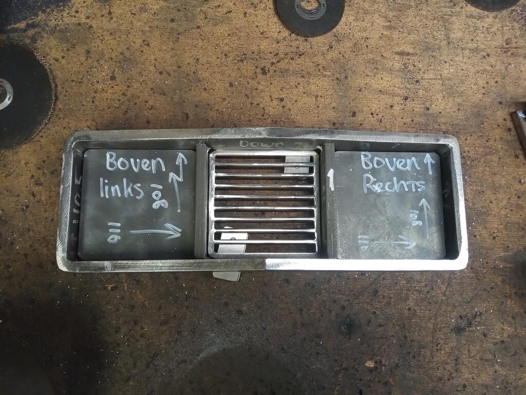

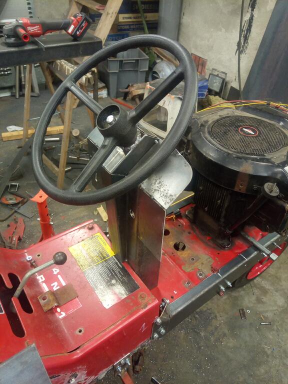

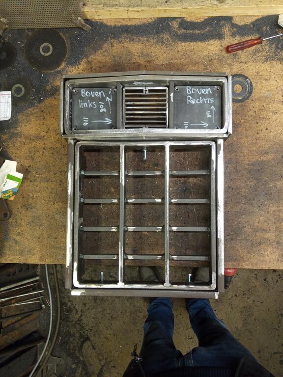

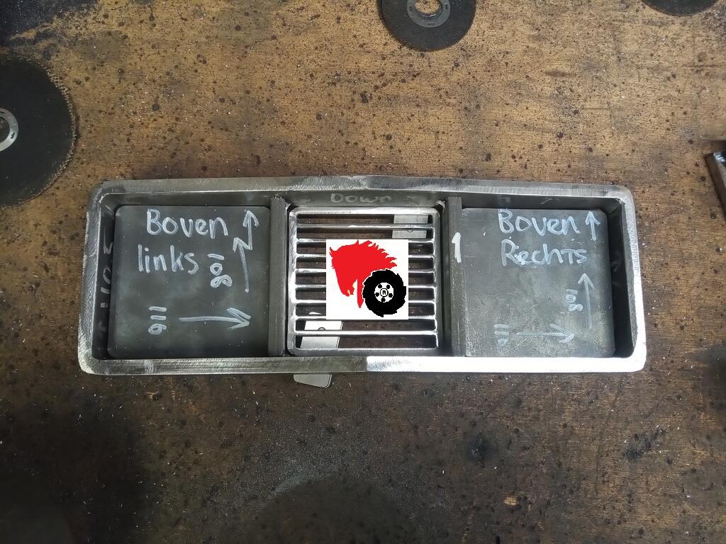

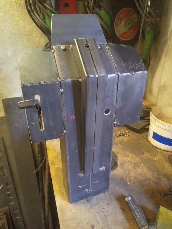

Next up, steering console and dash. Tried to model this to the real dash while incorporating the controls and ignition switch from the Murray. Gauges will be added later when I decide what I want/need.

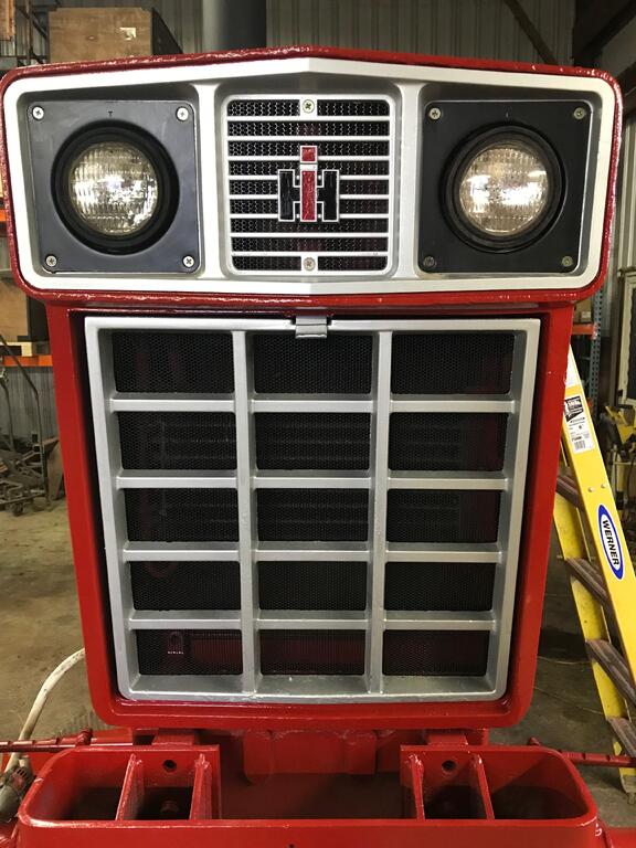

@6wheeler thank you. Although i'm an IH/Case/Farmall fan I have to admit that the 14/1568's were not the best tractors. However they are really cool and different looking and that's why I like them.
Another reason why I chose to build it is because the Murray has a flat twin in it so it lends itself for dual stacks just like the 1468.

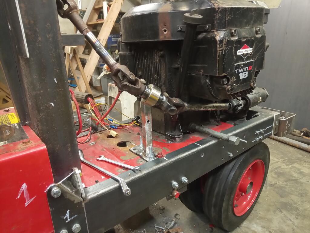

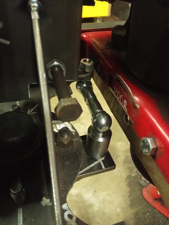

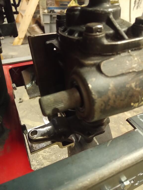

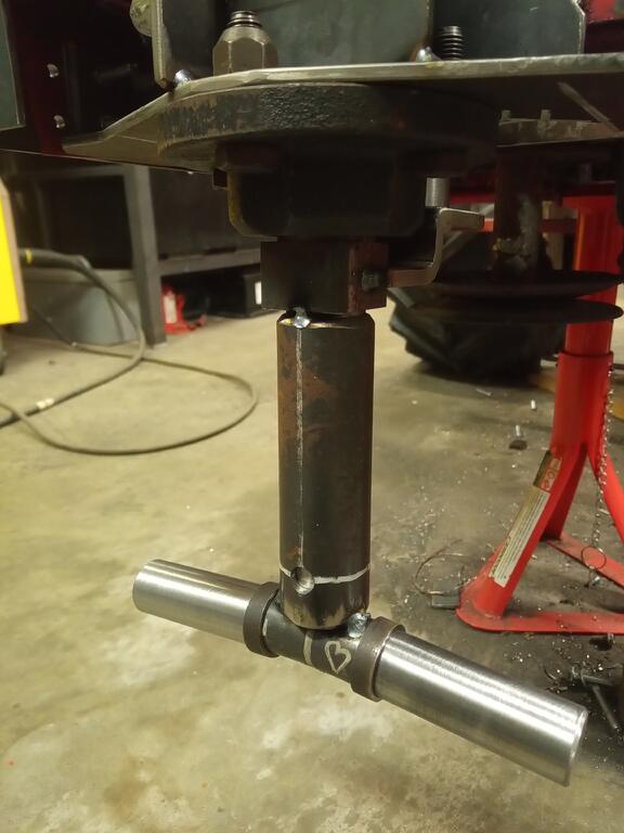

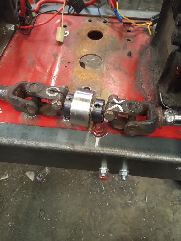

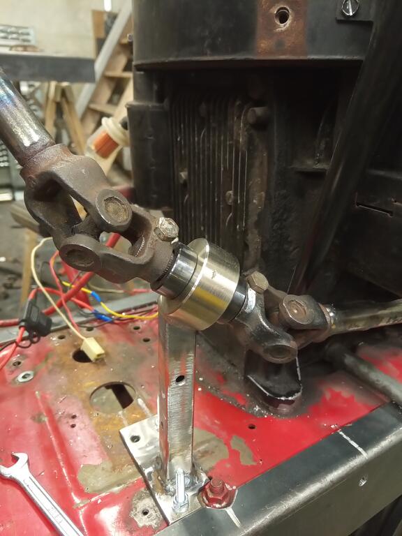

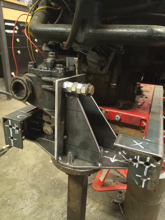

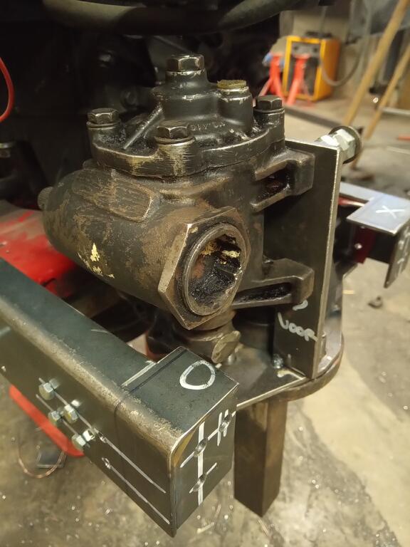

Next up I worked on the steering box. Unfortunately I don't have too many pictures of that. It was quite a search to find a steering box that would fit my needs. First I got a box off of a Toyota 4 x 4 which turned out way to big. Then I looked at using a steering rack out of a Opel (or Vauxhall as you might know them). That didn't work and/or got way to complicated.
Finally I bought a steering box from an old VW Beetle type 1302 which was the ticket.

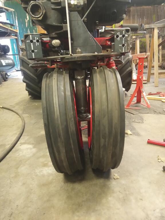

Started working on the mountings for it (don't mind the stack of nuts, that will be changed) and used a trailer stub axle as a pivot for the narrow front like @953 nut suggested.
Everything is setup at an angle to (hopefully) get correct steering geometry.
