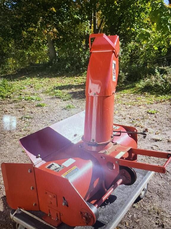

BeninCT 451 #7 Posted December 16, 2021 Ok finally got a picture of it to load. See it has a vertical pulley for the belt. Seems silly to ask because you are clearly and encyclopedia of info here but want to make sure because this thing is seriously mint! @gwest_ca @peter lena Are you saying you are running this snowblower on a 312-8? Share this post Link to post Share on other sites
gwest_ca-(File Mod) 11,754 #8 Posted December 16, 2021 The model you need has a longer shaft up higher through the large holes in the frame. These often go for cheap because there is not much demand for them. The chute and auger will fit the model you need so a good way to update an older model if the price is right. 1 1 Share this post Link to post Share on other sites
peter lena 9,471 #9 Posted December 16, 2021 @BeninCT , this is the type of set up , that @gwest_ca was referring to . not familiar with yours , but the basic blower is the same . get on the hunt for parts , should be a relatively easy swap out , pete 1 Share this post Link to post Share on other sites

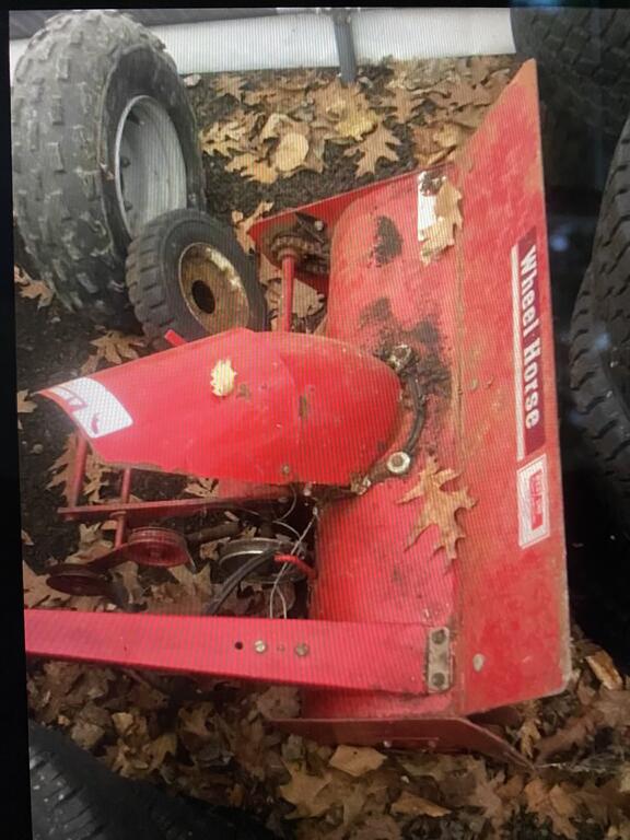

BeninCT 451 #10 Posted December 16, 2021 This also happens to be for sale but looks way worse than the other one. Based on what you are saying this looks to be correct and then if I understand you right, I could take the guts from the nice one (auger/bearings etc) and putt it in this to make a nice one? @peter lena @gwest_ca Thank you guys for taking the time to coach me here. I might go for the worse looking one for whatever I can chisel off his $200 asking price and see what it needs. 1 Share this post Link to post Share on other sites
Handy Don 14,716 #11 Posted December 16, 2021 The first one is for the 200 series vertical shaft engine models. The second one might be good, you'd need to confirm with the model number. It seems to have the correct mount for attachamatic and correct tensioner/idler pulleys. Has the short chute--preferred by some, shunned by others! This model used a wire cable wrapped around the chute and the adjusting crank arm to rotate the chute. A lot depends on what you cannot see here--condition of the bottom edge, the auger, and the bearings. Stored outside in the weather is not a good omen. 3 Share this post Link to post Share on other sites
peter lena 9,471 #12 Posted December 17, 2021 @Handy Don agree with you on the other blower pick up , as a parts spare its the deal , that short chute is good for my area , with a usual wet mix of snow , if I lived north in a dryer snow area the tall chute is the deal , also like the chute side gearing over the cable , both need set up and lubrication detailing to function correctly. also add a round knob on chute control lever , for easy action with mittens. good opportunity , pete 1 Share this post Link to post Share on other sites
