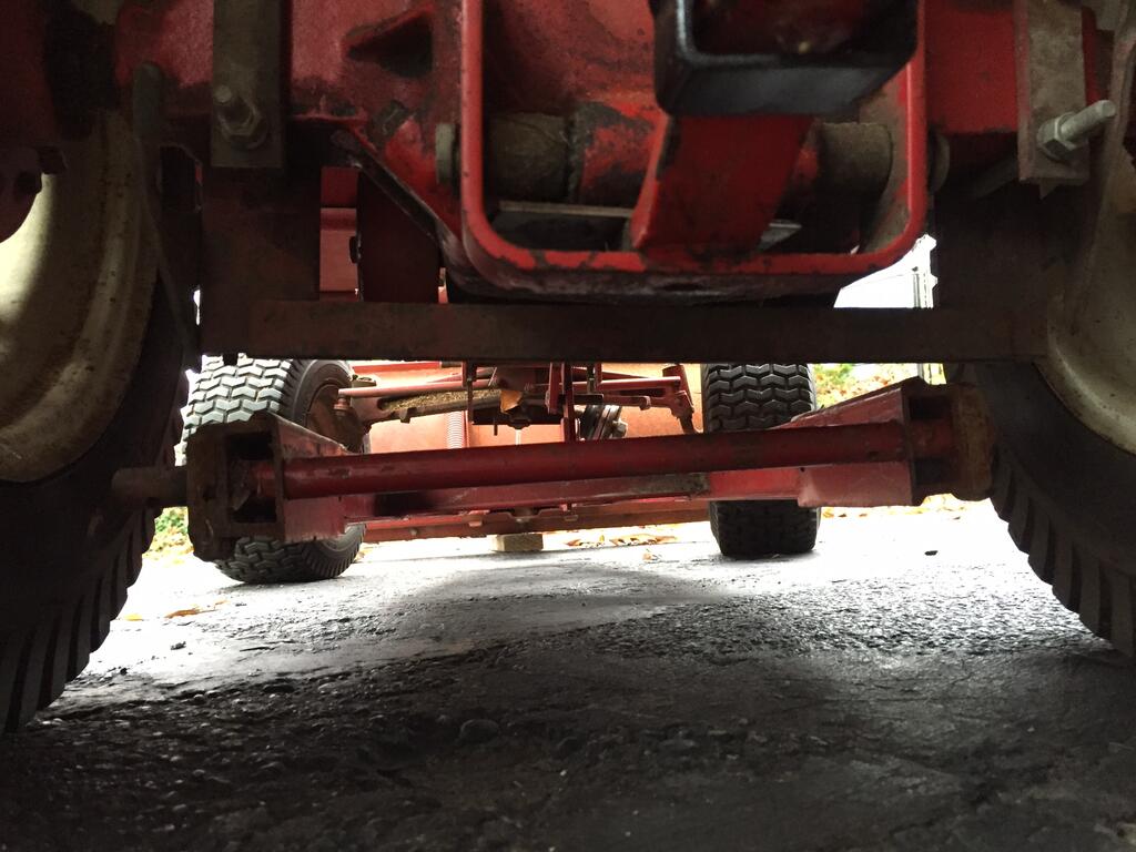

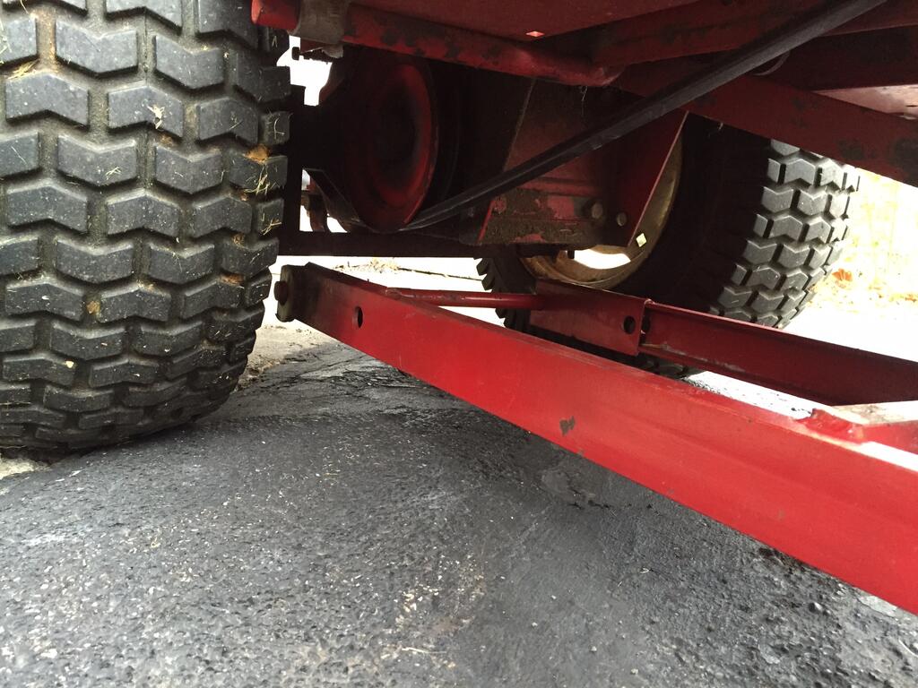

SylvanLakeWH 32,699 #4 Posted December 13, 2021 I ran my C105 with this old short frame bracket for years. The mounting bolts run parallel to the ground…obviously blade not hooked to bracket in these old photos… Previous owner had rigged up and modified blade as well. Worked fine. Same blade also works with the correct bracket as well…which is what I use now… Share this post Link to post Share on other sites
ebinmaine 80,937 #5 Posted December 13, 2021 3 minutes ago, SylvanLakeWH said: short frame bracket Now ya see that's more like what I have on the C160. I built that though. I did it to be able to use a trailer hitch that's bolts the same direction. Is a stock WH made short frame bracket that low to the ground? I thought they were closer to axle centerline which is my concern... I figured the plow would be too close to the tractor frame. Share this post Link to post Share on other sites
SylvanLakeWH 32,699 #6 Posted December 13, 2021 It looks “stock” but who knows… it’s older than dirt and pretty rough… still works though… 1 Share this post Link to post Share on other sites

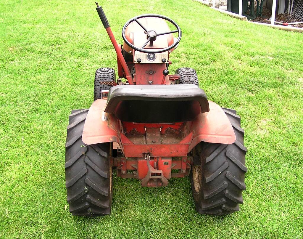

ri702bill 13,190 #9 Posted December 13, 2021 Here is a shot of the back of the 702 with its early plow mount... Share this post Link to post Share on other sites
