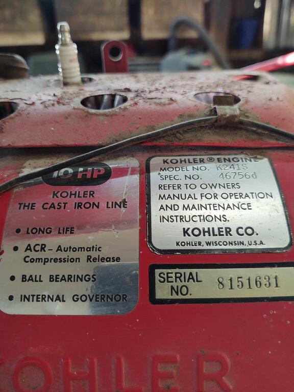

Joe 77 B100 84 #1 Posted December 13, 2021 I know there are places to find these details but I hoped you experts would be able to help. I wanna do a tuneup on my 1977 b100 8 speed. Oil type? Amount? There is very little oil in the rear trans. What kind of oil do I use in it? Anyone know what kinda carb I got and have a link to a video of a carb cleaning for it? I've watched lots of they are all different. 1 Share this post Link to post Share on other sites
Maxwell-8 4,371 #2 Posted December 13, 2021 SAE30 in the engine 80w90 in the tranny Just drop the bowl and blow trough the jets. Share this post Link to post Share on other sites
Gregor 4,848 #3 Posted December 13, 2021 https://www.kohler-engine-parts.opeengines.com/index.php?main_page=document_general_info&products_id=34596 Here is an owners manual and service manual for the engine. The trans, I know nuttin'. But I'm sure someone does 1 Share this post Link to post Share on other sites

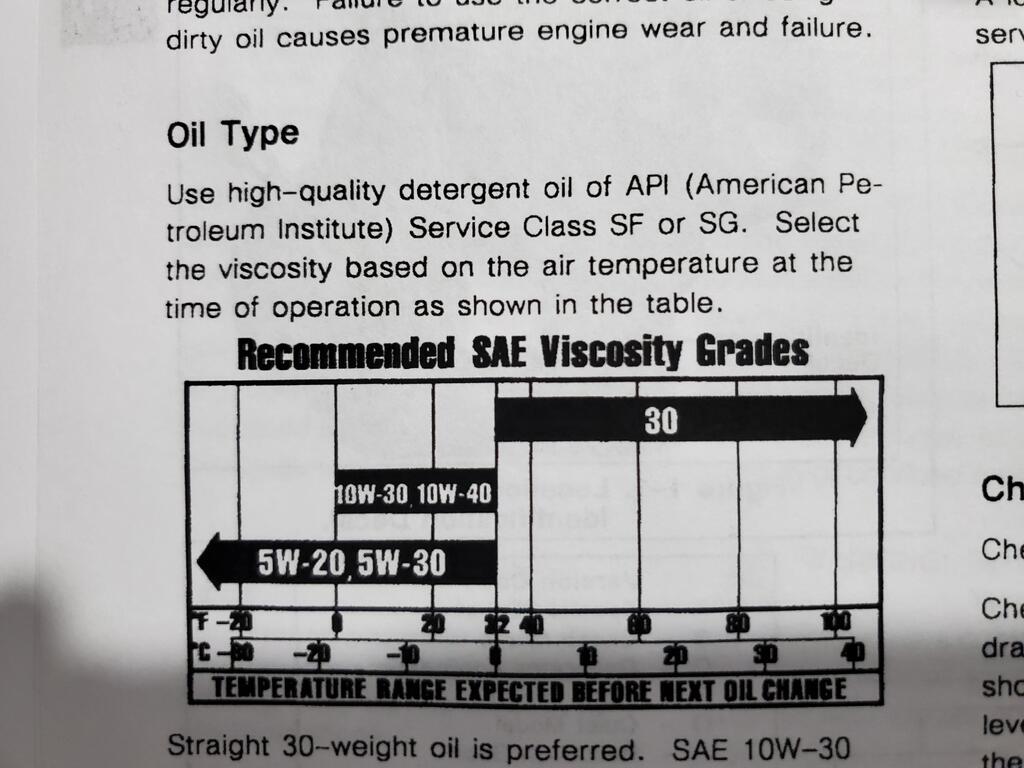

rmaynard 17,433 #6 Posted December 13, 2021 Drain what's left in the transmission. There is a 1/4" allen screw plug in the bottom near the hitch. Lift the front end to get the fluid that is in the front of the tranny. Refill with 2 quarts of 80/90W or similar gear oil. Engine uses non-detergent 30W oil. Replace spark plug gapped to .035. Replace points (.020) and condenser. Remove and clean carburetor. Install new float valve kit. Adjust according to the Kohler manual. Replace air filter. This is what I would do. I currently own a B-100 and have owned 4 of them over the years. Best looking tractor Wheel Horse ever made. 2 1 Share this post Link to post Share on other sites

Racinbob 13,046 #8 Posted December 13, 2021 Sorry Bob but Kohler specifically states detergent oil. Below freezing multi grades but I now use straight 30 in all my K's Share this post Link to post Share on other sites
