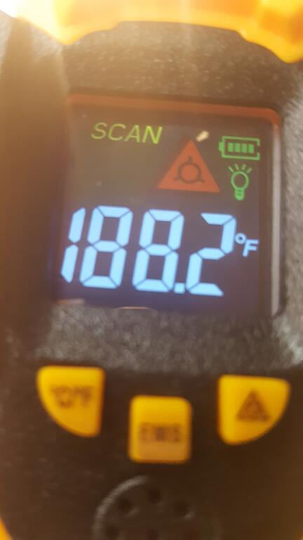

Gregor 4,848 #34 Posted December 13, 2021 (edited) The largest heat lamp bulb I could find was 250w. It's cooking. Does not seem to be hurting the paint. Edited December 13, 2021 by Gregor Share this post Link to post Share on other sites

Gregor 4,848 #38 Posted December 14, 2021 (edited) I could only find a 250w heat lamp, so I baked the painted piece for 1 hour. As you can see in the above post, the piece got up to 188F. I kept an eye on it, thinking it may damage the paint, but it never did. I took it outside to cool. Outside temp, ~46. When I brought it in, the piece was 54F. I couldn't poke my thumb nail into it as readily as before, but I could scratch it with my nail. I let it get up to room temp, 71F. That's where it sets now. Again, I cannot poke my thumb nail into it, but I can scratch it. I cannot go out and scratch the paint on my truck with my thumb nail. Thank God ! This piece is painted with single stage paint from a gun, on top of rattle can primer. Maybe it's not a fair test. I just got my parts back from the blaster today. Most of these parts will be primed, and top coated, with single stage paint, through a gun. I have to get them done before they start rusting up on me. After that, I will experiment more with rattle can paint, and a heat lamp. So far, it seems as though @Lee1977's heat lamp method may have some merit to it. Although I am not sure which is worse, soft paint, or paint that is easily scratched. If I take a piece that wasn't baked, it too will scratch, but it is softer, IMO anyway. I am not sure how you would bake an entire tractor up to 188F though. Just food for thought. Got curious again. The one tractor I have that my nephew (a real painter) painted, you cannot dig your nail into it or scratch it. The tractor I painted with base, and clear coated with a gun, you can, but it was primed with rattle cans. These tractors are not stored in a heated area. Edited December 14, 2021 by Gregor 1 Share this post Link to post Share on other sites
