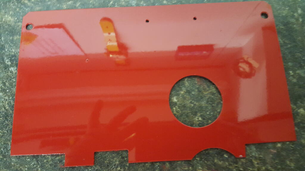

Lee1977 7,756 #2 Posted December 12, 2021 8 minutes ago, RED-Z06 said: What paint actually dries hard? Seems like its hard to get a paint that dries and is durable. Any pictures of the rustoleum regal red? Regal Red Painted around 2010. I paint in the middle of the summer and put it out side for three or four days in the sun. 4 Share this post Link to post Share on other sites

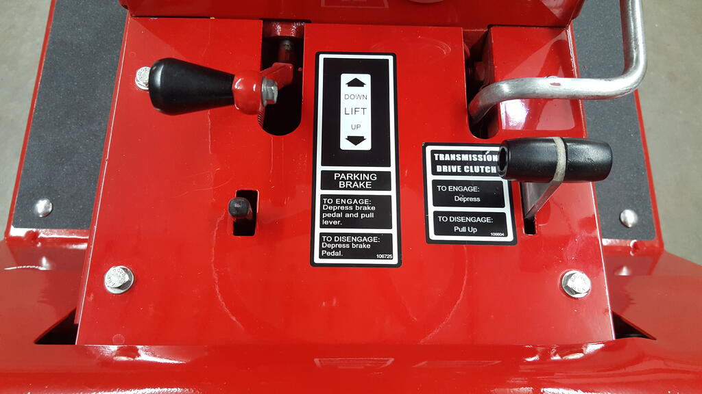

johnnymag3 2,646 #3 Posted December 12, 2021 Regal Red 2016 ......different hue Driers hard though 3 1 Share this post Link to post Share on other sites

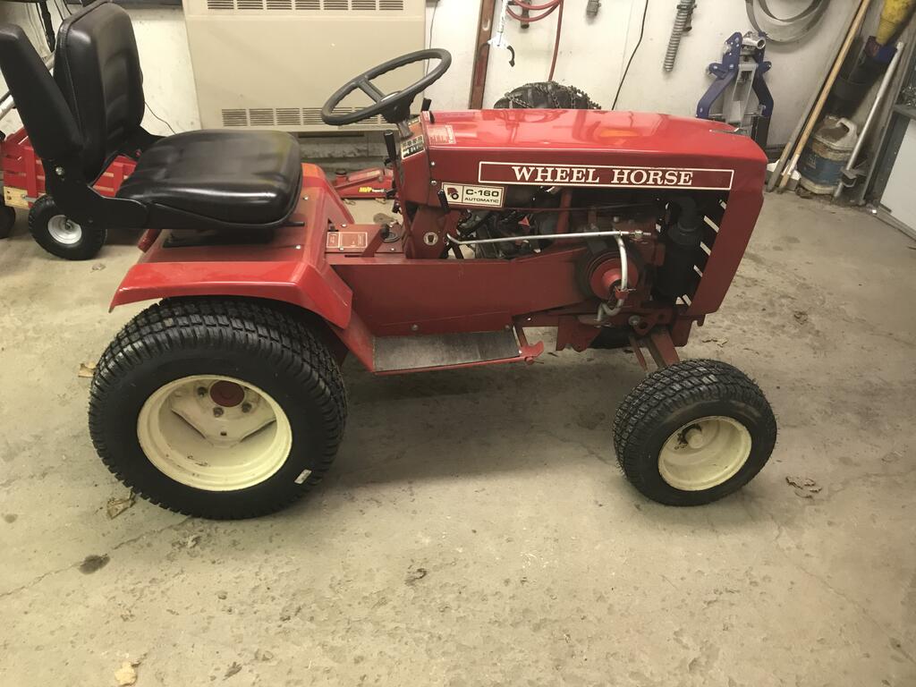

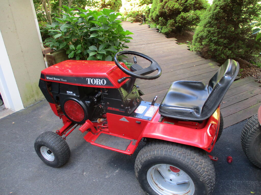

Pullstart 71,160 #4 Posted December 12, 2021 Regal Red, June of 2018. Rustoleum gray primer underneath. I wouldn’t say it’s super hard, but it would be easy to touch up. 3 1 Share this post Link to post Share on other sites

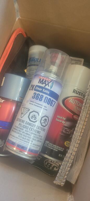

RED-Z06 2,720 #7 Posted December 12, 2021 24 minutes ago, Jeff-C175 said: Any rattle can is not going to be as hard as a spray gun with hardener finish, but it's reasonably durable. You could always pick it up in the can, get a Harbor Freight 'purple gun', add some hardener before you spray. OR... look into a " 2K CLEAR COAT " after your rattle can. 2k is good stuff...i have a can of clear satin i got when i was restoring a Homelite Wiz55 but cant find a cylinder for it 3 Share this post Link to post Share on other sites

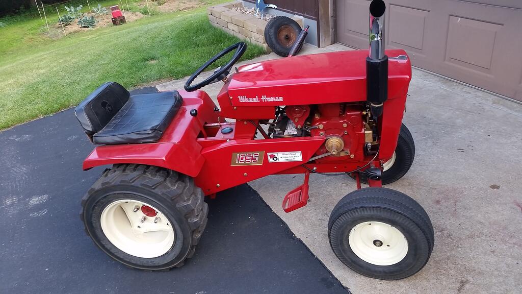

WHX?? 57,904 #17 Posted December 13, 2021 (edited) On this 1055 the hood was gunned by @Achto with Van Sickle in IH red. He did the fender pan too but during assembly I realized I'm a bone head prepped and painted the wrong pan so the right one I just rattle canned in regal. I didn’t prep it or anything cause I figured sometime Dan would have a can of Van Sickle open. Left the underside in primer.... just wanted to keep rolling with the project. The color match is dang near spot on ....regal might be a tad darker but not by much. Only real difference is the gloss and maybe abit of hardness. The belt guard was done in Van Sickle too. Rest of the tractor was rattled. Edited December 13, 2021 by WHX?? 4 Share this post Link to post Share on other sites

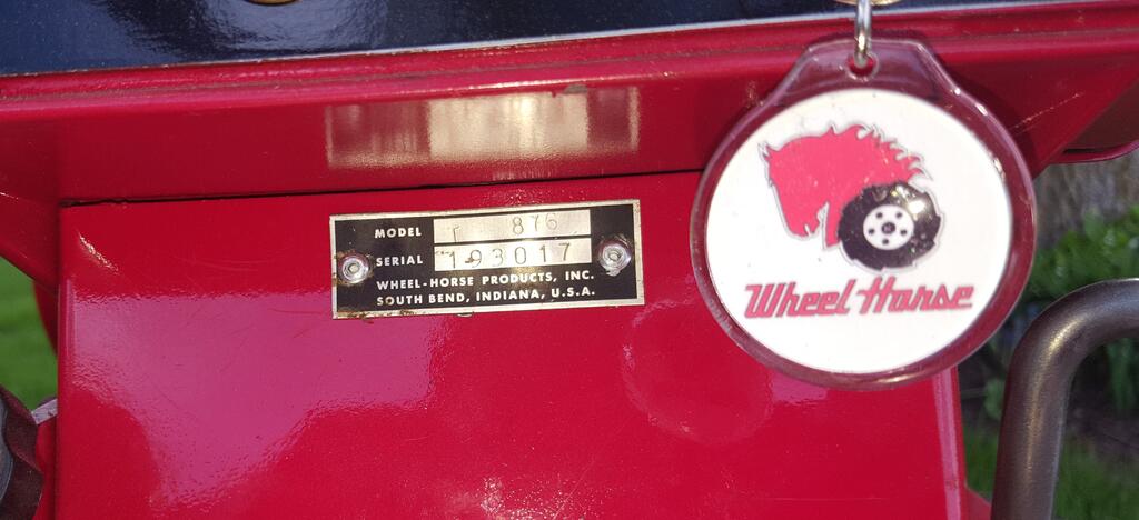

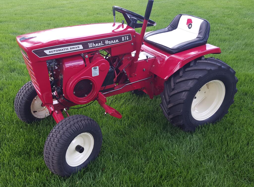

Gregor 4,848 #23 Posted December 13, 2021 I believe Chinese Red Lacquer dries harder than Regal Red. My biggest problem is finding a primer that dries as hard. The hardest paint on top of soft primer is still a problem. 2 8 Share this post Link to post Share on other sites
WHX?? 57,904 #24 Posted December 13, 2021 I've see that tractor before Greg...that seat is to die for! 1 Share this post Link to post Share on other sites
kpinnc 18,916 #25 Posted December 13, 2021 Gonna say the obvious: Greg that 876 is gorgeous! 1 Share this post Link to post Share on other sites
