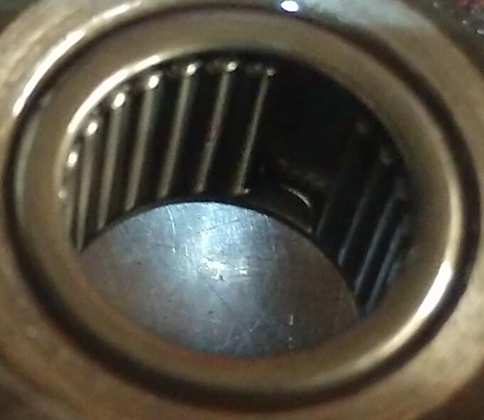

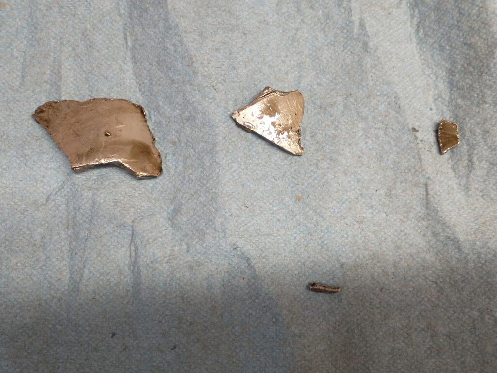

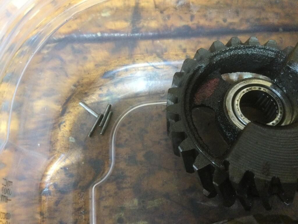

squonk 48,072 #14 Posted December 11, 2021 (edited) This is what was in my oil pan. Piston skirt and a gear needle: Piston out: Needle bearing after gear is out: Jeff one thing you can do that's easy and cheap is pull the head and see how much slop is in the piston. This vid shows mine before I took out the piston: Edited December 11, 2021 by squonk 1 Share this post Link to post Share on other sites

kpinnc 18,939 #16 Posted December 11, 2021 (edited) 7 hours ago, Gregor said: Pressed in what? The bearings are in the balance gears, and slide onto the shafts, or so I thought. The races are pressed in, but the needles aren't caged in the races. I assume that was to allow oil to reach the bearings easier. I guess mine weren't as worn as I thought, but I'm still glad to have them out. Edited December 11, 2021 by kpinnc 1 Share this post Link to post Share on other sites

moe1965 774 #19 Posted December 11, 2021 Thanks for all your info. I did a lot of reading up on the balance gears and if I read one article correctly you could get a brand new engine without them from a dealer and it wouldn't effect the warranty. Some were even assembled without them from the factory. I'm going to leave them out but do I need to remove these pins or just leave them in. Thanks again. 2 Share this post Link to post Share on other sites
kpinnc 18,939 #20 Posted December 11, 2021 (edited) Leave the pins. Won't affect anything at all, but they have to be there to seal the holes in the block. Edited December 11, 2021 by kpinnc 1 1 Share this post Link to post Share on other sites
Snoopy11 5,731 #21 Posted December 11, 2021 5 hours ago, squonk said: how much slop is in the piston Piston slop should cause smoke and lack of power. (not saying it will in every case, but overtime, these symptoms should accompany). Don Share this post Link to post Share on other sites
squonk 48,072 #22 Posted December 11, 2021 No smoke or power loss on my engine. Just noise 1 Share this post Link to post Share on other sites
Jeff-C175 7,211 #23 Posted December 11, 2021 4 hours ago, squonk said: No smoke or power loss on my engine. Just noise Same here. Share this post Link to post Share on other sites
