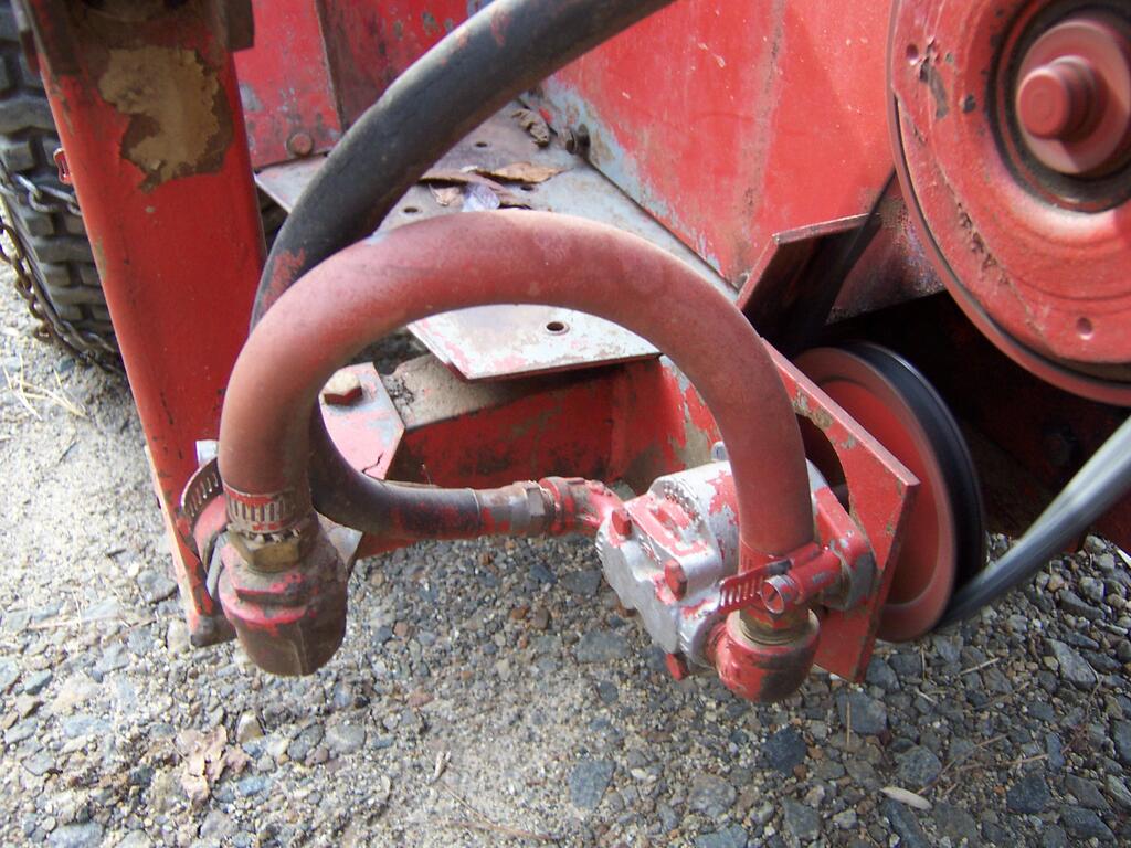

roadapples 6,987 #6 Posted December 10, 2021 Mine's factory. It's a Cessna. Best I can do... 1 Share this post Link to post Share on other sites

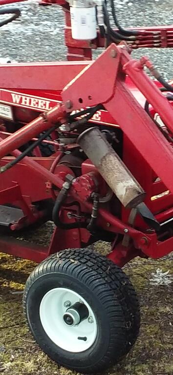

roadapples 6,987 #9 Posted December 10, 2021 Best I can do tonight. Muffler has been moved... Share this post Link to post Share on other sites
PetesPonies1 119 #10 Posted December 10, 2021 9 minutes ago, roadapples said: Best I can do tonight. Muffler has been moved... Thanks. What model is that?? Share this post Link to post Share on other sites
roadapples 6,987 #11 Posted December 10, 2021 550 Ark loader on a 74 C160. The pump is factory. Pretty sure it's a Cessna... Share this post Link to post Share on other sites

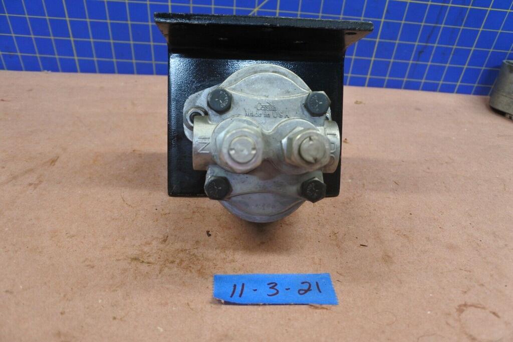

squonk 48,215 #13 Posted December 10, 2021 .5 Cu In. Pump on my Power King from the Surplus Center. Maybe give you some ideas. 3 Share this post Link to post Share on other sites

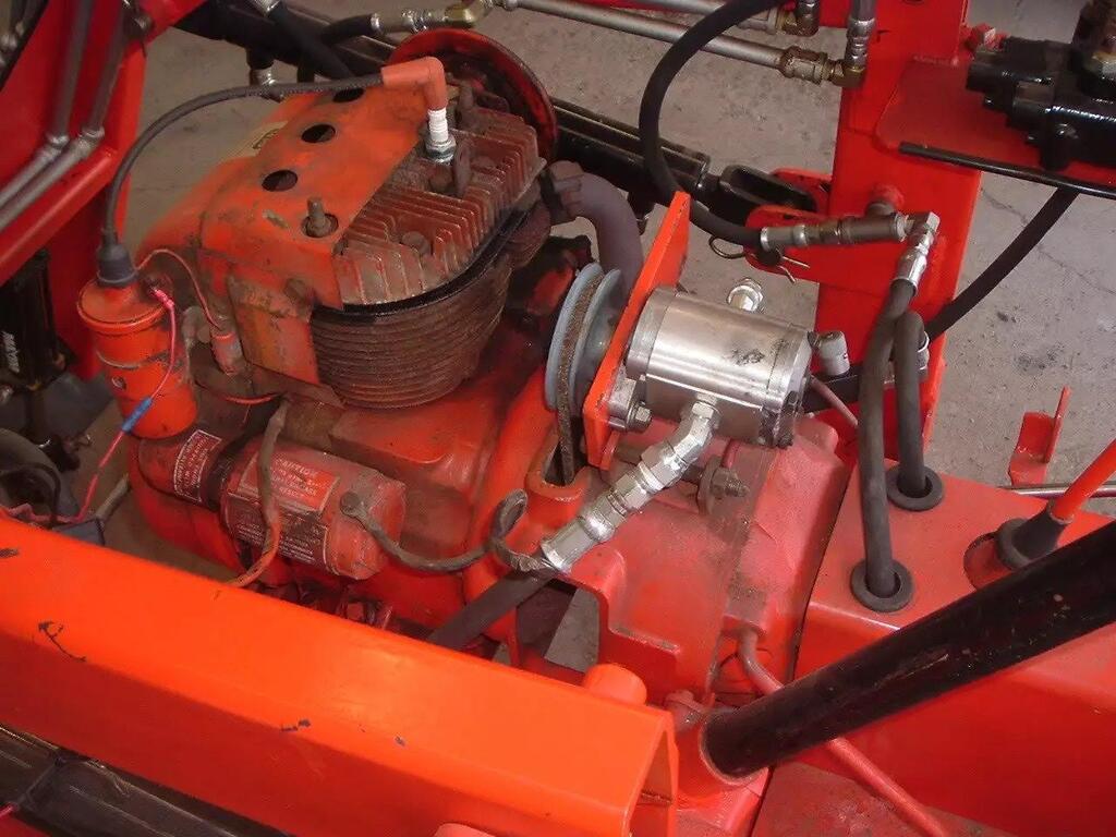

lynnmor 9,051 #15 Posted December 10, 2021 2 minutes ago, gwest_ca said: Make sure to get a pump designed to be belt driven. Shaft driven pumps don't have bearings to take the side thrust. It is difficult to find a belt drive pump, I used this one and mounted it on my sub-frame. 3 Share this post Link to post Share on other sites

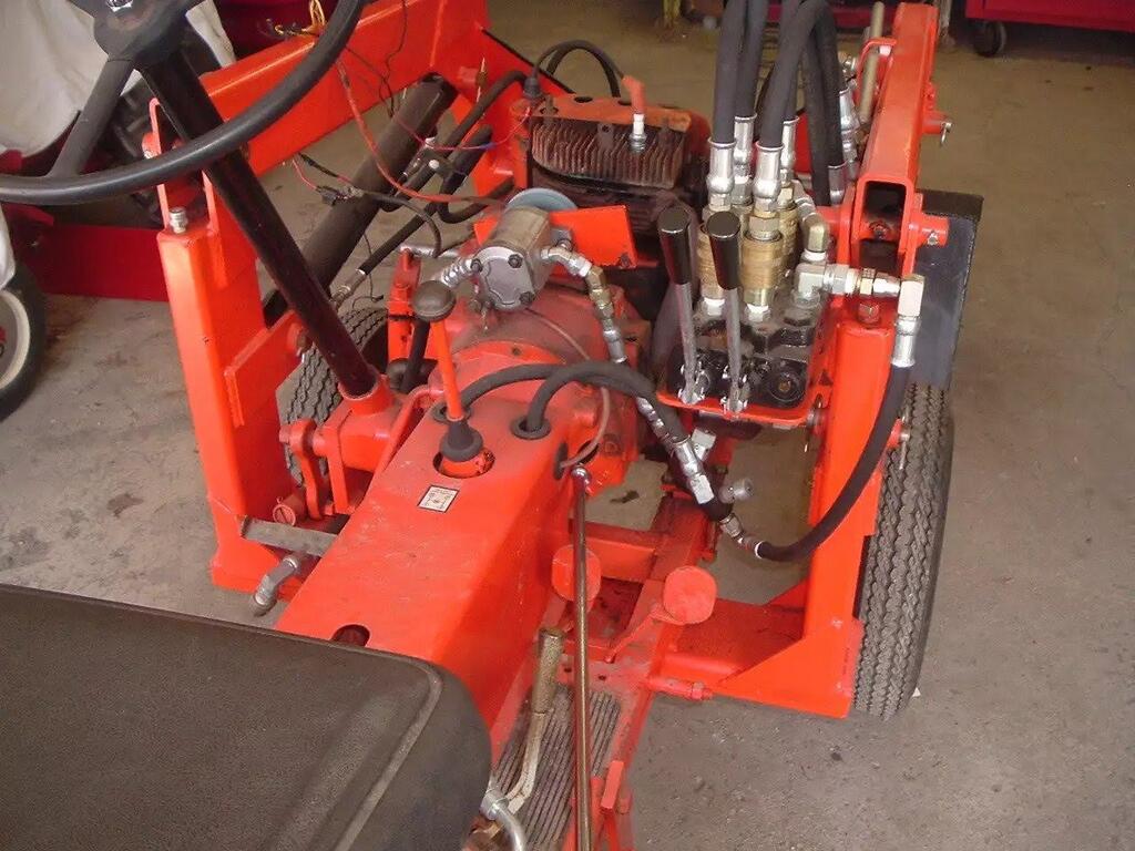

953 nut 69,812 #18 Posted December 10, 2021 My Johnson Workhorse loader has a pump bracket attached to the subframe. 1 Share this post Link to post Share on other sites

PetesPonies1 119 #20 Posted December 11, 2021 11 hours ago, squonk said: .5 Cu In. Pump on my Power King from the Surplus Center. Maybe give you some ideas. Which one did you use from there? It's made for a pulley? Share this post Link to post Share on other sites
