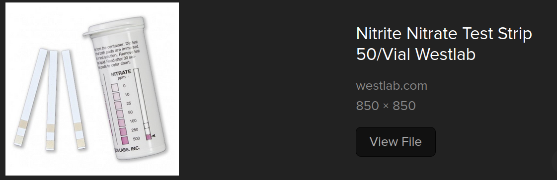

bc.gold 3,406 #24 Posted December 9, 2021 (edited) Fertilizer plant you say, well any place weeds and grass doesn't grow I would expect nitrate contamination. Check with the land registry to see if EPA has registered a environmental infraction against the property, if so was any action taken to remediate the soil. Take soil samples add distilled water, shake vigorously let the fines settle out them test the water with nitrate testing strips. Edited December 9, 2021 by bc.gold Share this post Link to post Share on other sites
wh500special 2,464 #25 Posted December 9, 2021 It's possible to devise ways to do some tests on your own, but there are standards that are followed to make statistical determinations and interpretations of how much of something might be present, how mobile it is, and where it's heading. Certainly if you do a personal test and find something it would be a positive way to decide not to buy the place, but if you don't find anything it isn't really conclusive evidence that there isn't a problem. I would expect the bulk of fertilizers would be inorganic material in the form of various salts. Mixed in could be some interesting organic chemicals if they contained any pesticides or herbicides. Those things might have some solubility in water or be in concentrations that you won't have an appreciable separation on the surface. So the salt test probably won't be applicable here. The nitrate tests would certainly work. As for insurance for something like this, I've not heard of it but it probably doesn't exist. Environmental fees and settlements can be huge sums of money and I doubt insurance companies would want to take the gamble. The clients that would be interested in buying such insurance would also be those who have the greatest probability of needing to cash in a policy, so it's probably not a great business case. Then again, people get paid to put videos of themselves playing video games online, so nothing should surprise us. Steve Share this post Link to post Share on other sites
