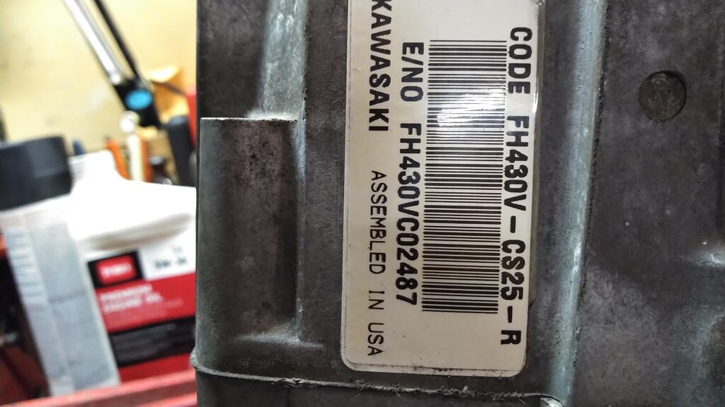

Bill D 3,193 #1 Posted December 5, 2021 I picked up a free Exmark Viking from a neighbor. It has a 15 HP Kawasaki FH430 on it. The top sleeve bearing is shot. This allows the crankshaft to move side to side causing a major leak. Is there a way to remove and replace the bearing without tearing the engine down? It runs great otherwise. Thanks. Bill 1 Share this post Link to post Share on other sites

Bill D 3,193 #8 Posted December 11, 2021 Does anyone have a service manual for the FH430V that I can download? @gwest_ca? Thanks. Bill Share this post Link to post Share on other sites
