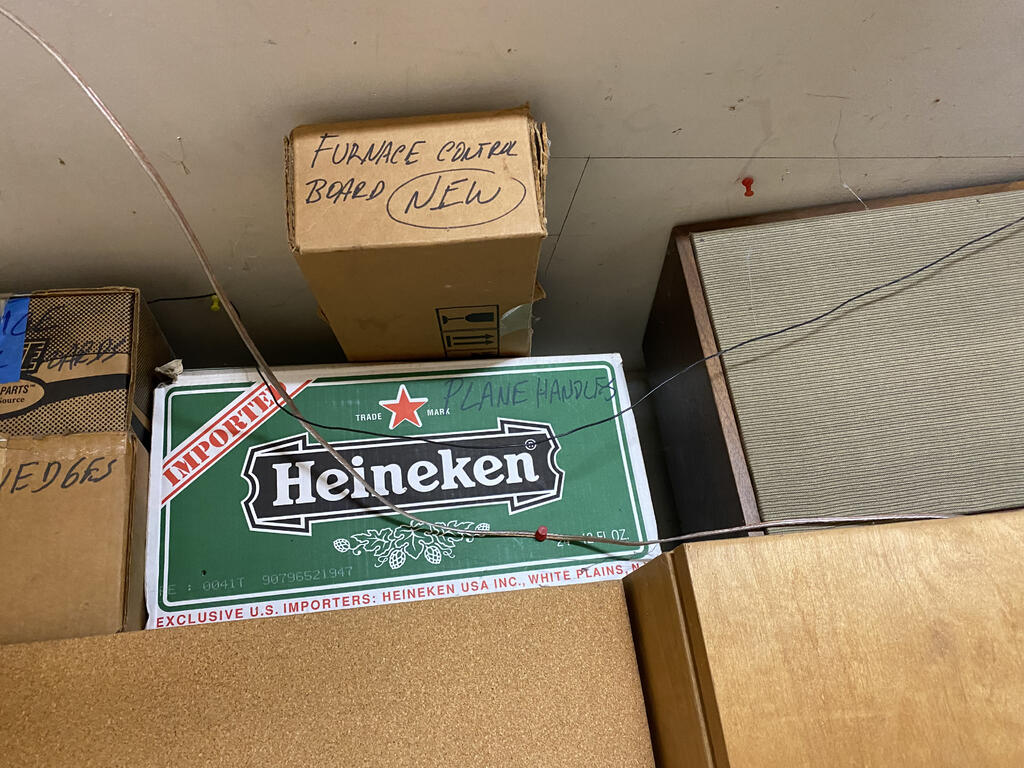

ebinmaine 80,765 #45 Posted December 2, 2021 1 hour ago, formariz said: .I don't own just one of anything. My uncle Ron. My father's brother. He would appreciate you. Ron was some sort of a field engineer in electronics in the Air Force from somewhere around 1960 until the mid 80s. He was and is very particular about the way that he does a lot of things. My father.... Not so much. Love him to pieces. He lives and breathes the Run To Fail way of thinking. Well when my uncle Ron retired from the Air Force father stopped by to visit him one day. And of course he had a nice clean neat well taken care of single story house with a nice clean neat well taken care of two car garage and up on the front wall there was a nearly new Ariens snow blower. Right beside that one was another nearly new Ariens snow blower. This occurrence more than befuddled my father. When questioned, Ron said... Well, if it's important enough to have one of them, it's important enough to have two of them. 2 Share this post Link to post Share on other sites
WHX?? 58,217 #46 Posted December 2, 2021 Reminds me of a guy I installed a furnace for once. He wanted to buy every part for the furnace. Why I asked him, you don't need too I stock every part in case it goes bang in the middle of the night out of warranty. (parts warranties sucked in those days) Well he says he is more relieved or content if he has every part too. He was quite insistent so I sold him every part. Cost him dang near as much as the furnace but he was happy and who am I to argue with a customer? 1 Share this post Link to post Share on other sites
formariz 12,381 #47 Posted December 3, 2021 6 hours ago, WHX?? said: Reminds me of a guy I installed a furnace for once. He wanted to buy every part for the furnace. Why I asked him, you don't need too I stock every part in case it goes bang in the middle of the night out of warranty. (parts warranties sucked in those days) Well he says he is more relieved or content if he has every part too. He was quite insistent so I sold him every part. Cost him dang near as much as the furnace but he was happy and who am I to argue with a customer? Furnace ? Did anyone say furnace? Case and point below. 1 1 Share this post Link to post Share on other sites
Handy Don 17,489 #48 Posted December 3, 2021 25 minutes ago, formariz said: Furnace ? Did anyone say furnace? Case and point below. The water heater manufacturer service rep told me that 99.9% of the calls he gets are for a bad igniter--including my call! So I ordered two and now have a spare handy. (I have a hydronic system--no hot water = no central heat.) Share this post Link to post Share on other sites
formariz 12,381 #49 Posted December 3, 2021 8 minutes ago, Handy Don said: igniter- Igniter? LOL There is actually also an igniter for that furnace inside that box. 1 Share this post Link to post Share on other sites
