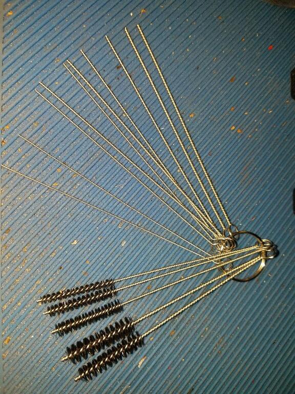

Brockport Bill 2,478 #15 Posted December 1, 2021 I'm new to the carb cleaning and repair or replace world - just a newbie, but i did recentlyorder a carb kit - and inside carton included a set of brushes ( see photo ) - have not used them. However, like others here - thus far I have just used cleaner spray or air - so curious to learn here about the brushes and how and when to use or not use? 2 Share this post Link to post Share on other sites
