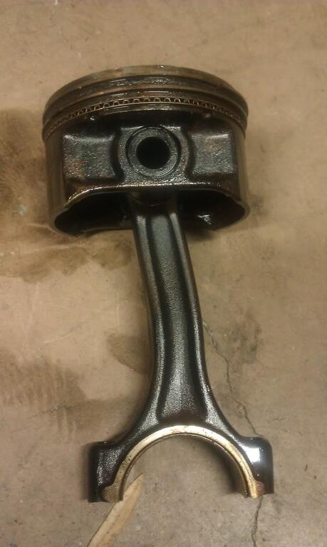

RED-Z06 2,718 #76 Posted December 16, 2021 Cast rods will definitely bend...pulled one out of an L31 5.7...guy blew a head gasket..water doesn't compress but the engine started. Skirt was hitting the crank counterweight. But yeah they'll kink right up. 1 Share this post Link to post Share on other sites
RED-Z06 2,718 #77 Posted December 16, 2021 Here is a bent Powdered Metal LS1 rod Share this post Link to post Share on other sites

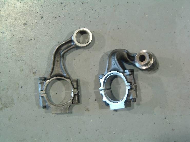

Gregor 4,848 #97 Posted December 29, 2021 (edited) Why don't I see a hole in that rod cap? I dunno, maybe it is there? Edited December 29, 2021 by Gregor 1 Share this post Link to post Share on other sites
slim67 2,825 #98 Posted December 29, 2021 26 minutes ago, Gregor said: Why don't I see a hole in that rod cap? I dunno, maybe it is there? Here you go 2 Share this post Link to post Share on other sites
