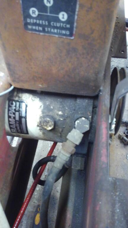

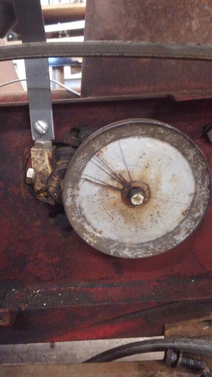

JPWH 6,544 #86 Posted January 5, 2022 I talked to RAM - PAC today and got some interesting information.The man said the hydraulic lift was probably built for a customer some 30 years ago because of the model number and not their typical installation. He said I could send it to them and they would check it out if I wanted. I finished sanding the gen belt guard and installed it. Hydraulic lift pump. 3 1 Share this post Link to post Share on other sites
953 nut 66,350 #87 Posted January 5, 2022 5 minutes ago, JPWH said: He said I could send it to them and they would check it out if I wanted. Lowell can fix you up with all the parts you'll need. https://wheelhorsepartsandmore.com/product-category/hydraulics/page/3/ Your pump and cylinder should be the same as the HY-2. 2 Share this post Link to post Share on other sites
JPWH 6,544 #88 Posted January 5, 2022 Dick, @953 nutI talked with Lowell as well. He said he makes his springs so he may be able to make one for me if I had enough of the broken one to go by, but he was not familiar with Ram Pac. The man I talked to with Ram Pac did not know if there should be a spring or not. I'm going to have to take it off the tractor and take it apart or send it to Lowell to pursue this any further. 2 Share this post Link to post Share on other sites
19richie66 17,888 #89 Posted January 5, 2022 If Karen’s had come with a pump, I would send it to you but it was absent from the parts mix. 1 1 Share this post Link to post Share on other sites
JPWH 6,544 #90 Posted January 5, 2022 (edited) 26 minutes ago, 19richie66 said: If Karen’s had come with a pump, I would send it to you but it was absent from the parts mix. @19richie66There is nothing wrong with the pump Richie. It works great! It's just the question if it's supposed to spring back to neutral. Ram Pac says they don't think so but I'm curious. Jay Edited January 5, 2022 by JPWH 1 Share this post Link to post Share on other sites

WHX?? 56,694 #93 Posted January 5, 2022 2 hours ago, JPWH said: supposed to spring back to neutral. Ram Pac says they don't think so but I'm curious. If not Hank can you install opposing springs somehow on the lever to bring it back to neutral? Just thinkin out loud here. 3 1 Share this post Link to post Share on other sites
WHX?? 56,694 #94 Posted January 5, 2022 5 minutes ago, Achto said: @WHX?? I forget, does either one of those have a Ross box on it? Yes ... both do....one is quite warbly but most likely can be saved with Cub box parts. Jay's work has got me jonesin to get the 701 & RE-67 done & out the shop and some 953s in! 2 1 Share this post Link to post Share on other sites
JPWH 6,544 #95 Posted January 5, 2022 17 minutes ago, WHX?? said: If not Hank can you install opposing springs somehow on the lever to bring it back to neutral? Just thinkin out loud here. @WHX?? I don't think this pump works that way. I'll have to get it all put back together to know for sure. That is an option though. I have the lift cable installed now so I'll hang something on it and check it out. 2 Share this post Link to post Share on other sites

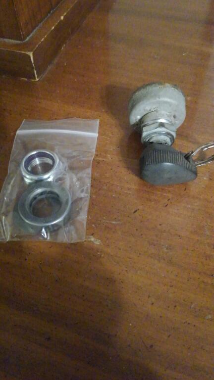

JPWH 6,544 #96 Posted January 5, 2022 I'm anxious to get this one finished like I want it and start using it. I received the u bolts for the grille today, now I'm waiting on one more part for the Ross steering box, it's supposed to be an upgrade bearing. We'll see. Should get it tomorrow. Jay 1 Share this post Link to post Share on other sites
WHX?? 56,694 #97 Posted January 5, 2022 What was your source on the box parts Hank? 1 Share this post Link to post Share on other sites
JPWH 6,544 #98 Posted January 5, 2022 (edited) 52 minutes ago, WHX?? said: What was your source on the box parts Hank? Flea bay. Hamiltonbobscubs for the bearings and iplumb for the gaskets. The gaskets are not an exact match but will work Now I know what the material is I will make my own in the future. I still have a set of bearings and a gasket. I did not need the bearings. I had ordered 2 gaskets. For the top bearing I used a wheel needle bearing. Edited January 5, 2022 by JPWH 1 1 1 Share this post Link to post Share on other sites
JPWH 6,544 #99 Posted January 8, 2022 I finally got the bearing, also got an original key switch from A-Z. 3 Share this post Link to post Share on other sites
WHX?? 56,694 #100 Posted January 8, 2022 Sawweet Hank ..... those keys with the big fob are hens teeth and I believe they may have been original at one time on different years. Have one on a 857. 2 Share this post Link to post Share on other sites
