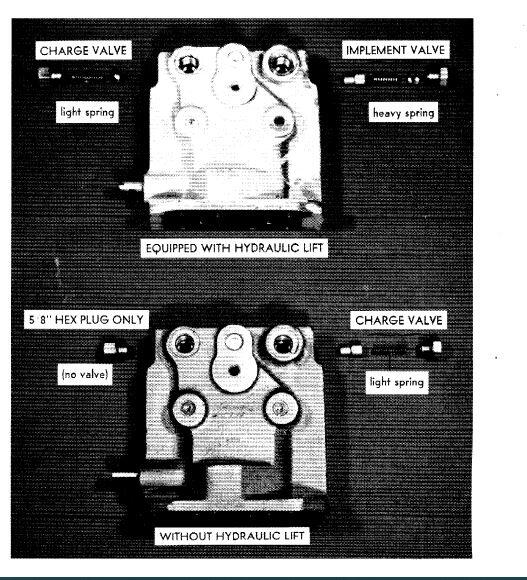

Handy Don 17,562 #5 Posted November 28, 2021 There is a pressure relief valve in the Sunstrand that lets the fluid bypass the lift circuit (intentional to protect the pump when a cylinder reaches end of travel while the control valve is still in "raise" or "lower" position). I'd bet that its seal or spring is damaged or something is stuck in it. Share this post Link to post Share on other sites
Jon925mn 39 #6 Posted November 28, 2021 Tractor does drive forward and reverse. It is somewhat touchy or bit jerky when pushing lever but not terrible. Reverse seems a little slow but not bad. I have 200lbs weight on back bracket and she goes up a hill. Where is this pressure relief valve in the Sunstrand ? Servicable? Share this post Link to post Share on other sites
pfrederi 21,222 #7 Posted November 28, 2021 32 minutes ago, Jon925mn said: Tractor does drive forward and reverse. It is somewhat touchy or bit jerky when pushing lever but not terrible. Reverse seems a little slow but not bad. I have 200lbs weight on back bracket and she goes up a hill. Where is this pressure relief valve in the Sunstrand ? Servicable? Yes...it is serviceable. You need to look at the sunstrand manual You have a piston to piston so the relief valve setups are specific to them (not the older hydrogears) 1 1 Share this post Link to post Share on other sites

Jon925mn 39 #9 Posted November 29, 2021 Can't seem to open file after download so can someone send a picture of which bolt is the service valve. Thanks Share this post Link to post Share on other sites

pfrederi 21,222 #11 Posted November 29, 2021 Cylinder should work all the way in and out with hoses off.... Try downloading this version. You really need it when you tear into these things.. Implement pressure test may be enlightening also Share this post Link to post Share on other sites
