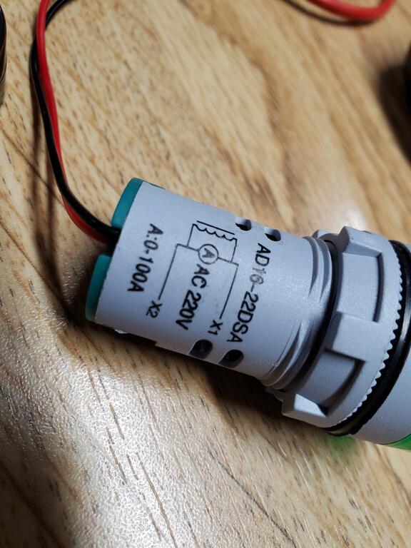

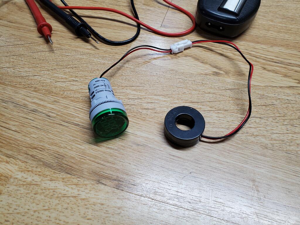

Racinbob 13,200 #1 Posted November 28, 2021 (edited) OK guys, I must be near total brain deadness. I picked up a couple of these ammeters for another little addition to my emergency power setup. Easy peasy right? Power to X1 and X2 (it shows 220v but it can be 110v as well.) CT around conductor and it's good to go. So I thunk. Both displays work fine when powered. But I'm not reading any current flow on a circuit that shows a load with my clamp-on. Zero, zip, nada. I tried every combination of the meters and CT's. Checked the CT's and they both read good. Checked continuity through the connectors. Contemplated throwing them across the room but managed to control myself. Anybody used these? Come on guys, feel free to embarrass a guy with over 50 years of electrical experience. Edited November 28, 2021 by Racinbob 1 Share this post Link to post Share on other sites

Jeff-C175 7,211 #6 Posted November 28, 2021 (edited) This is kinda funny... "Zero Line" and "FireWire" ... But it makes me wonder... you are running the HOT through the core? Not the Neutral? Depending on the design, it MIGHT make a difference. "Y'all needs ta put moe FAHR in yer WAHR, TAIN FOAH ?" Edited November 28, 2021 by Jeff-C175 Share this post Link to post Share on other sites

Racinbob 13,200 #8 Posted November 28, 2021 35 minutes ago, squonk said: What ever is is, it's gotta be somethin stupid! You're trying to measure off the the circuit powering the meter itself correct? I thought about that Mike. At first I wasn't because it shouldn't matter. But I went ahead and tried it with the power feeding the display. Nothing. Share this post Link to post Share on other sites

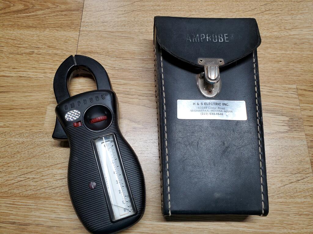

Racinbob 13,200 #10 Posted November 28, 2021 42 minutes ago, Jeff-C175 said: You were specific enough, I'm just a little foggy this morning. (what? it's not morning anymore? ) I'm sure you hooked 'em up correct, probably just ... well ... 'junk' from the country of China ... You know that you can 'multiply the reading by looping the wire through the core multiple times? Not that it's gonna help if it doesn't work at all, but how much current are you actually seeing on the Amprobe? Maybe it's too low to register on that simple little doo-dad? The ammeters are supposed to reads tenths. I had about 1.5 amps with the Amprobe clamp-on. Share this post Link to post Share on other sites

Racinbob 13,200 #12 Posted November 28, 2021 Just for giggles I just checked the furnace circuit. 5.5 amps. I'll go ahead and slip a CT on that circuit and see what happens. 2 Share this post Link to post Share on other sites
Racinbob 13,200 #13 Posted November 28, 2021 Problem solved. Jeff, you said it first. 1.5-2 amps just doesn't register. Funny that a 40 year old Amprobe clamp-on reads it but the new fangled crap doesn't. Once I had a CT on the furnace circuit it read it and I could even watch it ramp down as it went into the shut down sequence. At least now I know. There's another style that I'm going to try. They are SUPPOSED to read voltage, current and frequency. What the heck. It's fun playing. 4 Share this post Link to post Share on other sites

Jeff-C175 7,211 #15 Posted November 28, 2021 (edited) 3 hours ago, Racinbob said: 1.5-2 amps just doesn't register Quote 40 year old Amprobe Analog display on that one? At the company I just retired from we had ammeters on the equipment we manufactured. They were driven by microprocessors that had an ADC reading the DC shunt and passing it on to the uP to send to the display. There were complaints from customers that the current display was 'jumping' around when there was zero output from the device. It was 'noise' that the ADC was picking up, from whatever... lighting, nearby motors, radio stations, whatever... The software team had to modify the firmware to cut the display off below a certain threshold. AIRC it was about 2% of full scale. I'll bet that's what's going on with those devices! It's all about "signal to noise ratio". Edited November 28, 2021 by Jeff-C175 1 Share this post Link to post Share on other sites
Racinbob 13,200 #16 Posted November 29, 2021 14 hours ago, Jeff-C175 said: Analog display on that one? At the company I just retired from we had ammeters on the equipment we manufactured. They were driven by microprocessors that had an ADC reading the DC shunt and passing it on to the uP to send to the display. There were complaints from customers that the current display was 'jumping' around when there was zero output from the device. It was 'noise' that the ADC was picking up, from whatever... lighting, nearby motors, radio stations, whatever... The software team had to modify the firmware to cut the display off below a certain threshold. AIRC it was about 2% of full scale. I'll bet that's what's going on with those devices! It's all about "signal to noise ratio". Analog it is Jeff. Good old trusty Amprobe purchased in the 80's. I'm thinking you could drive nails with it too. I seriously doubt the Chinese went through the trouble with these things. They are just cheap, cheap. I'm going to get a couple more in a different style. I may not be able to them with a frequency readout because I won't buy from a seller shipping from China. Thinking about it I don't think not starting to read until 3 amps or so. That's no more than 400 watts per leg and I'm sure I'll exceed that. As we all were typing in this thread yesterday the seller replied to the message I had sent him. He really had nothing more to add but at least he responded. That's more than most do. 1 Share this post Link to post Share on other sites
