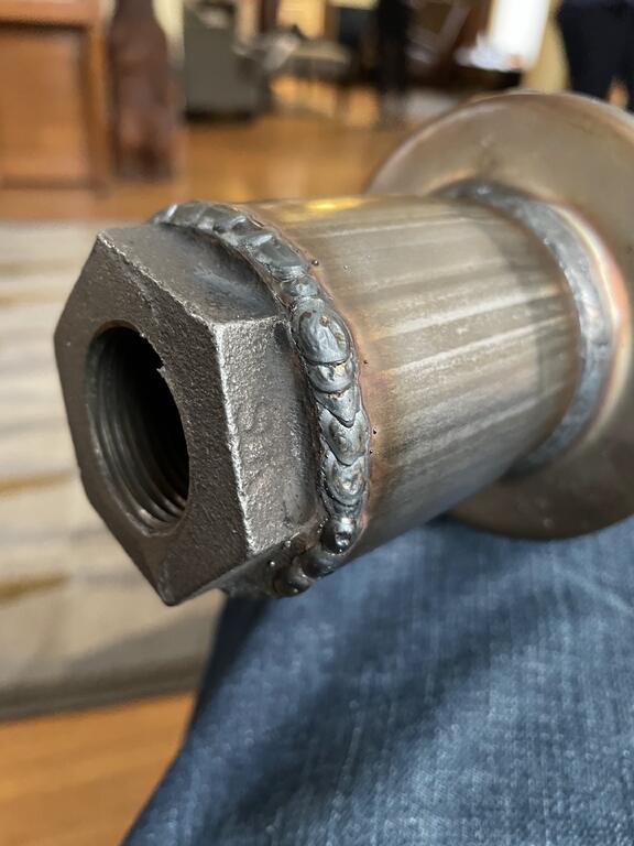

ebinmaine 81,116 #26 Posted December 30, 2021 54 minutes ago, sjoemie himself said: That looks awesome. About the mating of the muffler to the pipefitting, looks like a job for a welding machine.. Another option is to cut two opposing slits in the pipe of the muffler and then use a exhaust clamp to clamp the muffler to the pipe fitting. Agreed on the look. I like it. You could also get an expander or have an exhaust shop do an expansion on the muffler inlet. A nice neat clean mig weld would really be the way to go if possible. Share this post Link to post Share on other sites
Redav72 231 #27 Posted December 30, 2021 I took the muffler and the bushing down to my local muffler/brake shop and for 20$ they expanded and then welded the two together. Pretty pleased and it sounds really nice. The next two thing I need to do is put an extender with a side outlet so that the exhaust isn't directly in my face, before I do that though I'd worried about weight and so I'd like to put a little band iron strut underneath. Will post more pictures once I've got both done. 4 1 Share this post Link to post Share on other sites
ebinmaine 81,116 #28 Posted December 30, 2021 41 minutes ago, Redav72 said: took the muffler and the bushing down to my local muffler/brake shop and for 20$ they expanded and then welded the two together. Pretty pleased and it sounds really nice Niiiiice!! I have a support for the talk stack on my Cinnamon Horse C160. I bent a piece of steel strapping to run from the bottom clamp at the base of the muffler down to the frame. Seems to be holding up well. 1 Share this post Link to post Share on other sites
sjoemie himself 3,268 #29 Posted December 30, 2021 Looking good. And like @ebinmaine said this is probably the best and safest way to go. That ain't going nowhere 1 Share this post Link to post Share on other sites

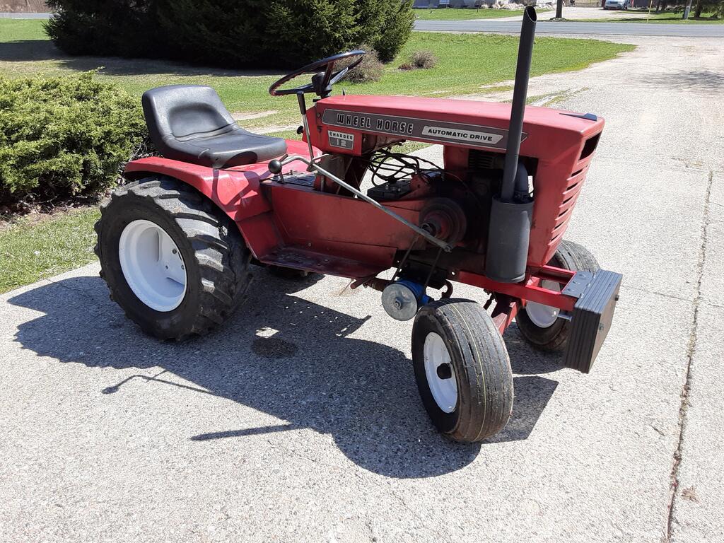

Roger R 473 #30 Posted December 31, 2021 Hard to beat the Chargers. This muffler is a Simplicity, entrance and exit on the same end. 1 1 Share this post Link to post Share on other sites
Redav72 231 #31 Posted December 31, 2021 Looks good there @Roger R. I like the look of the weights in the front, is that largely aesthetic or does it help? I suppose it'd have to come off for plowing. Share this post Link to post Share on other sites
Roger R 473 #32 Posted December 31, 2021 1 minute ago, Redav72 said: Looks good there @Roger R. I like the look of the weights in the front, is that largely aesthetic or does it help? I suppose it'd have to come off for plowing. Yes, if I used it for plowing they would need to come off. (I have a dedicated blower tractor) However they just about eliminate under steer. I use it for lawn rolling and a pull type sprayer where maneuverability is definitely a plus. Share this post Link to post Share on other sites
Redav72 231 #33 Posted December 31, 2021 Thanks, what tires are you using there? Share this post Link to post Share on other sites
Roger R 473 #34 Posted December 31, 2021 10 minutes ago, Redav72 said: Thanks, what tires are you using there? 23-10.50-12 rears, 16-6.50-8 front. Share this post Link to post Share on other sites

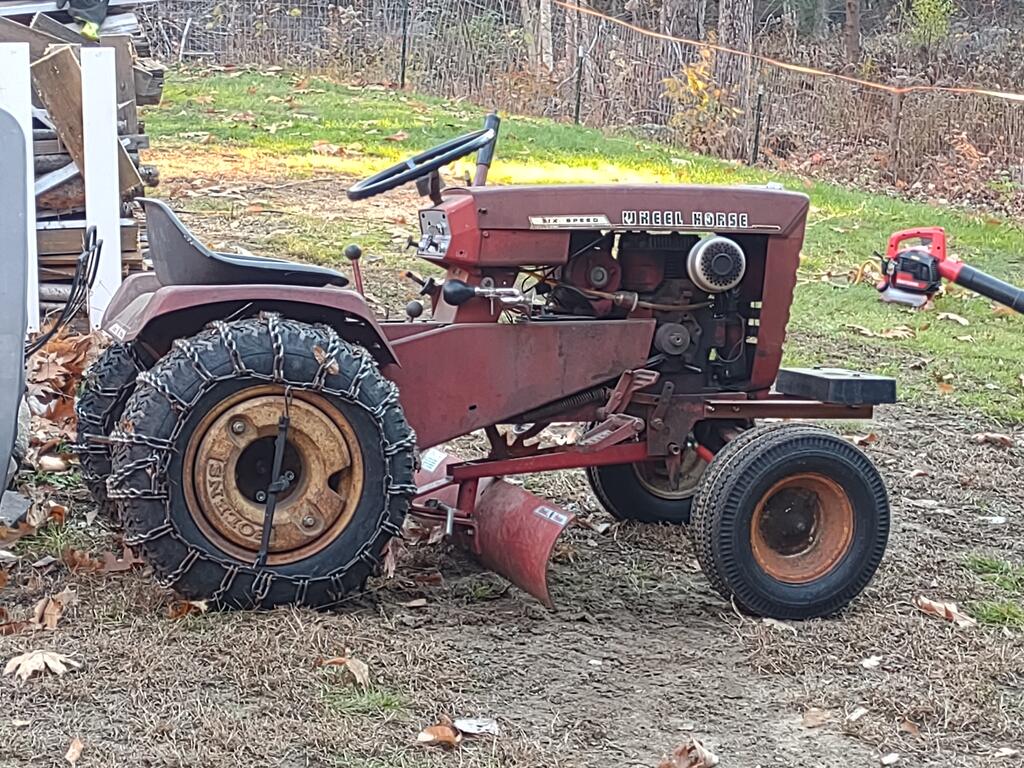

ebinmaine 81,116 #35 Posted December 31, 2021 @Redav72 Speaking of front weights here's a pic of Trina's 867. Similar tractor but short frame small block. Lack of steering for her is a constant because we use the tractors in the woods and leaves are nearly as slippery as snow. Her weight is a bracket of simple angle iron and a rectangle of steel that's about 45 lb. The front tires have roller chain installed. Huge help. 2 Share this post Link to post Share on other sites
953 nut 70,254 #36 Posted December 31, 2021 16 hours ago, Redav72 said: I'd worried about weight and so I'd like to put a little band iron strut underneath. If you get a 1" X 1/2" X 1" black Iron Tee in place of the 90 (1/2" facing down). Pick up a 1/2" plug you can drill and tap the plug for a bolt, bolt the band iron to the bottom of the plug and will have a clean appearing sturdy brace. 1 Share this post Link to post Share on other sites
Redav72 231 #37 Posted January 1, 2022 Like that idea. I might extend it a bit and use a split-ring hanger since it's already got the threads. https://www.amazon.com/gp/product/B0078S1JK2/ref=ppx_yo_dt_b_asin_title_o00_s00?ie=UTF8&psc=1 2 Share this post Link to post Share on other sites

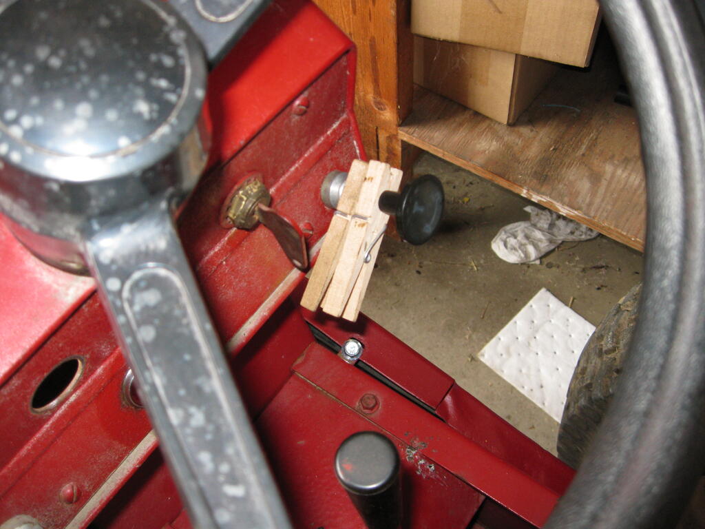

pfrederi 21,288 #40 Posted January 1, 2022 You can buy a new one for some $$ or do what I do... 1 clothes pin fast idle 2 full throttle... 3 3 1 2 Share this post Link to post Share on other sites
rjg854 13,419 #41 Posted January 1, 2022 9 hours ago, pfrederi said: 1 clothes pin fast idle 2 full throttle... I appreciate the technical lengths you've gone thru to correct that problem. 6 Share this post Link to post Share on other sites
SylvanLakeWH 32,822 #42 Posted January 1, 2022 11 hours ago, pfrederi said: You can buy a new one for some $$ or do what I do... 1 clothes pin fast idle 2 full throttle... 1 hour ago, rjg854 said: I appreciate the technical lengths you've gone thru to correct that problem. Agree. Excellent use of advanced technology… But I think they should be painted either Regal Red or satin black. I mean, there are standards that should be met… 4 Share this post Link to post Share on other sites
