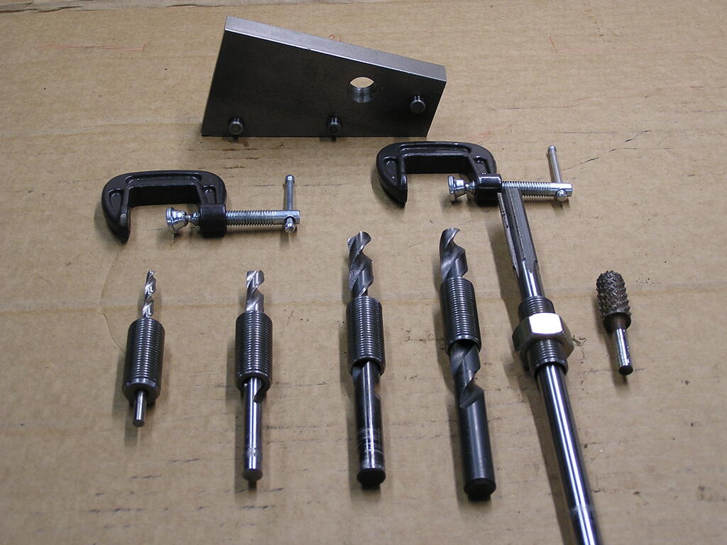

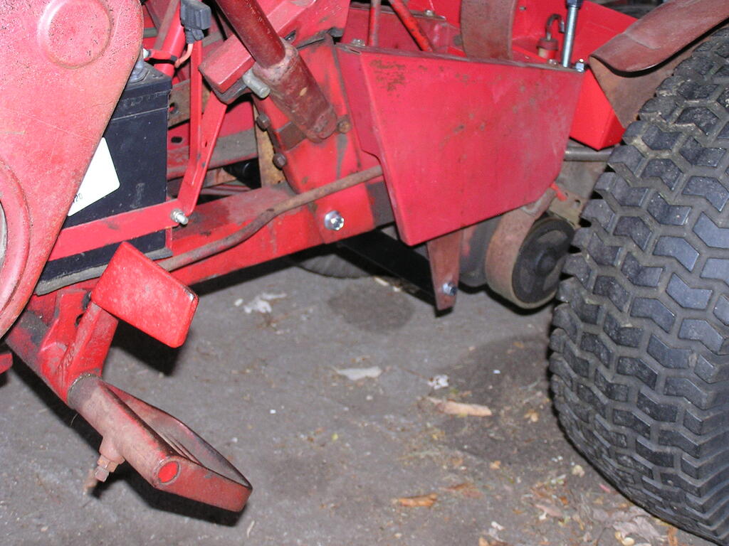

ri702bill 11,140 #1 Posted November 28, 2021 I wanted to install the lower frame brace on the 854 8 speed, but to my surprise there were no 1/2" holes on the sides of the frame plate. (we used to call that "material safe" at work) I made up a clamp on plate jig with replacable threaded inserts that would accurately locate the holes, as my design actually pilots inside those holes. I used a known good 702 frame for the dimensions - the 3 dowels protrude on both sides for left and right side use. Braces are now installed. 2 11 Share this post Link to post Share on other sites

ri702bill 11,140 #4 Posted November 28, 2021 Thanks guys. I was originally going to machine the block to leave 2 raised flats on each - WAY too much work. A little math to deduct half of the .3125 dowels and knocked it all out in the milling machine, including all the insert thru holes. All told, about a 3 beer job. (My son's godfather rated the difficulty of all automotive repairs that way - 2 beers for replacing rotors and pads, 4 beers to change a water pump, etc.) Bill 1 1 1 Share this post Link to post Share on other sites

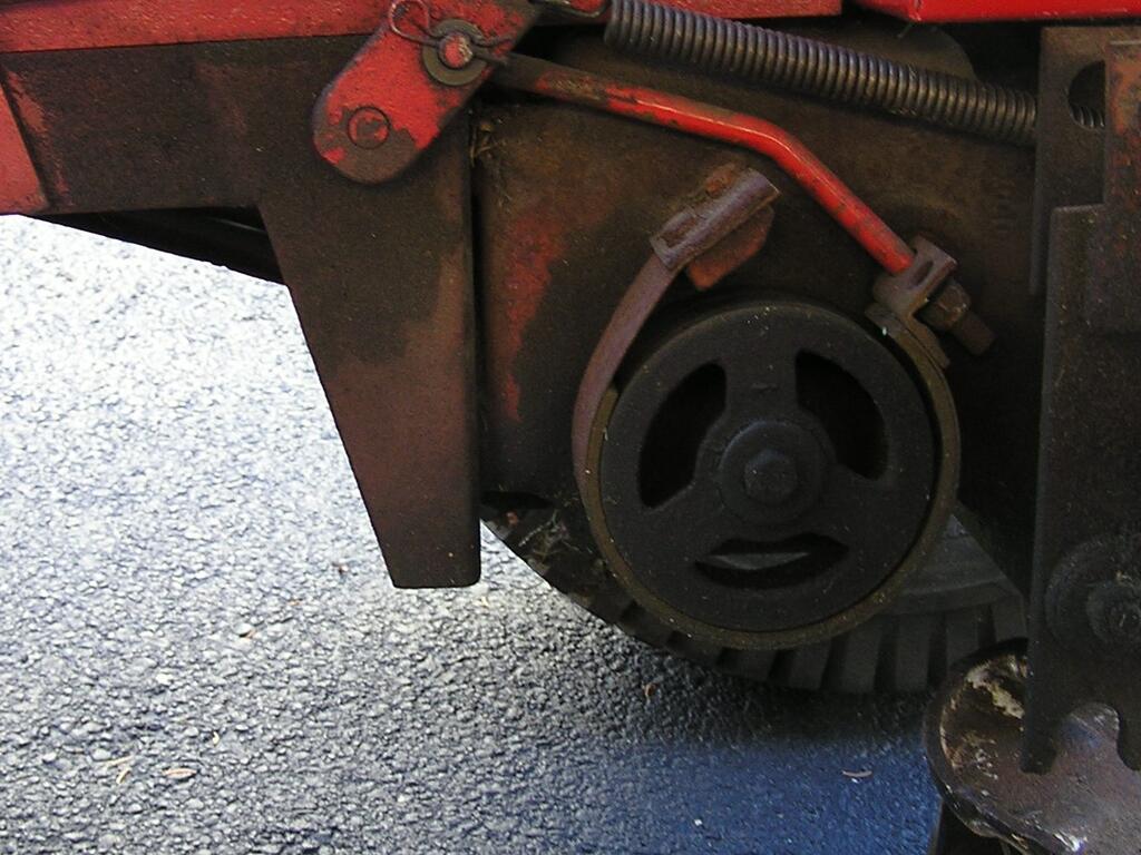

peter lena 9,709 #8 Posted November 28, 2021 @ri702bill terrific work on that ! how dare you go outside the norm ? just joking , a glairing thing to me is your drive belt upper idler pulley , prone to noise an failure , have a local BEARING DISTRIBUTOR IN YOUR AREA ? they probably have a duplicate flat idler with a 5/8 or 3/4 , wide rubber side shield bearing , that can easily be improved with a clean out and re grease to lucas xtra heavy duty , add a 3/8 x 5/8 or 3/8 x 3/4 bronze bushing , remount , tell me how that works , solid , bombproof , on my stuff , pete Share this post Link to post Share on other sites
ri702bill 11,140 #9 Posted November 28, 2021 @peter lena I did just that with the C81 - no regrets. I still have a couple of these originals that are servicable awaiting the call. Yup, outside the norm - welded in frame reinforcing plate and 2 frame braces - this is a "Working Girl" - will see either plow or snowthrower duty really soon. Just love it with the 8 speed. 1 Share this post Link to post Share on other sites

Maxwell-8 4,370 #12 Posted November 28, 2021 That is a great and easy way to support that bracket. No welding required! Thanks for the idea, I will most luckily use this as well on my C141D. Share this post Link to post Share on other sites
