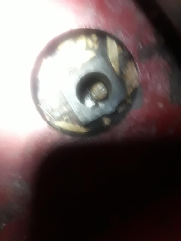

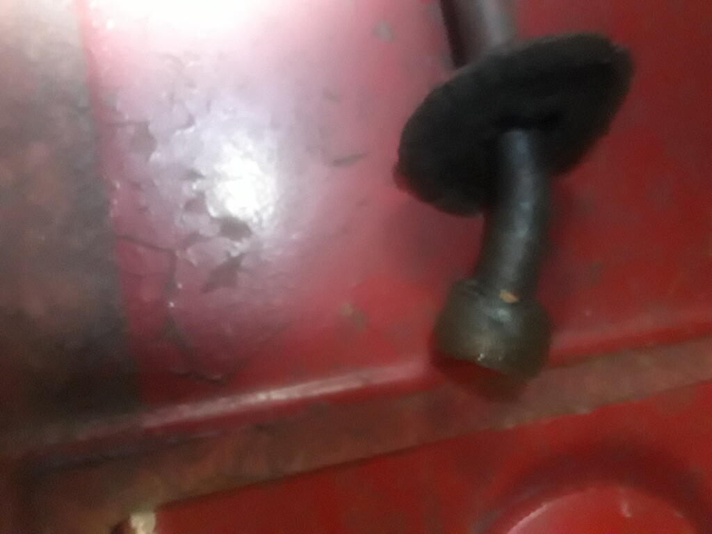

Gm2021 5 #1 Posted November 28, 2021 Apologies to moderator..posted under wheel horse n not this section..just got a 633 with shift lever taped to steering wheel n in stuck in gear..is this an easy fix or just replace tranny..thanks for any help given 1 Share this post Link to post Share on other sites

953 nut 62,714 #4 Posted November 28, 2021 Is there enough of the stub to grab with a pair of needle nose vise grips? 1 1 Share this post Link to post Share on other sites
wallfish 18,715 #5 Posted November 28, 2021 Pinch it with the pliers and remove the set screw in the front and pull it out. 1 1 Share this post Link to post Share on other sites

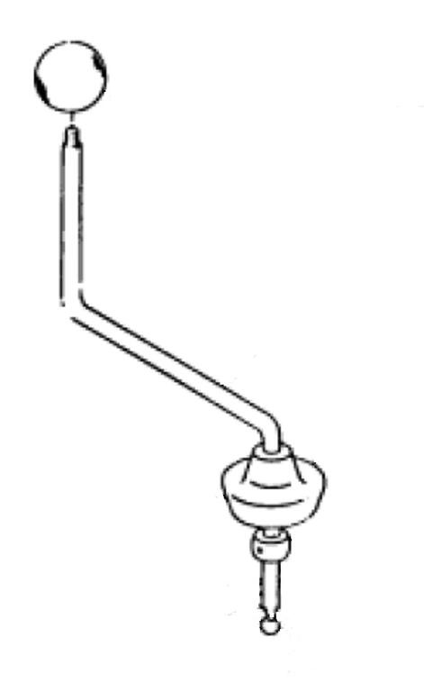

gwest_ca-(File Mod) 11,800 #6 Posted November 28, 2021 Probably help if you knew what the rest of it looks like. There is a ball machined into the end of it. 3 Share this post Link to post Share on other sites

ebinmaine 75,226 #8 Posted November 28, 2021 1 hour ago, Handy Don said: the ball and more That's the round piece you can see in the transmission hole. 1 hour ago, Handy Don said: what care must be taken Remove and split the transmission to check, clean, and repair whatever is damaged. ALL gaskets, bearings and seals are available from Lowell at Wheelhorse Parts and More. Other things are readily available used. 1 Share this post Link to post Share on other sites

stevasaurus 23,506 #10 Posted November 28, 2021 Like Wallfish said, remove the set screw. Then take a long, skinny screwdriver and try to pry the shift fork toward where the broken piece is...this should also put you into neutral. That will create enough slack that the piece will either slip in or make it so you can grab it a pull it out. If it slips in, a pencil magnet should be able to grab it. A - Z Tractors should have a used shifter that you can buy. Here is a thread with videos that will show you what it is like inside. Share this post Link to post Share on other sites
