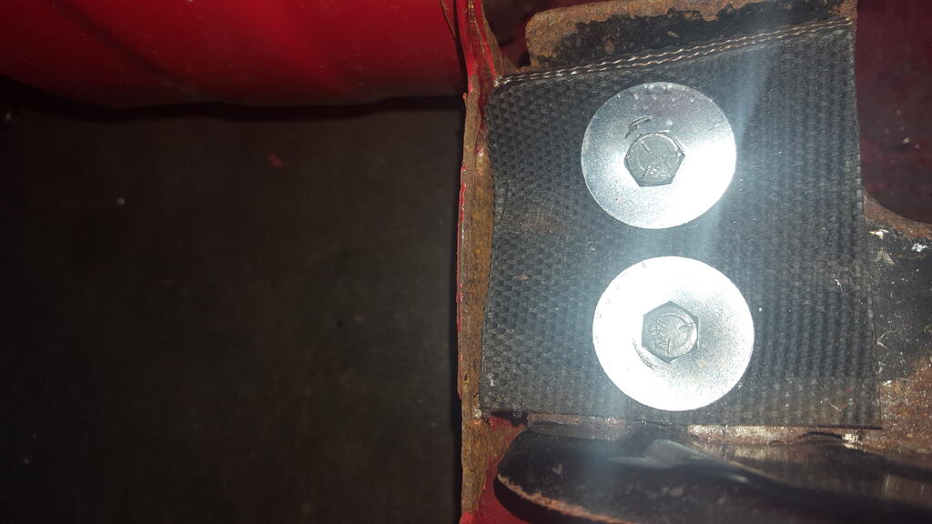

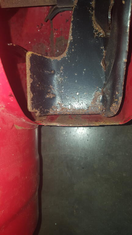

Gregor 4,847 #1 Posted November 26, 2021 Anyone else ever done this? I have read about it several times, and thought I would try it. This is a 2 stage, self propelled, walk behind snow blower. There is about a 3/8" gap between the paddle and the housing. I added a piece of 3"x3"x1/4" belting to make it a snugger fit. It actually rubs a bit in places, but I figure it will wear itself down pretty quickly. It suppose to dramatically improves performance. 4 Share this post Link to post Share on other sites

peter lena 9,459 #4 Posted November 26, 2021 @Gregor have a walk behind blower 23 years , did that mod a couple of years ago , used conveyor belt material , used fender washers , like you did , used 1/4" s/s bolts and elastic lock nuts , no problems and definitely helped with sloppy snow , dry snow was also much better , also sprayed the inner chute with sno go , made for no snow build up . pete 2 Share this post Link to post Share on other sites

Jeff-C175 7,206 #6 Posted November 27, 2021 (edited) I did it to my Craftsman last year. Cut up the old front tires from my Horse. Holes already in the impeller, didn't have to drill. Made a HUGE positive difference! BUT... the second time that I used it last year the impeller shear pins broke. Maybe it was a coincidence, but just thought I'd mention it as a possible down side. Seems to me that the extra load on the impeller could have caused those shear pins to fail. I didn't hit anything, just moving some slushy snow is all. edit: Thought I would add this clarification: NOT the AUGER shear pins, those I break maybe once a year. These were the 1/4" roll pins that stake the IMPELLER to the shaft. I've never broken those before! Edited November 27, 2021 by Jeff-C175 1 Share this post Link to post Share on other sites
roadapples 6,985 #7 Posted November 27, 2021 Yup, I also cut a front tire and used the sidewall on my 2stage a few years ago. Big improvement, especially on slushy stuff. Tried to get all three as near the same as I could so not to get out of balance. Adjust so they just touch. They'll make a perfect fit. Share this post Link to post Share on other sites
